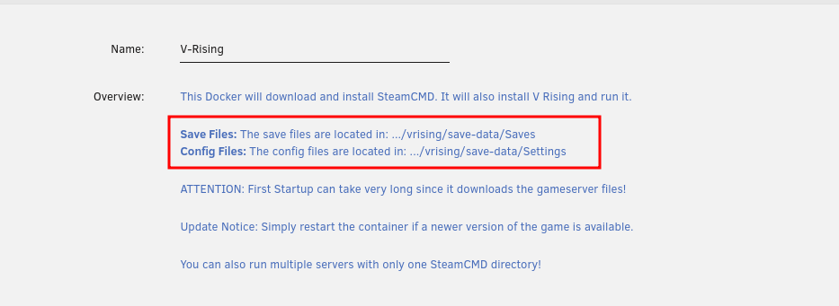

1 hour ago, sickntired said:
I also noticed I was not able to choose anything like if it is a PvE server or PvP or any other server adjustment before launching the server?
  1. Stop the container
  2. Navigate to: .../vrising/save-data/Settings
    Also pointed out here:
  3. Edit the files to your likings and save the changes
  4. Start the container

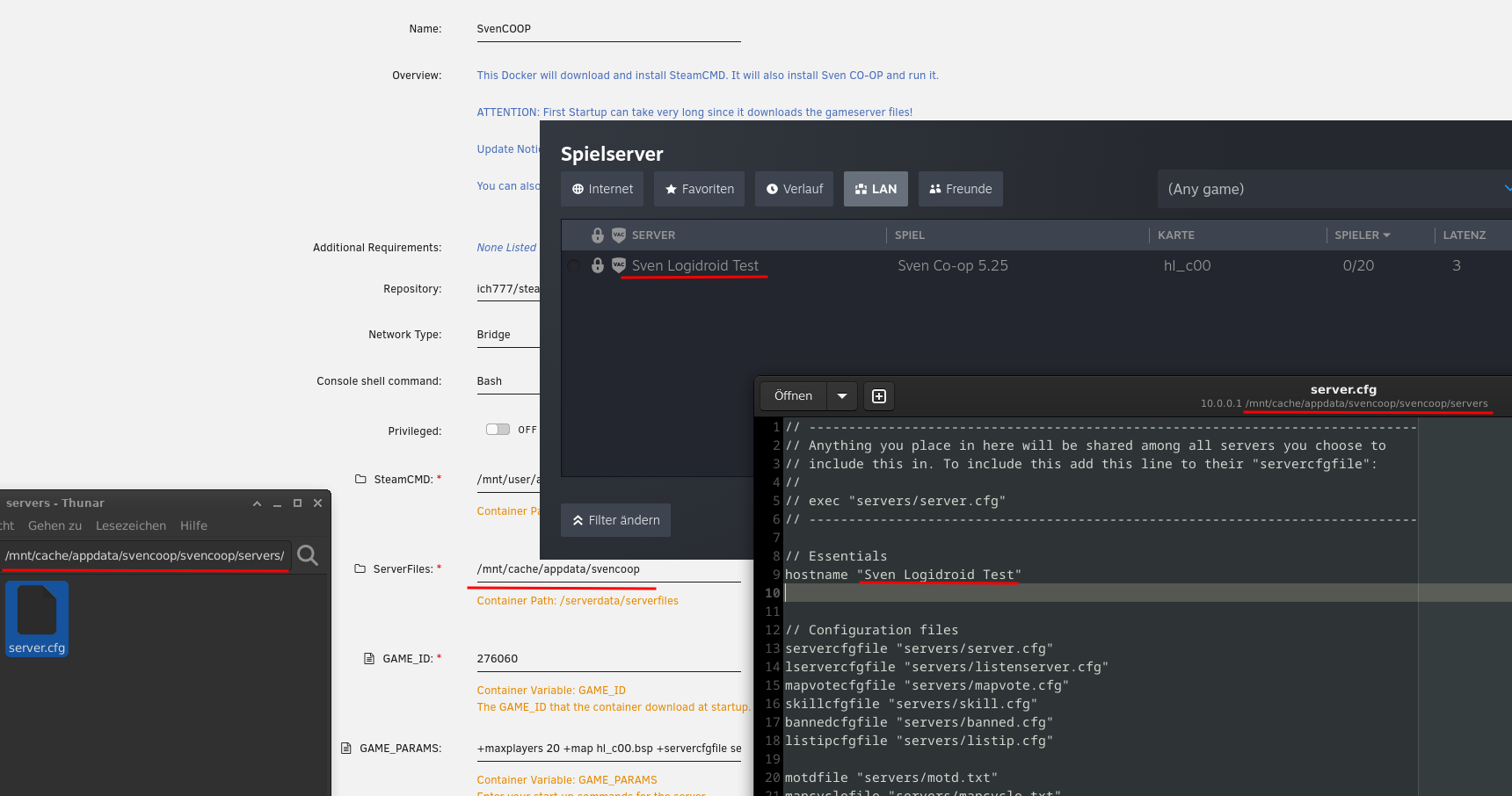

On 5/7/2024 at 10:13 PM, ich777 said:
You don't have to access /mnt/cache/... you have to fix how things are working on your server.
Please read my comment from above again...
Make sure that your appdata share stays on the cache in the Share settings from your appdata share and are not moved over to the Array, that's it.
as you can see I modify the correct server.cfg but that still does not correct the problem and even if I leave it by default the name has never been Docker Co-Opimage.png.825a4c5985c414ca2a2be8cd9543c60b.png
Edited by Logidroid
Sorry but I really can't replicate that over here:
I even made a funny test:
...and everything is working fine over here.
Can you please try to delete the container, then delete the svencoop folder which lives in your appdata directory (please check both /mnt/user/appdata/ and /mnt/cache/appdata) <- my suspicion is that you have files in both directories and that's why it gets confused.
during installation and at the first start, the server folder must be created in : /mnt/user/appdata/ and /mnt/cache/appdata...
This happens even after a simple restart just after deleting the folder located in : /mnt/user/appdata/

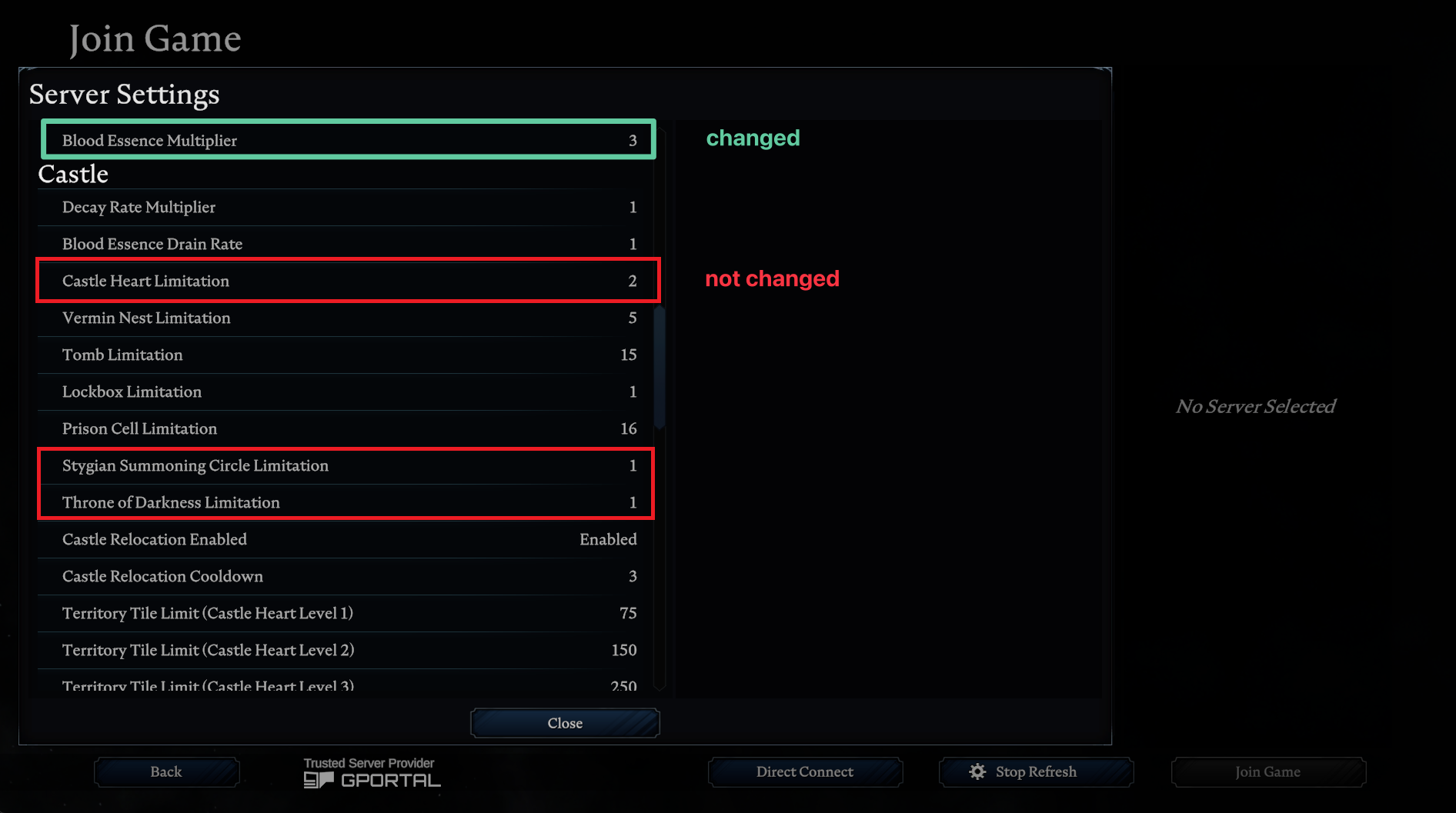

Is BepInEx safe to run with the VRising docker now that it's been updated for v1.0?
I tried just a manual install and enabling the setting, but I keep getting stuck in server start loops and thought I'd ask.
Please describe a bit more in depth what you are trying to do and what you are changing where please.
The actual save data is located in .../vrising/save-data/... and not in .../vrising/VRisingServer_Data/StreamingAssets/...
So basically, if you change any of the3 settings mentioned in .../vrising/save-data/..., they don't work (it will remain as the default). All other settings can be changed just fine. For example, changing the following settings:
	"BloodEssenceYieldModifier": 3.0,
	"CastleStatModifiers_Global": {
		"CastleLimit": 5,
		"NetherGateLimit": 4,
		"ThroneOfDarknessLimit": 4
My understanding is that the configs in .../vrising/save-data/... are partial configs that the game will use to override the default configs in .../vrising/VRisingServer_Data/StreamingAssets/... Which is why if you change them in  .../vrising/VRisingServer_Data/StreamingAssets/... it seems to work. To be clear again, only these 3 specific settings behaves this way.
It might be a problem with the way the game handles these 3 settings specifically, but when I tested the exact same ServerGameSettings.json file in Windows, the game was able to update these configs just fine, so I'm encountering this problem only with the docker image.
Personally, It doesn't really bother me whether or not this is fixable. I just thought I'd let you know in case anyone else has the same problem.
Sorry, I should have been more specific and explained it also a bit wrong.
This is totally normal that you see it in both directories because /mnt/user/... is the FUSE filesystem and shows the combined content from all disks.
Please look if you have data for Sven Coop on any other disk than the cache drive, that's what I meant to say.
Does it now work and display the correct name "Docker Sven Coop" on a fresh installation?
No, this is not true.
The configs in .../vrising/save-data/... (save data for the game itself) override the configs in .../vrising/VRisingServer_Data/StreamingAssets/... (default configs which are copied over to the first mentioned directory if not found on container start) since my container is specifically started to use that directory as a override.
I just tried it over here and it is working fine when I change the configuration in .../vrising/save-data/... and leave them untouched but keep in mind I'm using a fresh save game and did not transfer anything over.
It is rather strange that the configuration in .../vrising/save-data/... is not working for you since you are the first one who reports such an issue.

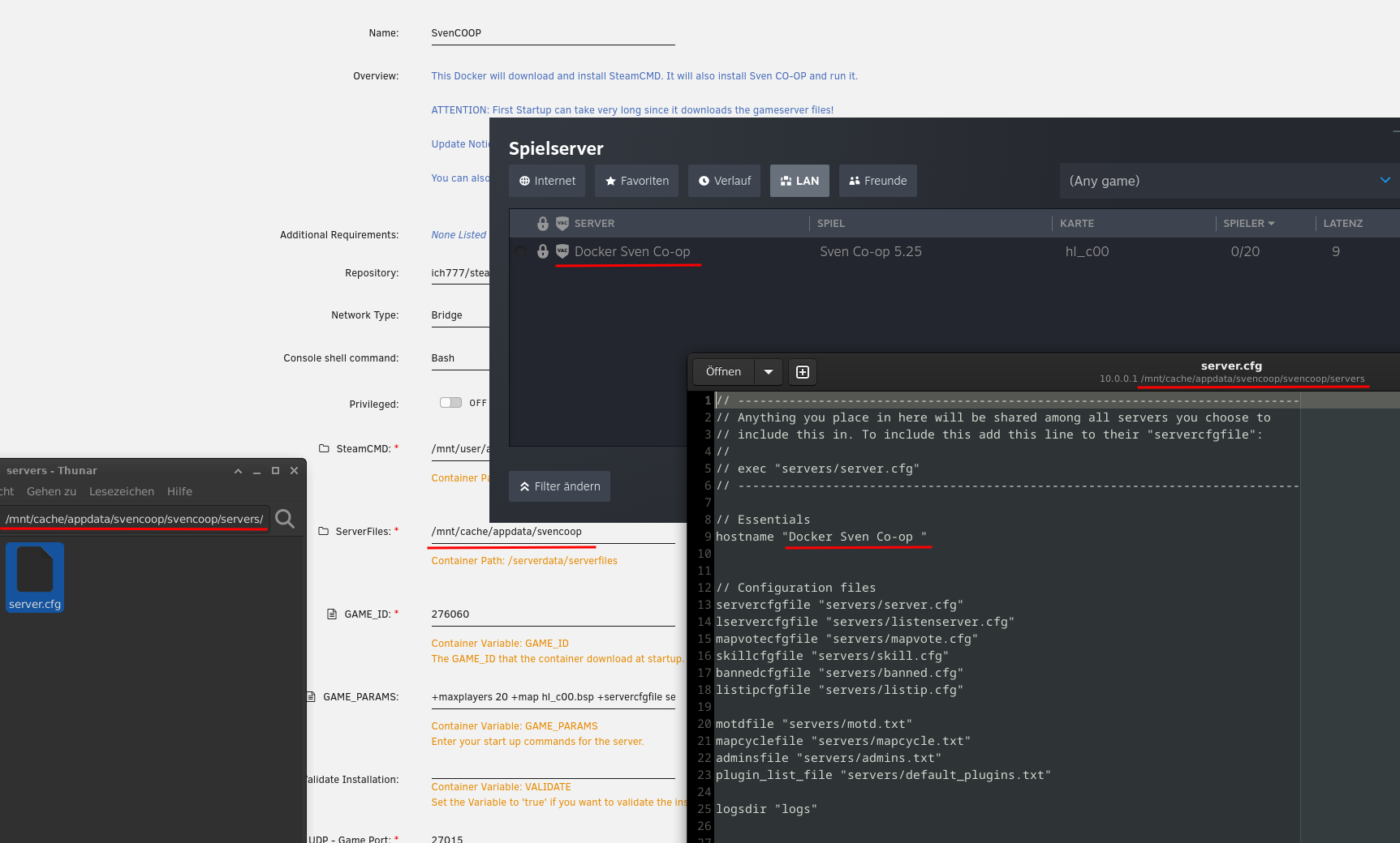

unfortunately no it's very surprising, especially since I reset my server and formatted all my disks
Sorry but something is very wrong on your setup and it tries to read the file from somewhere else where it can't read the file and it falls back to the default server name.
I really don't know what's causing that on your machine.
If you upload your Diagnostics I can go through them if you want me to do that but as shown in my screenshots above it is working fine over here.
