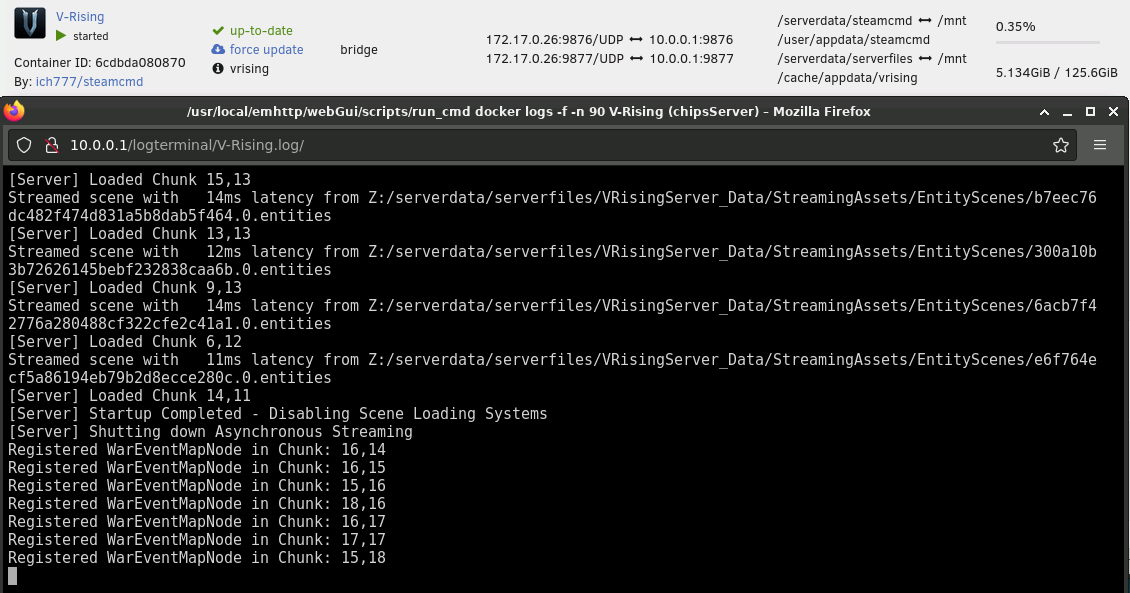

I can't reproduce this over here, everything is working fine:
Running Unraid 6.12.10
