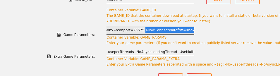

After hours of absolutely beating my head against the wall... I found the issue! I am sure this has been noted, but I did not come across this comment anywhere in my search... so in case others come across this in the future, let me restate this:
These servers are not crossplay!!!
While I am on the PC, I am using the Xbox version of the game (because it was free to me). So for the life of me I could not figure out why the game would connect. The server booted up and appeared fine. Nothing indicated there was a problem other than the fact that I just could not connect. I even gave up on Unraid and attempted to install the server on my gaming PC using steamcmd and received the same result, I could not connect to the game.
I get the answer was staring me in the face, and even in my hours of reading and looking I am sure the answer was there and just didn't notice it.
https://tech.palworldgame.com/getting-started/for-xbox-dedicated-server
Solution:
Go into the PalWorldSettings.ini file and add OptionSettings=(AllowConnectPlatform=Xbox) as I added below.
[/Script/Pal.PalGameWorldSettings]
OptionSettings=(AllowConnectPlatform=Xbox,Difficulty=None,DayTimeSpeedRate=1.000000,NightTimeSpeedRate=1.000000,ExpRate=1.000000,PalCaptureRate=1.000000,PalSpawnNumRate=1.000000,PalDamageRateAttack=1.000000,PalDamageRateDefense=1.000000,PlayerDamageRateAttack=1.000000,PlayerDama
Again...hours wasted so hopefully someone else will find this quickly and save some time. Thanks @ich777 for responding to everyone. Your work is greatly appreciated, even if it is to solve our own glaring mistakes.
36 minutes ago, hiddentalnt said:
Solution:
I think it should also be possible to just pass it over here:
I could be wrong about that but it should work there too.
