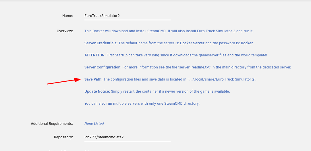

anyone was able to get euro truck simulator working ?
What‘s the exact issue? Any logs?
It should work fine.
1 hour ago, francrouge said:
But do i need to create manually the configs files ? thx
No, the container does all for you go to:
.../eurotrucksimulator2/.local/share/Euro Truck Simulator 2/
and there is everything located as pointed out here:
The file that you want to edit is basically server_config.sii (please also make sure to first stop the container before editing any files).
O god my bad i miss the line wow sorry thx a lot

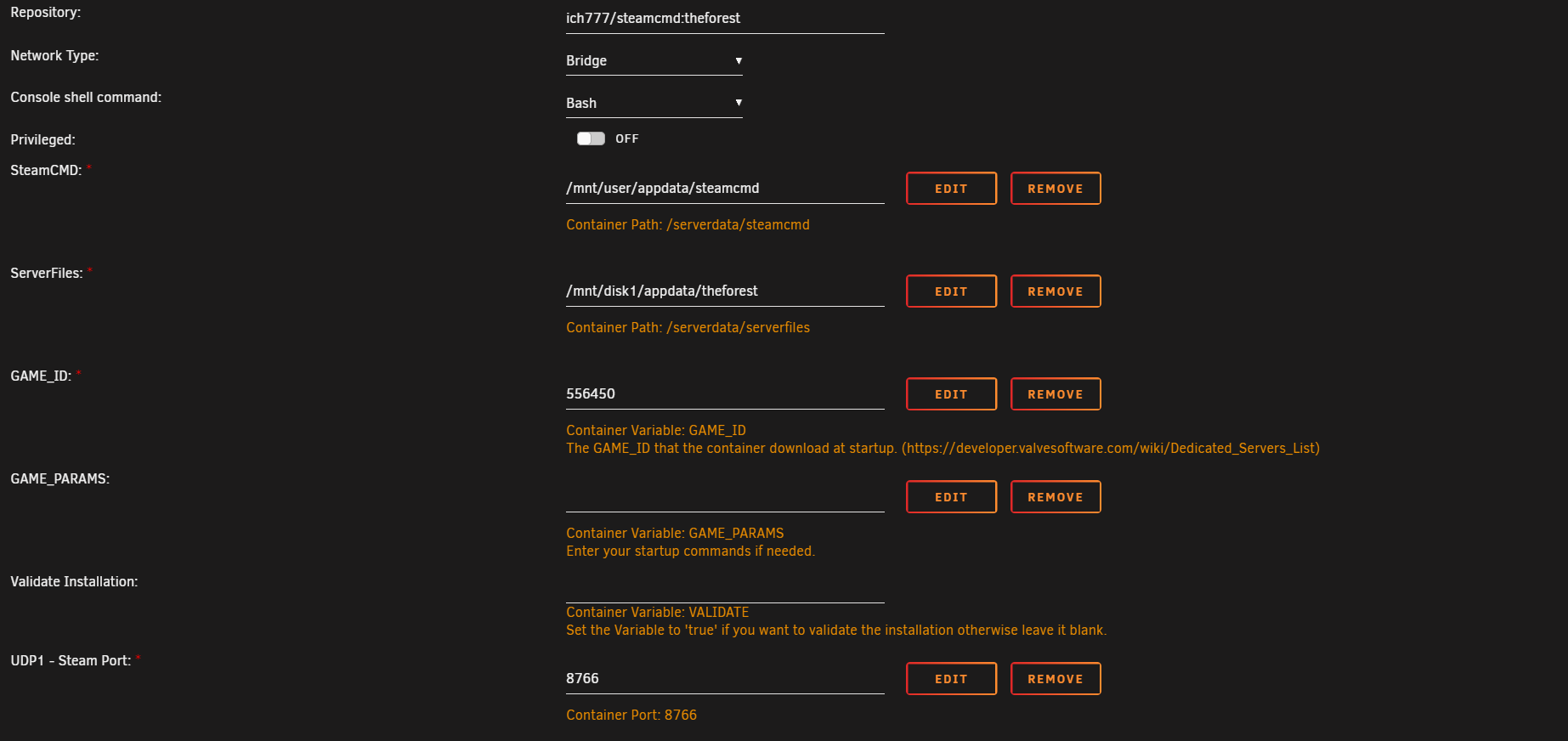

hey,
i was trying to create a dedicated server for the forest, but I am unable to do so because of errors. i have tried to generate different tokens with the following appids: 242760 and 556450. but each time I get the following errors:
wine: could not open working directory L"C:\\windows\\system32\\", starting in the Windows directory.
002c:fixme:actctx:parse_depend_manifests Could not find dependent assembly L"Microsoft.Windows.Common-Controls" (6.0.0.0)
002c:err:wineboot:main Cannot set the dir to L"C:\\windows" (2)
0034:fixme:service:scmdatabase_autostart_services Auto-start service L"MountMgr" failed to start: 2
002c:err:shell:SHGetFolderPathAndSubDirW Failed to create directory L"C:\\users\\steam\\AppData\\Roaming".
002c:err:shell:SHGetFolderPathAndSubDirW Failed to create directory L"C:\\users\\steam".
002c:err:shell:SHGetFolderPathAndSubDirW Failed to create directory L"C:\\users\\steam\\AppData\\Local".
wine: failed to open"/serverdata/serverfiles/TheForestDedicatedServer.exe": c0000135

if I use the appid 556450, the only thing that changes is that I don't get the following line with the errors: ERROR! Failed to install app '242760' (No subscription).
Could you please help me with this or let me know what might be causing the error?
And what is the exact error? Does the container restart?

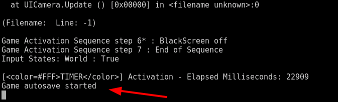

You should see something like that:
GameServer init success. Port: 27015
Set a LogOnAnonymous
0208:fixme:cryptnet:check_ocsp_response_info check responder id
Connected to Steam successfully
The Forest Server is not VAC Secure!
Game server SteamID:90199603862891540
CoopSteamManager Initialize
CoopLobby.LeaveActive instance=
0024:fixme:winsock:WSAIoctl SIO_UDP_CONNRESET stub
CoopPlayerCallbacks::BoltStartBegin CoopVoice.VoiceChannel:[UdpChannelName Voice:1]
Platform assembly: Z:\serverdata\serverfiles\TheForestDedicatedServer_Data\Managed\Mono.Security.dll (this message is harmless)
Platform assembly: Z:\serverdata\serverfiles\TheForestDedicatedServer_Data\Managed\System.Xml.Linq.dll (this message is harmless)
Platform assembly: Z:\serverdata\serverfiles\TheForestDedicatedServer_Data\Managed\Boo.Lang.dll (this message is harmless)
Will force game to new because GameSetup.IsSavedGameTrue LevelSerializer.CanResume False
[<color=#FFF>TIMER</color>] Cleanup - Elapsed Milliseconds: 0
[<color=#FFF>TIMER</color>] LoadAsync Start - Elapsed Milliseconds: 2
[<color=#FFF>TIMER</color>] failsafe - Elapsed Milliseconds: 4673
[<color=#FFF>TIMER</color>] Query state - Elapsed Milliseconds: 0
The referenced script on this Behaviour (Game Object 'Selector') is missing!
(Filename:  Line: 1744)
Unloading 3 Unused Serialized files (Serialized files now loaded: 0)
UnloadTime: 8.934900 ms
VR SWITCHER AWAKE
(Filename: C:/buildslave/unity/build/artifacts/generated/common/runtime/DebugBindings.gen.cpp Line: 51)
VR SWITCHER RUNNING ON DEFAULT SETTINGS
Switching vr rig enable = False
****** Game Activation Sequence ******
Game Activation Sequence step 0 (GameStartType=New)
[<color=#FFF>TIMER</color>] LoadSave Awake - Elapsed Milliseconds: 7
PlayerPreferences.Load

This should be the last message in the container logs:
Game autosave started
On what hardware do you try to run the server?
As you can see above I just tried it and the container is running fine on my system.
Why do you want to do that? This is the game ID from the game itself and not the dedicated server, so to speak, that can't work.
In the Docker template you always have to use: 556450
What path in the Docker template is set for the Game files? Is it set to /mnt/cache/appdata/... or /mnt/user/appdata/...?
Please make sure that if it's set to /mnt/cache/appdata/... that your appdata share is set to stay on the cache (so to speak Cache as the Primary storage) and the Move takes no action or moves the files from the Array to the Cache.

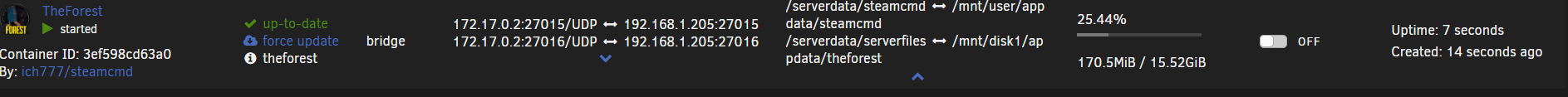

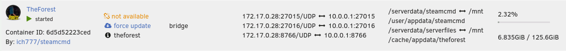

How much resources is the container using, on my server Intel i9-10900 it is looking something like that:grafik.thumb.png.267744506f9afa8d2e05bd47d620b0b8.png
this is how it shows up
i run it on a 4 core i5-3470 CPU with 16 gigs of ram
got it, thanks! now i used the AppID 242760 to generate my steam token
