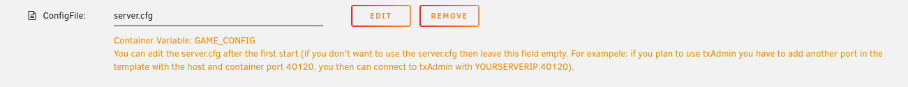

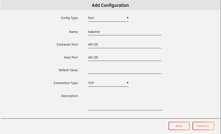

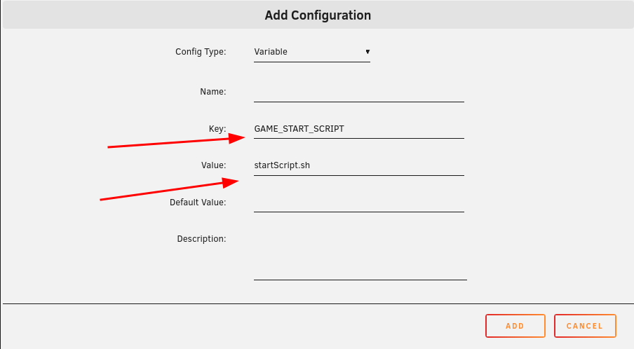

If you want to use txAdmin simply remove the server.cfg from that variable (as described in the variable) :
And create a port variable like so:

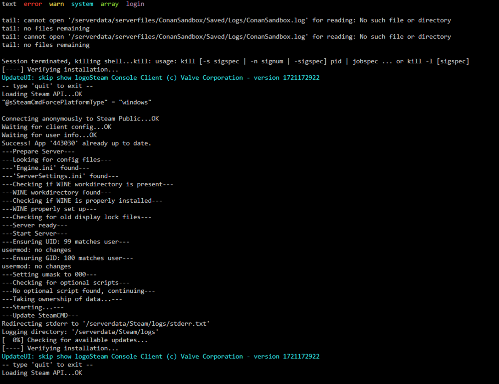

Hi :) , I've created a docker for Conan Exiles (ich777) but the server doesn't seem to want to start or rather it restarts in a loop. I'm new to docker so I don't really know how to solve this problem.
I have this in the logs file :
thank you for your help
Did you change anything in the template?
Sorry I don‘t see the important part here.
Did you enter you Steam credentials in the template, if yes please remove them, they are only needed if they are marked with the red asterisk and not hidden away under Show more settings…
No I didn't modify anything, I just installed the docker with the unraid appstore, everything was done automatically
...and what about my other question?
On what hardware do you try to run the container?
I've now installed the container over here and it restarts one time (this is expected) and then starts the dedicated server properly.

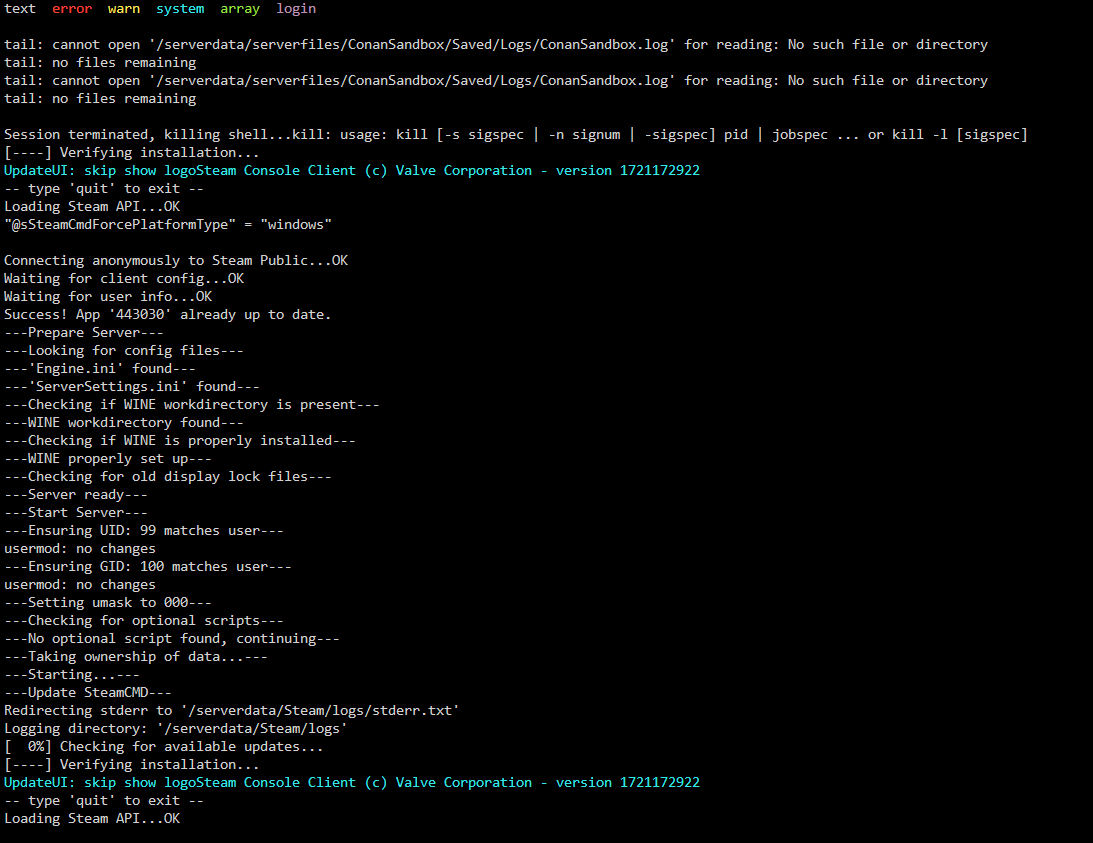

Yesterday, I left it running for several hours, and the logs are still the same

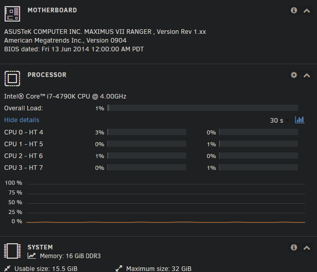

I think the issue is that your CPU is too old and it doesn't support all the necessary instructions, I think you have to be at least on a 6th Gen Intel i-Core series CPU to run Conan Exiles.
This seems a bit strange to me, I've checked the minimum requirements and my processor seems compatible:
https://conanexiles.fandom.com/wiki/Dedicated_server_system_requirements
Is this only due to Docker? Maybe I should try it on a vm windows server or linux?
I think the issue is actually that it has an issue with a missing file.
it crashed because it couldnt find the ConanSandbox.log file in /serverdata/serverfiles/ConanSandbox/Saved/Logs/
@Ashilder create that "ConanSandbox.log" file in your Appdata share,
I assume the "default":
"/mnt/cache/appdata/conanexiles/ConanSandbox/Saved/Logs"
Edit: yeah without that file the container keeps restarting on my systems. With that file in place it, starts on a i3-4130 without an issue

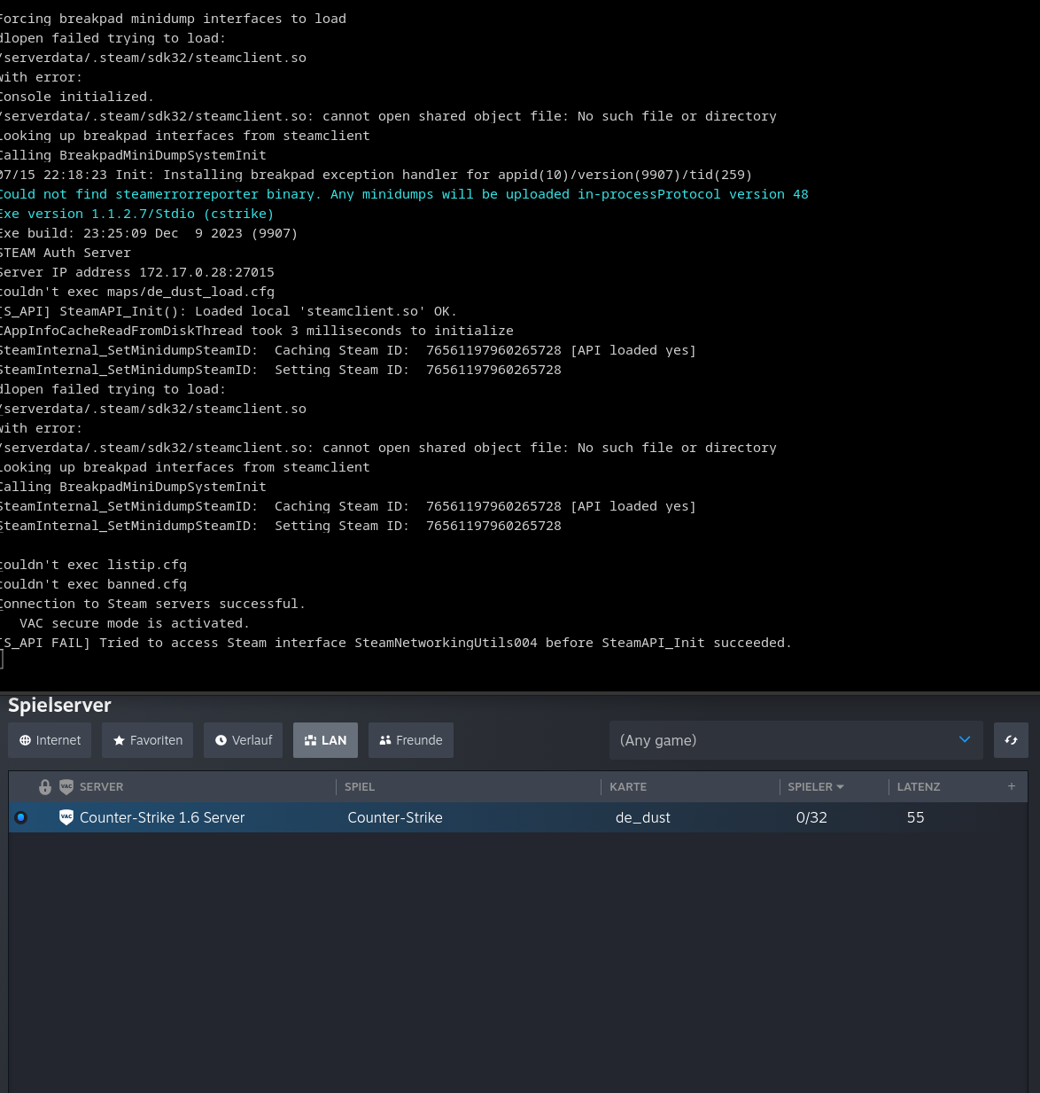

1 hour ago, ich777 said:
Here are we talking about the connection to Palworld or better speaking the container itself correct?
Do you maybe have Diagnostics from your server?
This was when i loaded the logs from the docker (Clicking the container and going -> logs). I was able to load the game and connect (From the game to my local server IP within my network) but the game will drop me and present me with an error and the logs just show me as leaving the server. The Log snippit i posted shows in just downloading the update it lost the connection multiple times for just the steamcmd update.
Sorry, but as said above, the container starts fine on my Intel i9-10900
I now updated the container to wait 10 seconds for logs so even this CPU should be able to start the dedicated server in time.
This is strange but why should the file be missing?
Maybe this old CPU is not quick enough to start the application in 5 seconds...
