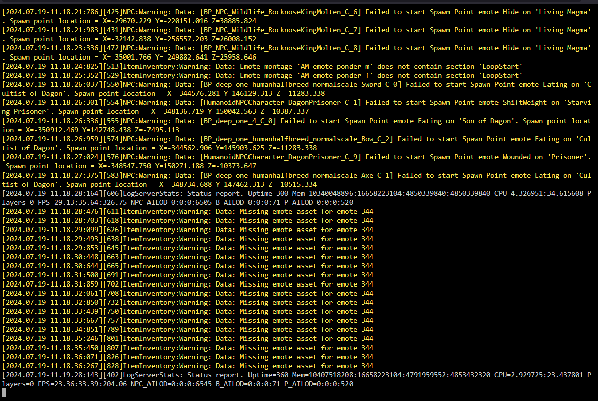

I finally managed to get the server working by removing ‘steamcmd’ and ‘conanexiles’ and redoing the installation.
I get a lot of errors in the console about entities but not about the log file that can't be found

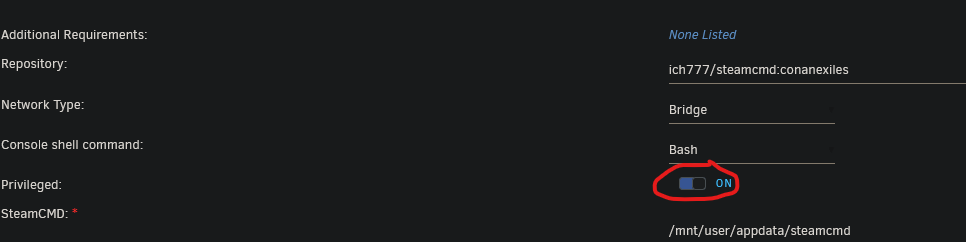

We need to tick this box
No you don‘t need to tickt that box and this is really bad what you are doing and a huge security implication!
I really don't know why everyone is so careless with this switch, this switch should always be off by default!
By enabling that switch you grant full access to the host and so to speak possible all your files and everything that is going on your system, this is really bad, please disable this immediately!
I've already pushed a update to the container which should fix the issue.
Please update the container itself (force update button with Advanced View on the Docker page enabled).
It seems that I rushed, I tried without checking this box and it works, there is just a problem during the first installation, some files like ConanExiles.log does not install.
edit: but you seem to have already solved the problem thank you!
