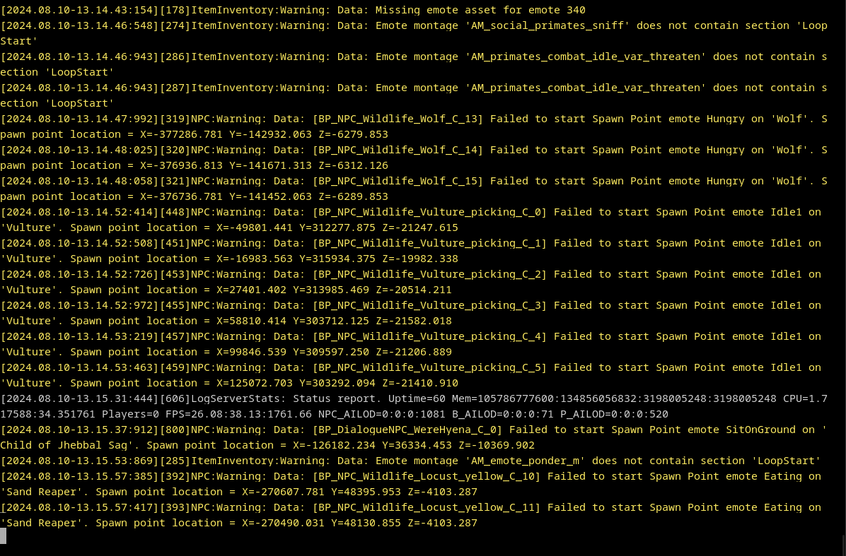

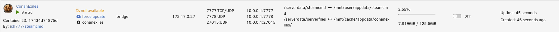

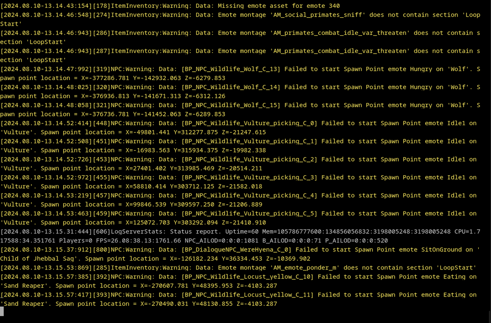

Yes, the 7d2d server is running fine now.
The CE server has the same issue as 7d2d had.
It restarts constantly. I don't know if/where there are startup-logs of the CE server, but in the continer log it looks pretty much the same.
It goes through all the SteamCMD stuff, installs/updates the mods (I also tried it without mods), then writes "server ready", "server starting" and then the window simply closes and the server seems to reboot.
Since I wasn't sure if the container log is correct, I just monitored the RAM usage, since the server usually takes up a lot of RAM when it's running. But it barely increased.

This is the last thing I was able to copy from the log window before it closed.

1 hour ago, Cinerir said:
I didn't use the server for a few months, and last month I switched the CPU, before the 5700G I used an 4750G.
Then it's most certainly the case you have to delete the WINE64 directory in your ConanExiles folder, of course first stop the container, delete the WINE64 folder and start the container.
I can't reproduce this over here on a new installation:
ConanExiles.log
The dedicated server is properly running, above I attached the log from the first startup.
I'm trying to install and run the 7 days to die docker. I'm running into an issue where every time I start it (first time after it downloads game files, and after restarts) it hangs on the line "memorysetup-temp-allocator-size-gfx=262144". I'm using all of the standard settings pre-populated during the docker setup and I do have the ports 26900-26903 open. I can see the server populate on the 7dtd client side when I search for it, but am never able to connect to the server.
Any ideas if I'm doing something wrong or need to adjust my setup?
The server is starting now, after deleting the WINE64 folder.
Thank you a lot. So I would have to delete this folder after every hardware change?
