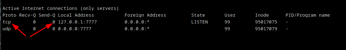

4 minutes ago, ich777 said:
However the workaround with removing -multihome=0.0.0.0 and using Host network for the container should work fine.
Hey ich, so just to make sure, br0 should NOT work at the moment? And would require coffee stain to correct the loopback issue? Thank you.
Not on my side.
I'm not 100% sure with br0 but it could be the case that it won't work, I just tested host network and it works fine over here.
Yes this is something that CoffeeStain needs to fix because there is no documentation on how to change the listen address for the API (TCP port) and I don't think you can actually change that.
My instance works on HOST, but not on br0 (server api error)

Since the container uses now the host network you have to enable "Host access to custom networks" in the Docker settings, this is disabled by default and your containers can't actually communicate if they are in a custom network with the host:
(at least that's the issue in your case I think)

I confirm this fixed the issue for me. So basically set:
GAME_PARAMS=-log -unattended -ini:Engine:[HTTPServer.Listeners]:DefaultBindAddress=any
This is in addition to the other fixes ich777 mentioned earlier, namely exposing port 7777 for both TCP and UDP (and making sure both are port forwarded in your router and removing the other two ports.
With those in place, no need to use the `host` network. In the previously linked Github thread, apparently a proper patch to fix this issue is expected to drop tomorrow.

@spotopolis, @Snappie88, @Jerky_san, @cybersteel8, @bbreau6, @gevsan, @rickyh, @emub. @Kegath, @AK20000, @rocklord2004, @Skwerls, @Torbjorn, @MaNs0n, @zTemmu, @ahal, @Byrd, @Trinacria
The Satisfactory container is now fixed and will work regardless if you are using bridge, br0, host,... network.
Just makes sure if this an existing installation to click force update on the Docker page (with advanced view enabled), remove multihome from GAME_PARAMS, create a new port entry with container port and host set to 7777 with protocol TCP.
For new installations everything will work right OOB.
