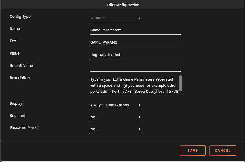

The Satisfactory container is now fixed and will work regardless if you are using bridge, br0, host,... network.
Just makes sure if this an existing installation to click force update on the Docker page (with advanced view enabled), remove multihome from GAME_PARAMS, create a new port entry with container port and host set to 7777 with protocol TCP.
For new installations everything will work right OOB.

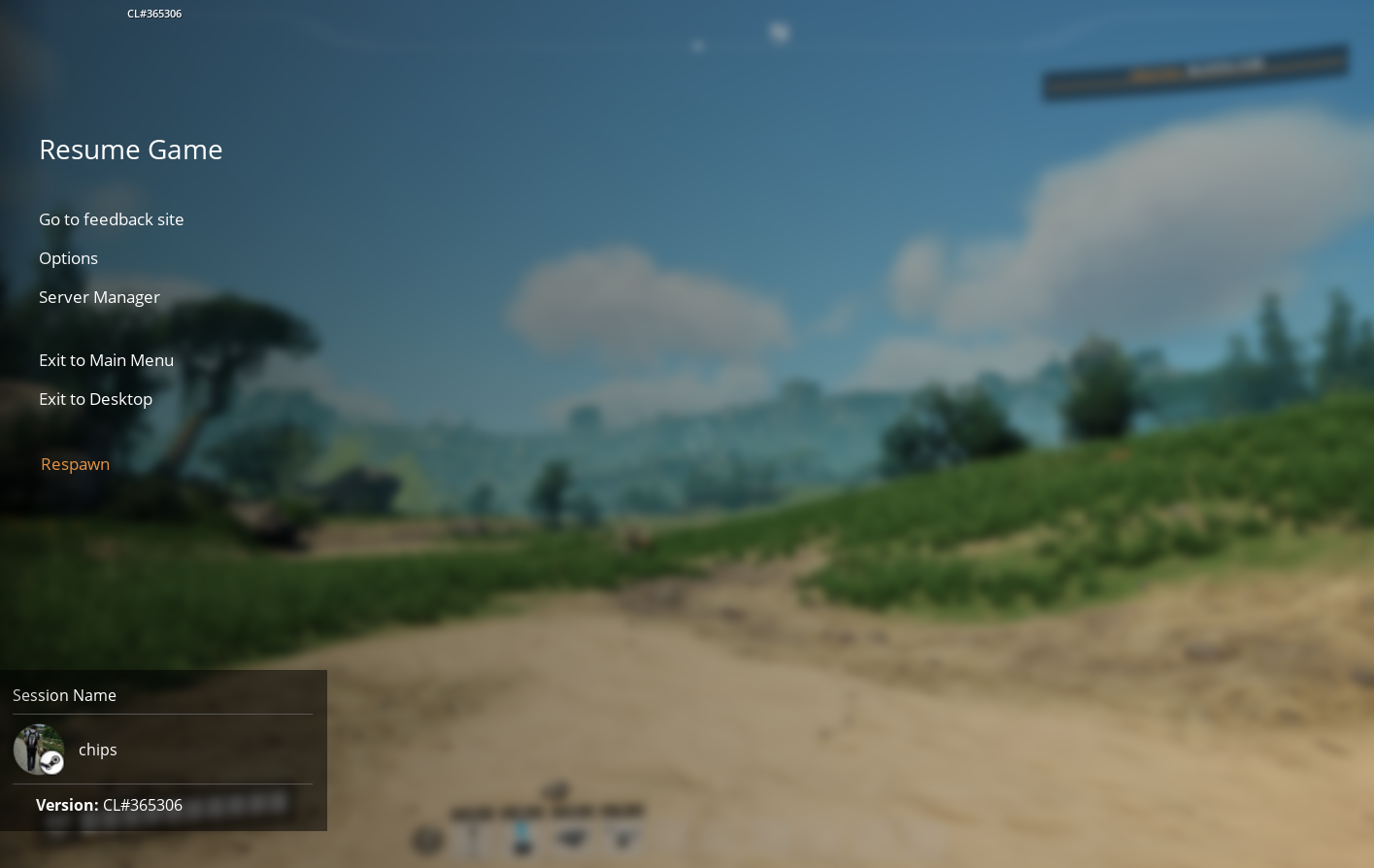

In game screenshot:

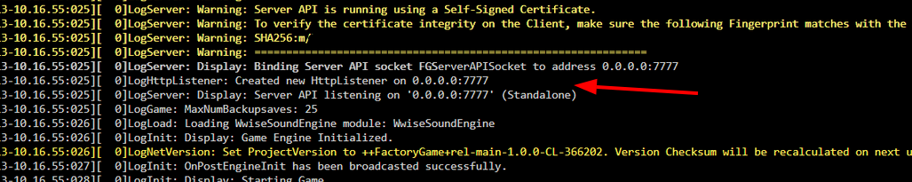

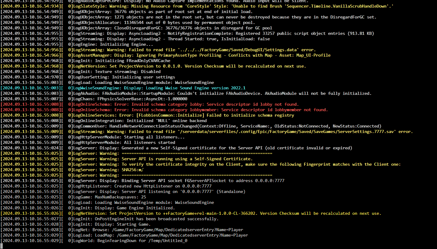

I have been banging my head with the satisfactory hammer for the past 2 hours trying to get this to run
I have uninstalled the docker cleared the remains via appdata clean up reinstalled check game parameters for the so called mulithome (did not find it)
left everything else as is
started the docker it did the download
the logs show as seen in this paste bin https://pastebin.com/f8bG1WUM Satisfactory logs unraid dedicated docker

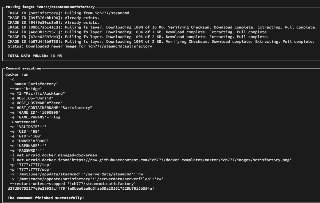

Tried force updating
TOTAL DATA PULLED: 0 B
restarted again
https://pastebin.com/0TYRA5yF Satisfactory logs unraid dedicated docker #log2
From what I can see the server is running and waiting for connections on port 7777
For new installations that's not needed anymore, you can use the container as usual, please see this post:

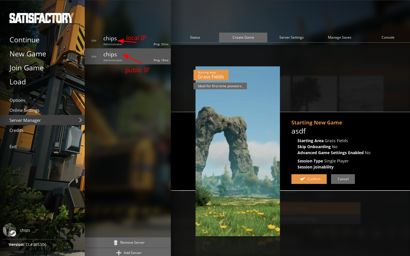

Please note if your Hair Pin NAT is not working properly you will be only be able to connect via LOCALIP:7777
This local ip seems to be the only one working for some reason o.o but i have no idea how to fix a "hair pin NAT" o.o

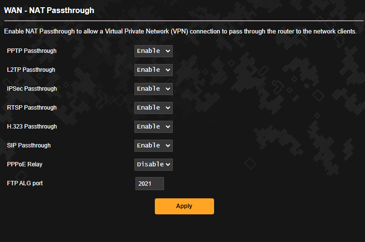

TUF gaming AX6000
Firmware Version:3.0.0.4.388_33411
FOr anyone that may know how to fix the NAT problem

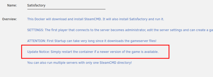

Hi, I'm curious about the Satisfactory docker and how often it updates? Yesterday the game updated on Steam and now I got mismatching game versions between the server and desktop game.
Everytime you restart the docker, it will check for game updates ...
As @baumix said, it's right in the description:
After the satisfactory update on steam yesterday I get a version mismatch error. Any idea how to fix?
Usually you just have to restart the container.
If that doesn't help, backup your Saves directory, after that stop the container, remove the container, remove the directory for the container, grab a fresh copy from the CA App and let it run for the first time, try to connect and see if it actually works, stop the container, delete the "new" Saves directory, place the Saves directory that you backed up in the new installation and finally start the container again.
I really don't know why for some people the automatic update fails, I was never able to reproduce this on my server.
