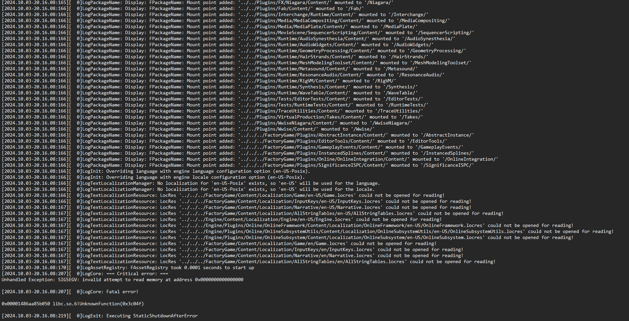

Hello,
I suddenly got a fatal error during playing on the server: invalid attempt to read memory at address 0x0000000000000000
I tried restarting the server, but then it wouldn't start anymore with the same error.
I then removed the docker app and the server files and installed a fresh one and uploaded my current save files.
It then worked for a few minutes before crashing with the same error.
Once my game crashed when the server crashed
Edited by thesuperdoge
11 minutes ago, thesuperdoge said:
Hello,
I've removed a RAM stick and it works fine now it seems, so i have faulty RAM apparently.
Bummer

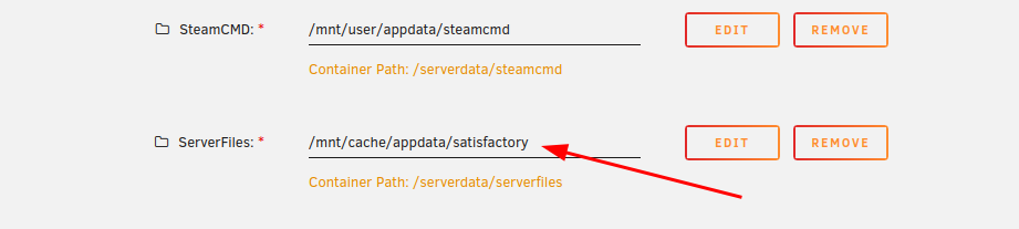

What path are you using in the template for the game files?
Do you mean this:
Edited by Todilo
46 minutes ago, Todilo said:
Never tried it before, however have successfully run valheim server in the past.
I assume your hardware is to old to run the dedicated server since this is a AMD Phenom which lacks many instruction sets nowadays and since this game is based on the Unreal Engine 5 it's most likely the case some instructions are missing hence the message Illegal instruction.
Ohh I see! Maybe time to upgrade the computer. Thank you very much for your time and assistance.
