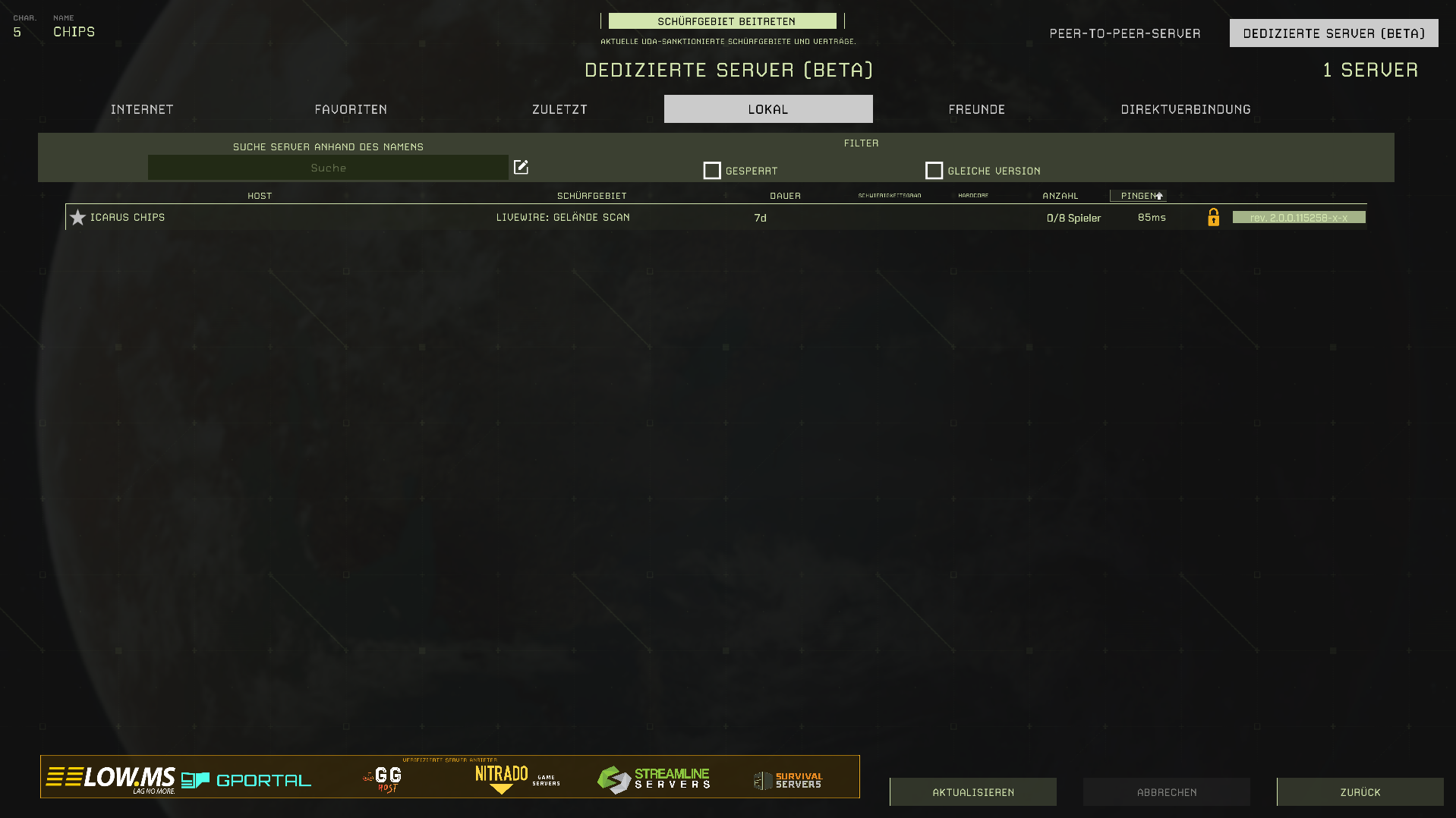

Jokes aside, these lines actually indicate that the server is running and waiting for connections.
I'm not 100% sure if Icarus is a game which needs actually a connection to the master server and the ports forwarded (since I created the container a long time ago).
The last time I tested it with the ports forwarded everything was working just fine.
I'll attempt the port forward and report back, appreciate your help as always :)

Perfect! That did it, now the question is, why are there two? lol
And then how
would I get DLC added to the server if possible
Edited by Nibbles
I really can't tell but maybe the game is now detecting the LAN and WAN game.
And then how would I get DLC added to the server if possible
I don't think that you need to add it and it should be in there by default since the dedicated server should have everything necessary to play, even DLCs <- I could be very wrong about that since I even didn't know that there is now a DLC for Icarus.
