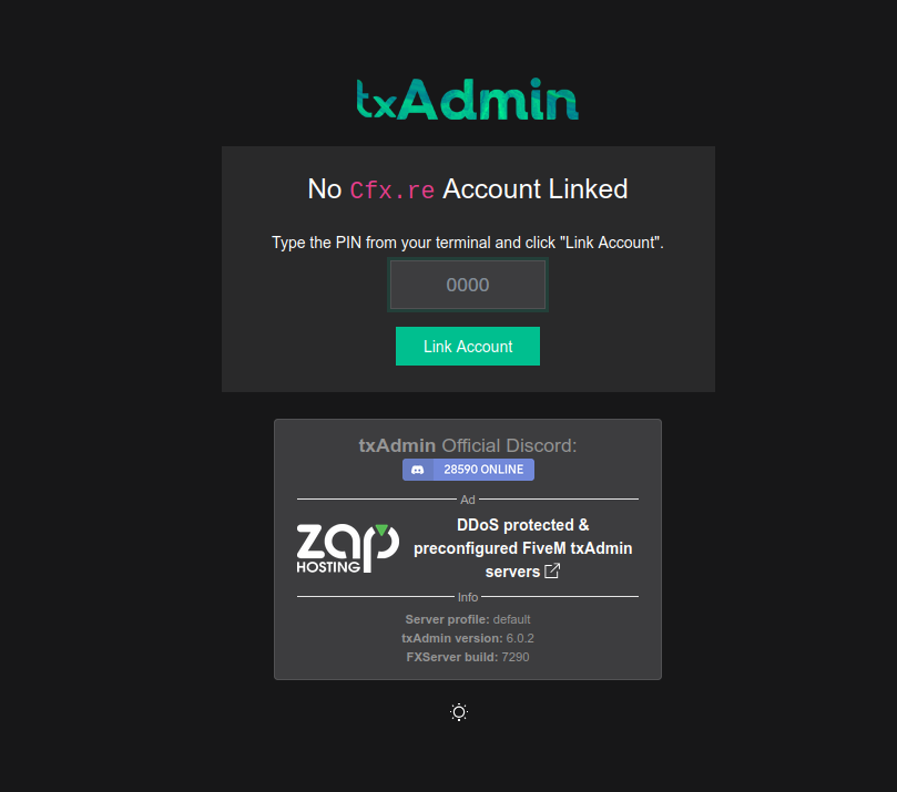

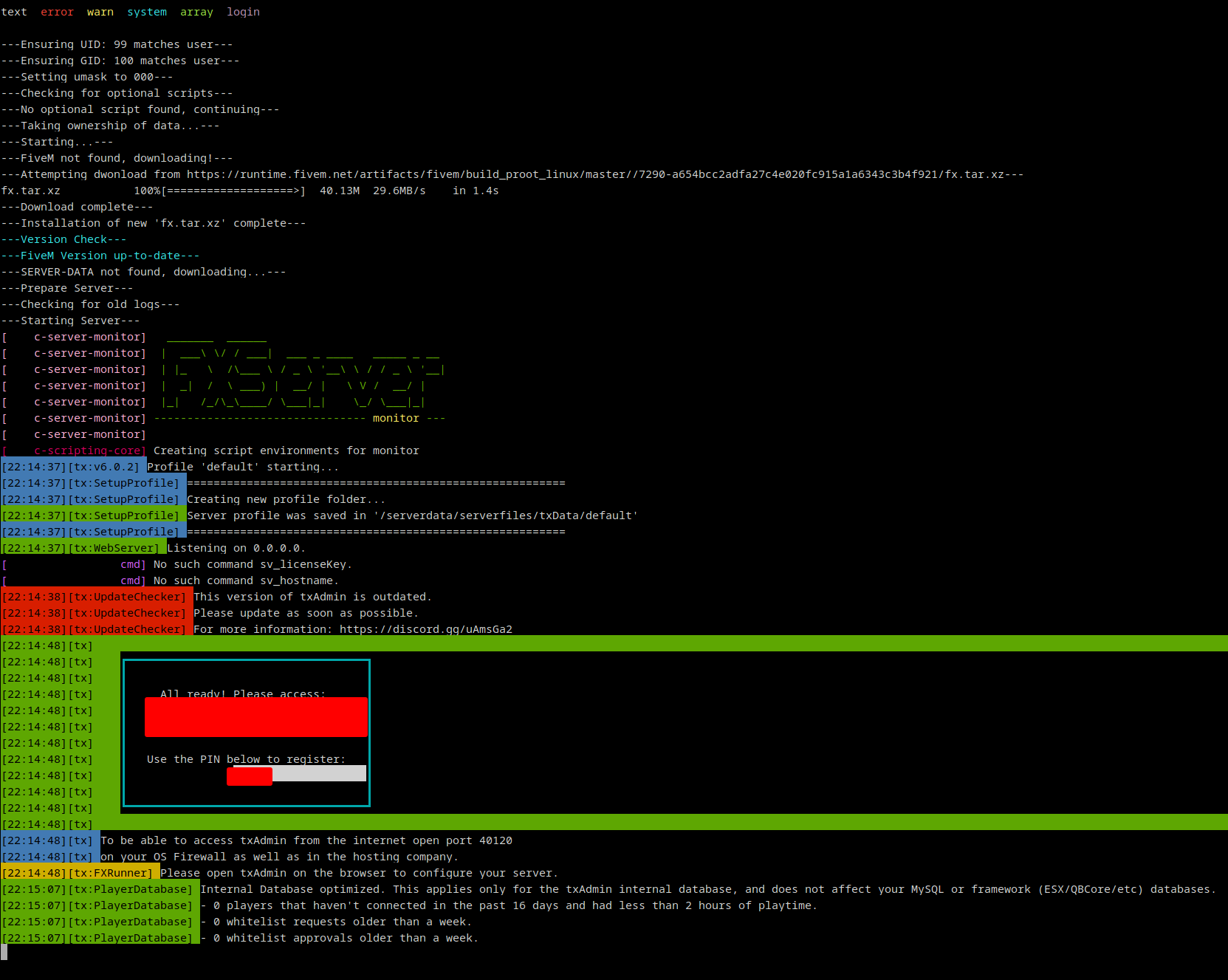

So i wanted to use my Old serverdata which worked, now in the Logs it wont let me start the server as port 40120 is already being used (picture).
i also included my container config i have no idea whats up here, i restarted the Sarver and reinstalled everything but that didnt help i also changed the tx admin port and tried differrent ones but it keeps doing the 40120 being used thing. WEll, editing this here becuase i did some stuff and now it says TxAdmin port is not valid......
Edited by CaymanHosting
Sorry but I can't reproduce this over here with a new installation, everything is working just fine:
txAdmin is also working fine:
Are you really sure that you don't have anything else on this port running, it must me a configuration issue on your end.
