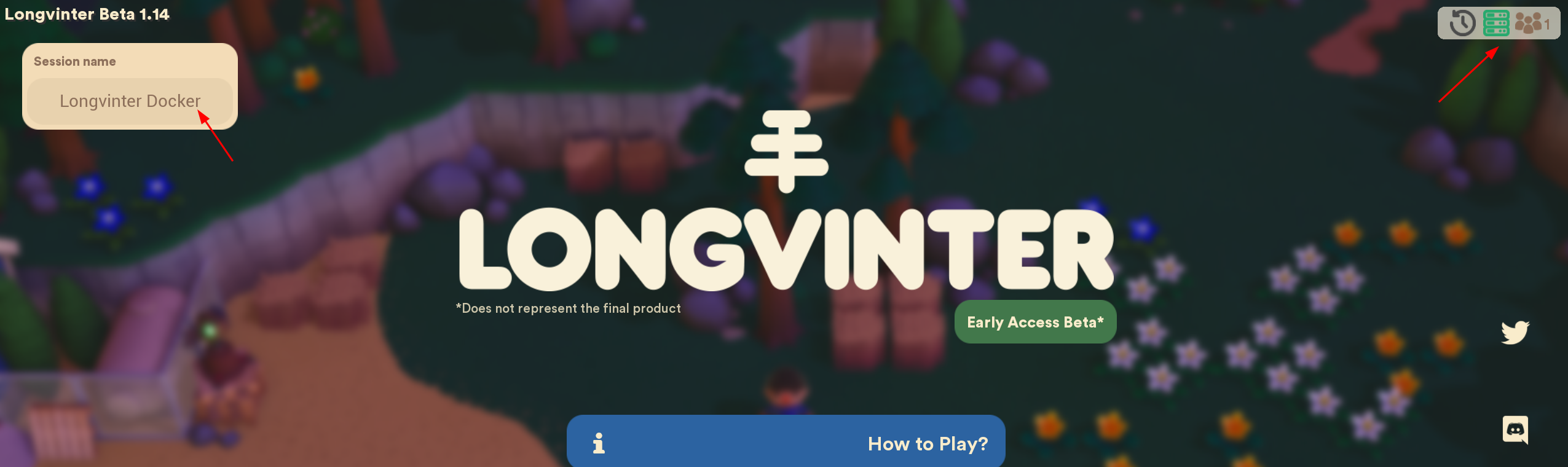

Here is a screensho t where you can see that I'm connected to the container:

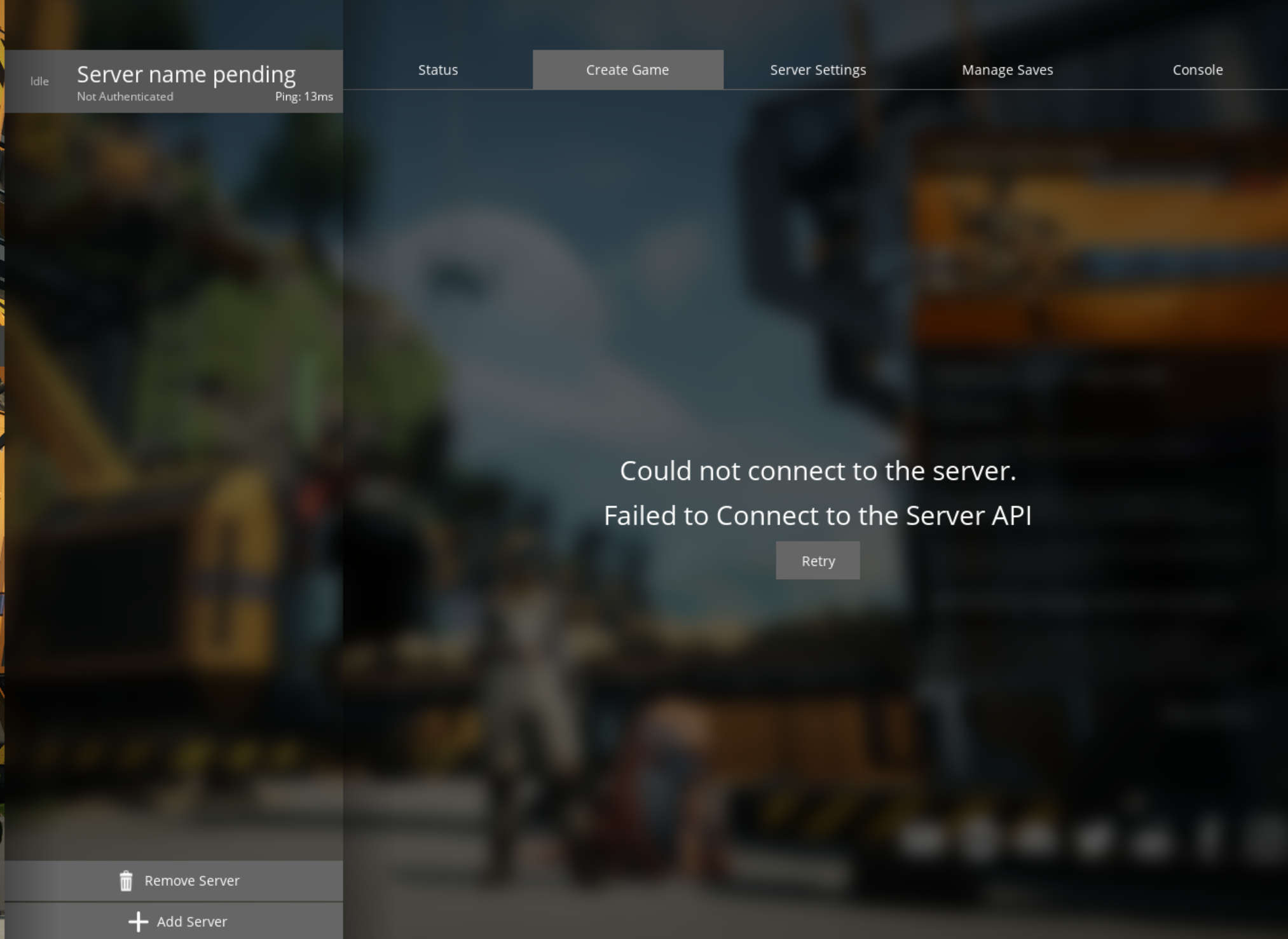

Hi folks, I had a Satisfactory server running over a year ago when it was early access.  I recently tried to start it up again now that the game is released, and while it appears to have updated properly, I am having an issue connecting to the server with the client.  After adding a server with the my LAN IP and default port, the client shows a server with low ping, it shows the "Server Name Pending" and "not authenticated" as well as "Failed to Connect to the Server API".  Unfortunately I don't remember if there were other steps I took to get it running originally.  Can anyone shed some light on this?
Please read this post:
I think it would be best to start over since you need to do some kind of migration IIRC, this is now necessary if you want to port over a save game from beta to release but don't quote me on that.
Starting fresh worked.  It even seems like there are fewer ports with the new install than there were on the old one.  Thank you for your help!

Just attempted a reinstall and getting this as my last line. What can I do to make this work/be viewable on local?
Edited by Nibbles
Should have clarified this is for Icarus
16 minutes ago, Nibbles said:
Icarus issues :)
Not an issue... :D
Jokes aside, these lines actually indicate that the server is running and waiting for connections.
I'm not 100% sure if Icarus is a game which needs actually a connection to the master server and the ports forwarded (since I created the container a long time ago).
The last time I tested it with the ports forwarded everything was working just fine.
