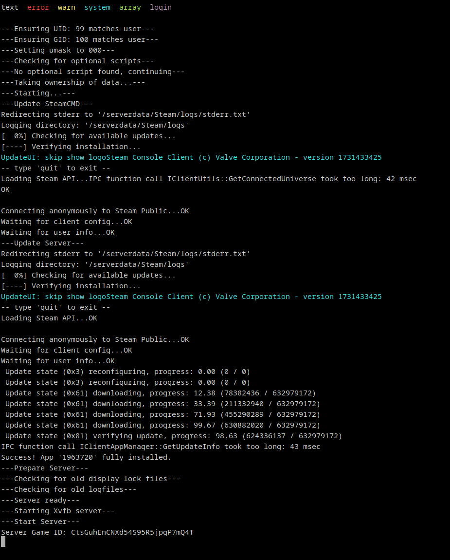

okay, this is rather peculiar. Since you asked for the log and i stupidly deleted the files already, i had to reinstall the asa server and it wont work anymore. Seems like they updated the dedicated server right after and its broken atm because the dedicated server version wont even start on my pc. 🤣
So yeah, that took longer than i wanted to because i had to copy the whole game onto the server. (they actually updated the dedicated server while im prepping this text, so they fixed their broken update)
48 minutes ago, jspeeples said:
In your testing did you copy in all of Ark ApI's files? The Log should have stared out with a bunch of green text saying what version of Ark API your running and all
I did install it as the website says, unzip it all in the win64 directory. But i didnt change the log to tail. Heres the log of the Ark-Api thingy
