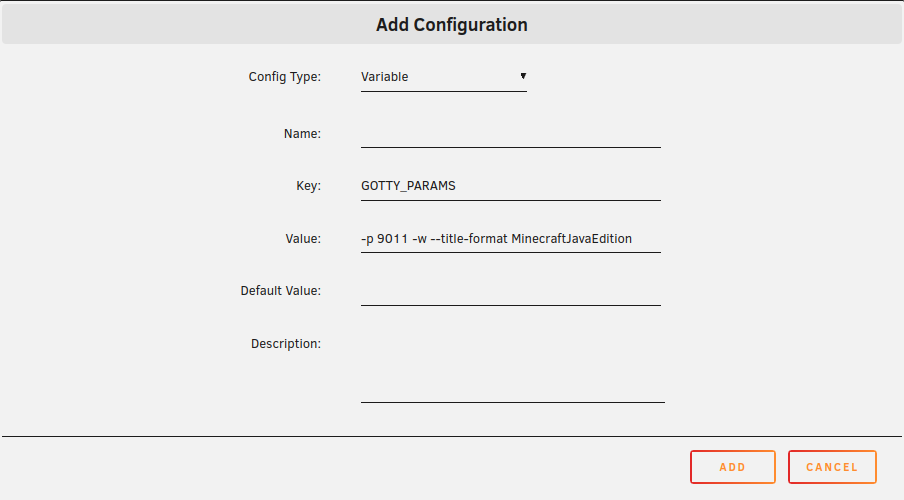

You can change the port by adding that to the template:
Config Type: Variable
Key: GOTTY_PARAMS
Value: -p 9011 -w --title-format MinecraftJavaEdition

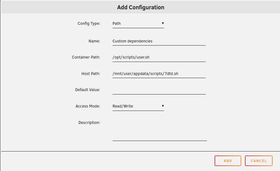

I have a 7DTD server running and after installing a mod ,i noticed the below error in the logs.
2024-11-29T14:56:19 74.882 ERR [MODS] Error while executing GameStartDone on mod "WalkerSim"
2024-11-29T14:56:19 74.885 EXC The type initializer for 'System.Drawing.GDIPlus' threw an exception. ---> libgdiplus.so.0 assembly:<unknown assembly> type:<unknown type> member:(null)
  at (wrapper managed-to-native) System.Drawing.GDIPlus.GdiplusStartup(ulong&,System.Drawing.GdiplusStartupInput&,System.Drawing.GdiplusStartupOutput&)
  at System.Drawing.GDIPlus..cctor () [0x000b0] in <6d510e0863874ad0b12fe1f2016a4a74>:0
Rethrow as TypeInitializationException: The type initializer for 'System.Drawing.GDIPlus' threw an exception.
  at System.Drawing.Image.FromFile (System.String filename, System.Boolean useEmbeddedColorManagement) [0x0001d] in <6d510e0863874ad0b12fe1f2016a4a74>:0
  at System.Drawing.Image.FromFile (System.String filename) [0x00000] in <6d510e0863874ad0b12fe1f2016a4a74>:0
  at WalkerSim.MapData.LoadRoadSplat (System.String folderPath) [0x0003e] in <c83a11d983ab4baba4a7f9447b821282>:0
  at WalkerSim.MapData.LoadFromFolder (System.String folderPath) [0x00011] in <c83a11d983ab4baba4a7f9447b821282>:0
  at WalkerSim.Simulation.LoadMapData (System.String directoryPath) [0x00011] in <c83a11d983ab4baba4a7f9447b821282>:0
  at WalkerSim.WalkerSimMod+<>c__DisplayClass7_0.<InitializeSimulation>b__0 () [0x00000] in <c83a11d983ab4baba4a7f9447b821282>:0
  at WalkerSim.Utils.Measure (System.Action action) [0x00005] in <c83a11d983ab4baba4a7f9447b821282>:0
  at WalkerSim.WalkerSimMod.InitializeSimulation () [0x0005c] in <c83a11d983ab4baba4a7f9447b821282>:0
  at WalkerSim.WalkerSimMod.GameStartDone () [0x00012] in <c83a11d983ab4baba4a7f9447b821282>:0
  at ModEvent.Invoke () [0x00011] in <5ee89a40cc924b60970cb3e356b19db3>:0
UnityEngine.StackTraceUtility:ExtractStringFromException(Object)
Log:Exception(Exception)
ModEventAbs`1:LogError(Exception, Receiver)
ModEvent:Invoke()
<startGameCo>d__134:MoveNext()
UnityEngine.SetupCoroutine:InvokeMoveNext(IEnumerator, IntPtr)
From the mods readme it suggests the following dependencies should be installed. Can i do this with your container and all the dependencies to persist after a restart?
LINUX NOTE
In case you see some exception when starting a dedicated server on Linux you may be missing some dependencies, run apt-get update && apt-get install -y apt-utils libgdiplus libc6-dev to resolve the issue, depending on your OS it might be a different package manager, just ensure libgdiplus and libc6-dev is installed.
Edited by KeyBoardDabbler
Where are you seeing this & what mod did you install?
this error is in the output_log.txt
this is the mod, walkersim 2
Does it say ERR or WRN in the log?
ERR
the exception happens because the container is missing some libraries it uses,
root@a8fd3ba25a75:/# dpkg -l | grep libgdiplus
root@a8fd3ba25a75:/# dpkg -l | grep libc6-dev
root@a8fd3ba25a75:/# dpkg -l | grep apt-utils
root@a8fd3ba25a75:/# apt --version
apt 2.6.1 (amd64)

I have just forked the container and added the dependencies to the image. Everything is now working

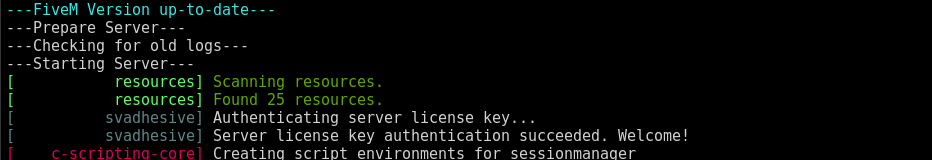

When my FiveM server completely starts i get the a bunch of errors in the log (photo included). I wasn't able to debug much from the .dmp file, but what I was able to figure out is that some very important files within the alpine/opt/cfx-server/ were getting deleted when I checked the file folder. I've reset the server multiple times, clean wipe etc. and am unsure what to do. It could be problems with the file permissions but I am unsure.
I posted on the CFX Forums and requested support from cfx.re help.
the only other post ive found like this wasnt much help but could help: https://forum.cfx.re/t/i-cant-run-fivem-server-on-my-linux-vps/2582560
he said it was a permission problem, but thats all the information he gave.
thank you for your help in advance!
Photo: Screenshot2024-11-16162915.thumb.png.0ea228b79c177682400453d74f87fdf3.png
and heres the .dmp file: 2149a52a-2c48-44f5-a9d4c0a6-69975f65.dmp
Edited by BomberTutt
There are multiple ways to tackle this:
1. Create a script on your Server (somewhere in appdata) with the contents:
#!/bin/bash
apt-get update
apt-get -y install libgdiplus libc6-dev apt-utils
2. Make it executable (on your server) with:
chmod +x <YOURSCRIPTNAME>.sh
(obviously you have to replace <YOURSCRIPTNAME> with the name from your script
3. Mount it to the container:
Container Path: /opt/scripts/user.sh
Host Path:      /mnt/user/appdata/scripts/7dtd.sh
Something like:
of course you have to change the Host Path to where the script is.
With that the container will execute the script each time the container starts as root.
The second way would to just wait and ask, I can also add these dependencies, this should be only around 30MB more.
Let me know what way you choose.
Seems like a permission issue... xD
Jokes aside, I have now installed a new instance on my server and it works perfectly fine:
On what Unraid version are you?
Are you sure that the paths in the Docker template are correct?
