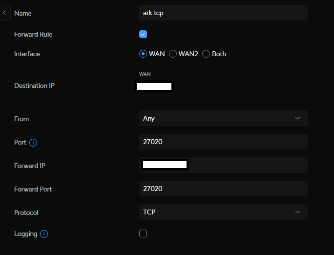

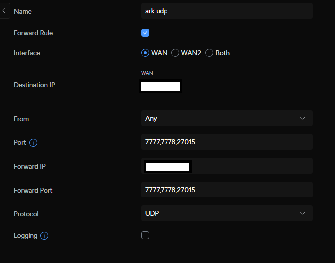

16 minutes ago, DScamp said:
Is there any way I could test that the Hairpin NAT is working?
Do you have other services running on your server which are exposed to the Internet?
If it is possible to resolve your public IP internally NAT Reflection is working properly.
I'm not that familiar with Unifi network gear but I had a few people here who had issues with NAT Reflection not working properly and some other IDS related issues.
BTW, I'm not 100% sure if it's possible to host a ARK dedicated server on PC which a Playstation can connect to.

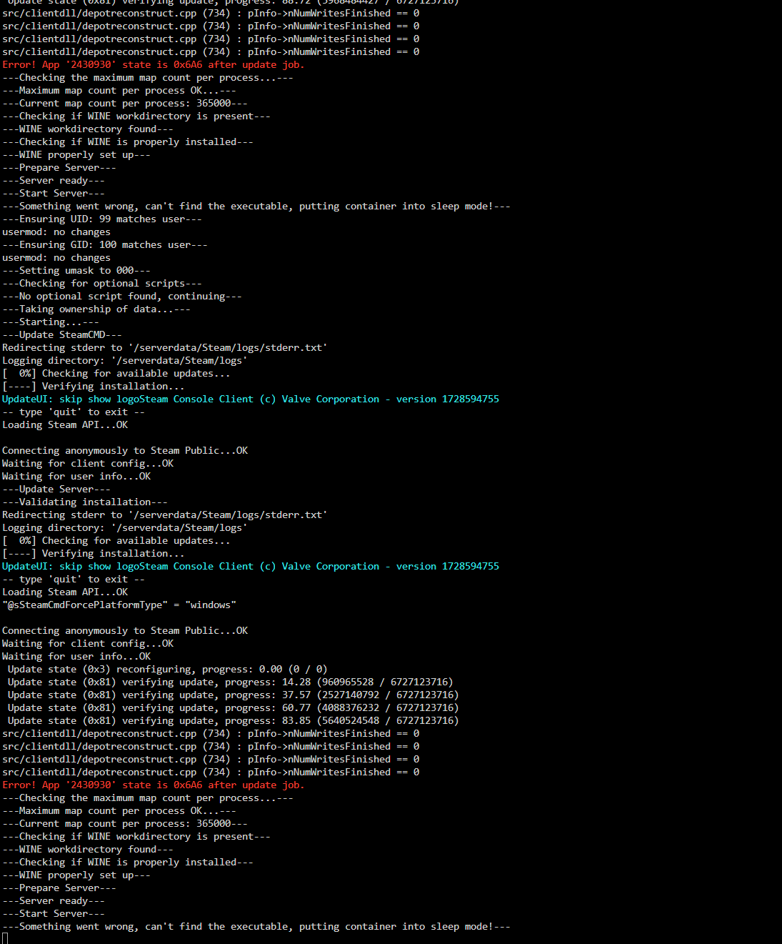

Having a random error on ASA dockers this morning, tried restarting the array and also uninstalled then reinstalled one of the maps but still get the same error in logs
Edited by dsharpe89
remove url from photo
The error 0x6A6 indicates an issue with your storage.
Are you sure that you have enough disk space available, please also check your syslog if you got errors related to disks.

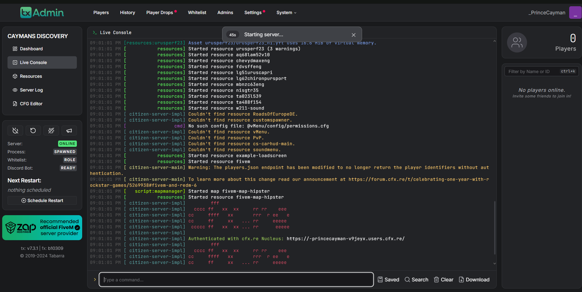

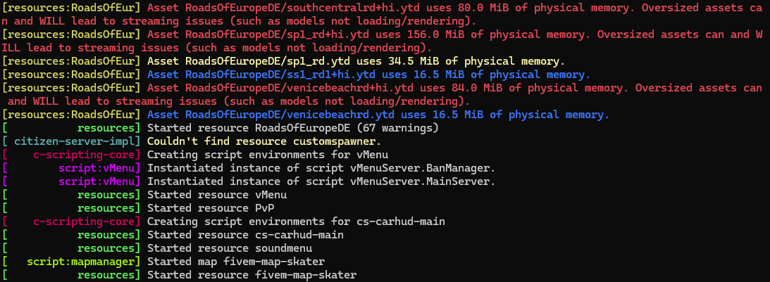

I have the server on my custom network, its starting and i can connect, the some scripts dont work, the names and ensures are right, i checked resources and fxmanifests. idk why they aren activating. !!!! For clarification!!!!! The "main" server was the files that i had on my main gaming pc where i used to test stuff now i moved it to the unraid server.
Edited by CaymanHosting
Clarification
My vDisk for docker was full but i increased the size but still have the same issue, lots of storage in my array

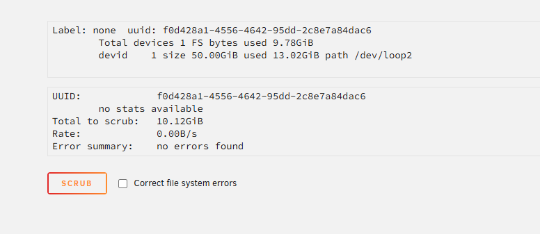

But the vDisk is not the issue since the container loads everything into the appdata directory.
Please double check the path for the game files, does it say /mnt/cache/appdata/... or does it say /mnt/user/appdata/...
If you have a cache drive and the path points to /mnt/cache/appdata/... the container can't download anything and that's why you see this error.
Sorry, I can't give any support for custom scripts and modding since I can only give support for the containers themselves when something is not working but your issue seems modding related and not container related.
That was it!!! Thank you very much
