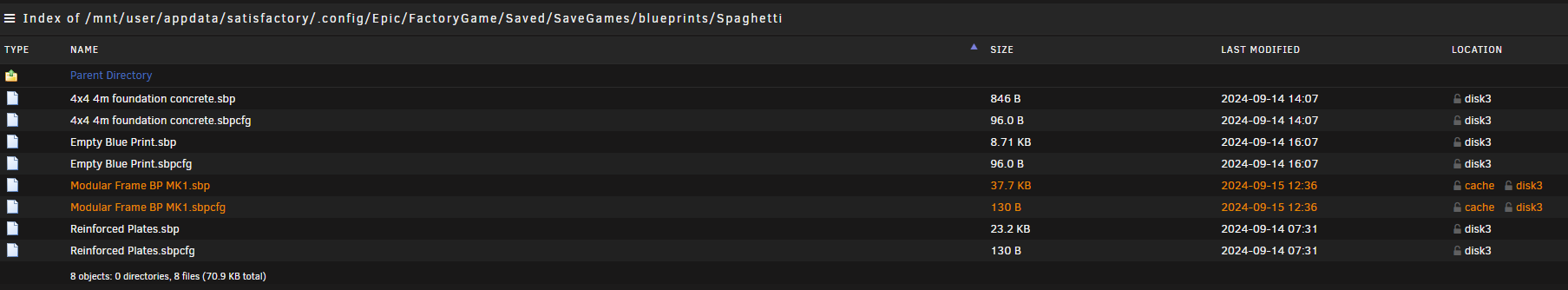

Restarting a Satisfactory container will mean losing blue prints that were created in game. the files still exist in
appdata\satisfactory\.config\Epic\FactoryGame\Saved\SaveGames\blueprints\<saveName>
A reddit post Blueprints Gone after Server Restart shows a fix but it is for wolveix/satisfactory-server image.
Is there something we can change to ich777's Satisfactory unraid docker to get a similar fix?
Are you really sure that all paths are set correctly? I know a few poeple who are using my container and do not have issues with blue prints.
Please double check if you have set the path in the template to /mnt/cache/appdata/… that your appdata share actually stays on the cache and is not moved over to the array.
BTW when I read the reddit post it was actually user error, see the first answer to the post and the post that you‘ve linked is 2 years old…
Looks like it might some cache settings. If I log in right now I can see the "Module Frame BP MK1", but not others. And that is the one that is on cache still.
Should the docker be stored in cache or in array? Or should it be made such that it doesn't move these file, just copy?
1 hour ago, ich777 said:
No, why?
You are overthinking it too much, why not edit the start-server.sh script through the user.sh and simply remove the map from the GAME_PARAMS from the template, with that you can inject a random map by the before mentioned user.sh script in the start-server.sh?
This would be way simpler any you wouldn't have to rebuild the container.
I think with that idea it should be pretty obvious what to do.
🤦‍♂️you are right, i was too focused on the ENV. I ended up mounting a version of the start.sh which will execute
source ./opt/scripts/user-start.sh
that worked in the end.
I have change that, replacing the ${GAME_PARAMS} via sed.
Thank you!
I would always recommend to leave the whole appdata folder on the cache since there are all relevant files for Docker stored which usually need quick access to the data which you are slowing down when some files are on the array and the array can never go to sleep how it is set up on your server.
If you don‘t want to do that then change the path from the game files to /mnt/user/appdata/…
