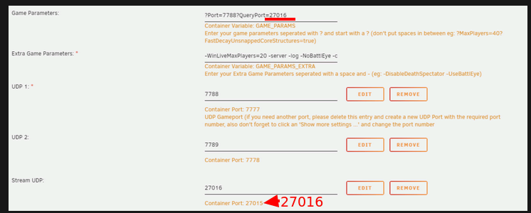

Hi Guys I need some advice or brainstorming help,
I currently have an Ark Survival Evolved Server that me and a friend are playing on AND I am trying to setup an Ark Ascended Server for the next map (we are doing the story playthrough).
I manged to get the server to show up in the ASA server browser (see image)
but I get a connection timeout everytime I try to join
could it be because of port mappings ? (screenshot shows ASE (Working) ASA (Not able to connect))
I also have these ports setup on the router (I know the ranges are wide you can bash me if you help me 🤣)
The container is basically vanilla from the tools section in unraid except things like server name and map, passwords. I have not changed any of the GameUserSettings.ini lines either (because I cannot connect to the server).
any ideas ??
Yes and because that's not how it works, you can't NAT eg. port 27015 to 27016
The query port server sends the port with the first response and your client still wants to connect on port 27015 where you've translated that to 27016 and that's why you got timeouts <- hope that explains your issue.
What you have to do is basically change the ports in the config files (before editing the files always stop the container) so that they reflect the ports that you want to use, delete the old port mapping for eg. port 27015 and create a new port mapping with the container and host port (please also use the correct protocol) set to the same as your config then it will work properly.
For a more in depth explanation please look at the third recommended post on top of this thread, it's basically the same except you have to change the config and more ports.
BTW, you don't have to hide your Internal IPs, nobody can connect to them from outside. :D

Thank you so much for the quick response,
Wouldn't the Game Params accomplish the same thing as what you said ? (I might also be misunderstanding 🤣)
Ill go look at that post quick
I wasn't sure, I am very new to running this server 🤣
Sure, the game parameters would also do the job just fine, I just find it more easy to do it in the config files sometimes, you can of course do it how you want it. ;)
But from your screenshot you've provided you have set it up wrong because the port inside the container is now 27016 but you forward the port 27015 from the container to 27016 outside the container, you have to set the port to 27016 on both the host an container side so that it actually works:
Please also don't forget to change the gameport too in the config and create new entries in the Docker template.

@ich777 Managed to do it through the docker config and it is working now,
To clarify for anyone reading this, if you don't do it in the GameUserSettings.ini it has to go into Extra Game Parameters
-port=xxxx -QueryPort=xxxxx when not using defaults
Ill see if I can clean up some of the things this weekend and maybe make a guide for future plebs like me 🤣
Here is the config part now after the changes and I almost think the RCON port can also be removed as I am not using a 3rd party manager that needs to communicate with the servers
I might be wrong but I think you also have to forward GAMEPORT +1 so to speak in your case: 7779 + 7780
It looks like Ascended doesn't need both, I managed to connect with just the query port and UDP 1, I am waiting for one of my friends to validate (but I don't think ascended works over local) If one of my friends has an issue ill forward the next.

Satisfactory 1.0 was released however the game executable has been renamed in the latest release.
---Start Server---
--ERROR: Couldn't find a game executable, something went probably wrong with the download!---
12 minutes ago, saskiuhia said:
After Satisfactory 1.0 update dedicated server no longer properly works. Seems like they changed path to where the server executable is.
I just pushed an update, please update the container itself.
You also have to add the port 7777 TCP like this in the template:
and you can delete those ports from the template:
