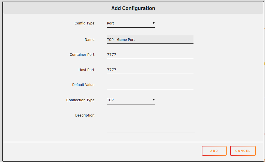

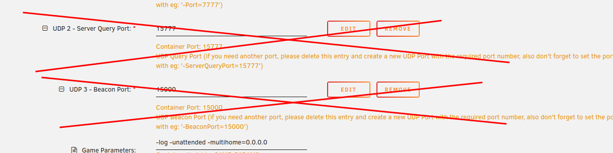

I've got a temporary workaround courtesy of Wolveix. Unraid is weird so you need to delete any old 15000 ports. Remove multihome. Then add a new port of 7777 for TCP (7777 for UDP should be included). Change network mode from bridge to host (do this at your own risk) but that fixed the API error. Seems this is ultimately a coffee stain studio issue.

the main Problem is the TCP 7777.
I use wireshark to trace this.
The server answer the syn with a rst.
I add a new port TCP 7777 and restart the server.
But it didn't work. And they doesn't show Container Port.
And yes, I use every dedicated server with "host" an an own ip address.
And -multihome=0.0.0.0 is removed.
