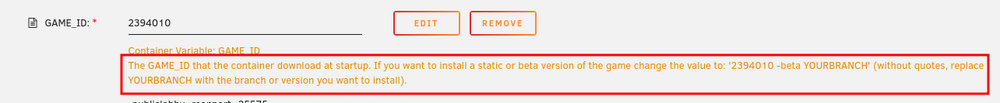

2 hours ago, lukeoslavia said:
Is there no way you could add in an environment variable to target a manifest id / game version?
Sure there is, you just have to read the description from the variables:
But I can't tell you which branch you need for that specific game version, this is something you have to figure out...

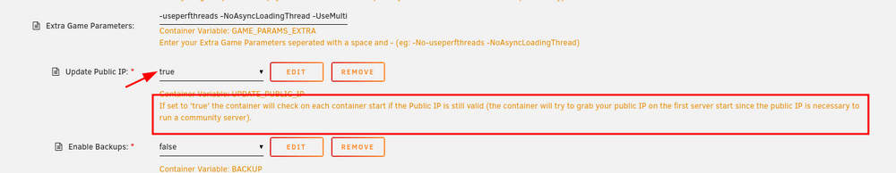

Hi there, i tried to setup a Teamspeak3 Server from ich777 but when i port forward all ports needed i still cant connect via external ipv4 only internal ip of my unraid server.
Maybe someone had the same problem and any idea how to solve it.
I tried to forward the docker ip with port through npm to my domain and log in via that but didnt work aswell.
Did you change any ports in the template? Are you sure that your Hairpin NAT is working properly? Did you yet try it from outside your local network with your public IP?
Please also double check if the protocols are forwarded properly.

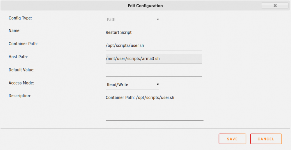

On 5/9/2021 at 12:36 AM, ich777 said:
You can always write a custom "user.sh" script and mount it to '/opt/scripts/user.sh' inside the container to install all your mods, the user.sh is executed always as root and executed before SteamCMD starts, so it should be theoretically possible to install it like this (keep in mind that the game needs to be first fully installed):
#!/bin/bash
su $USER
${STEAMCMD_DIR}/steamcmd +login ${USERNAME} ${PASSWRD} +@nCSClientRateLimitKbps 50000 +force_install_dir ${SERVER_DIR} +app_update ${GAME_ID} +workshop_download_item YOURWORKSHOPID'S_HERE validate +quit
(Please change the "YOURWORKSHOPID'S_HERE" to your Workshop ID's, that should do the job and check on every start/restart of the container if there is a newer version available)
Place the script somewhere on your Unraid server (please note you have to write this script in Notepad and not in Wordpad because it will mess up the format an Linux can't read the file) and mount it like this (in this example I have placed the script in '/mnt/user/scripts/arma3.sh', as long as you name it in your container 'user.sh' everything will be fine) :
Hope that helps.
