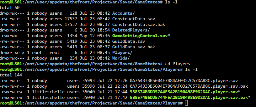

I don't have the appdata set to cache, I have a dedicated SSD in the server which is solely for docker-apps.
So the path for it is /mnt/docker-apps/appdata/ etc....
I ran the server without issue before the 1.0 update, so maybe it's something in my old config/save, which I then deleted.
Am currently reinstalling the 7d2t server again after a server reboot (took the opportunity to de-dust the interior), takes a while due to my connection 😅
I am not a native speaker, sorry if my word salad is all garbled, I hope it makes some sense....
