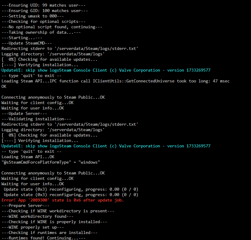

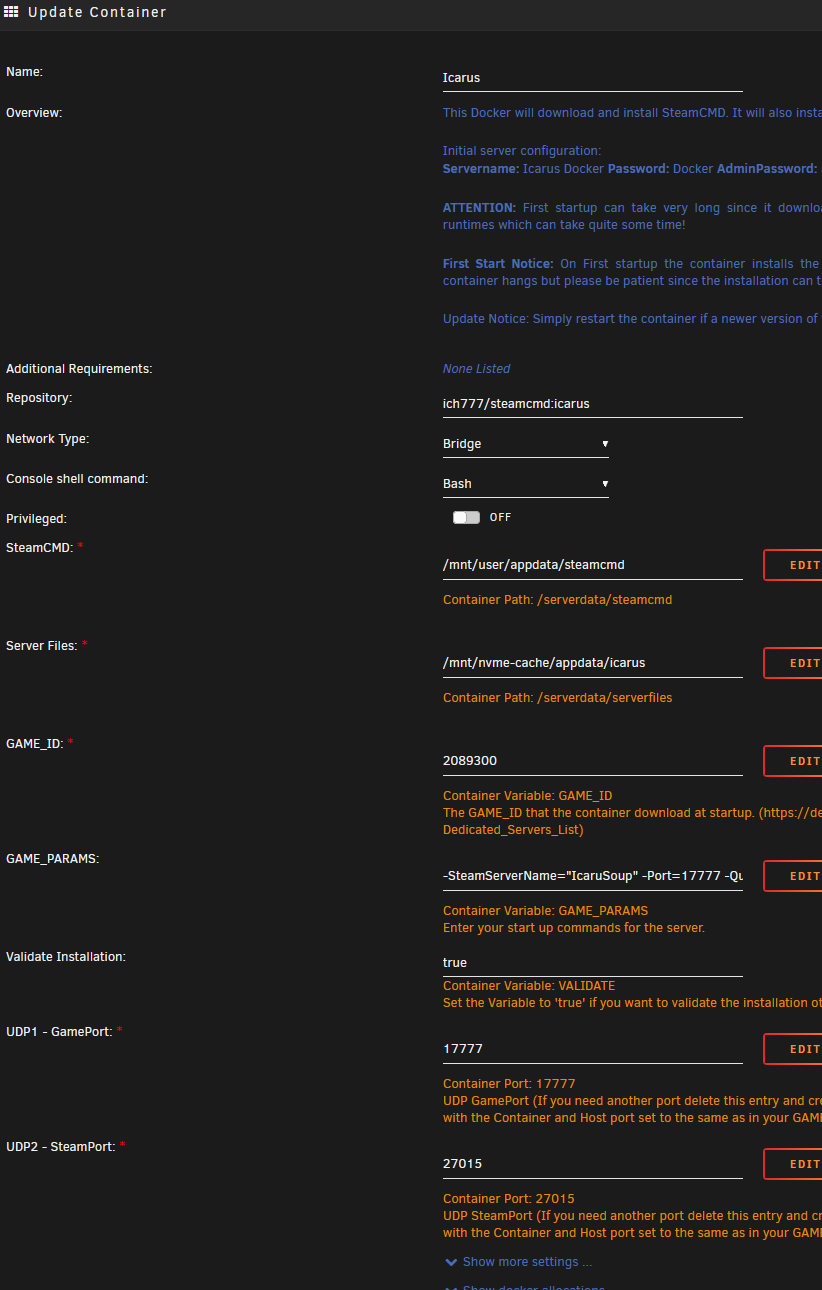

Setting Validate to `true` and restarting does not seem to verify the install13-PM-10-45-15_II_floorp.thumb.png.5c6b68157539e6fc48eaac24821a741d.png13-PM-10-44-40_IH_floorp.thumb.png.1cd4ecda8eb4b41d67eae968aecaedd4.png

It tries but as you can see you get the error 0x6 in your logs.
Please try to set the path to /mnt/user/appdata/... instead of /mnt/nvme-cache/appdata/...
What filesystem are you using on this pool and are you using exclusive shares?

Mine is set to /user/appdata and I'm getting the same issue with this latest update.
It's been working flawlessly for a month now, but nothing in my set up has changed and now this. I attempted to set the validate install to true and still same issue.
XFS filesystem non-exclusive shares.

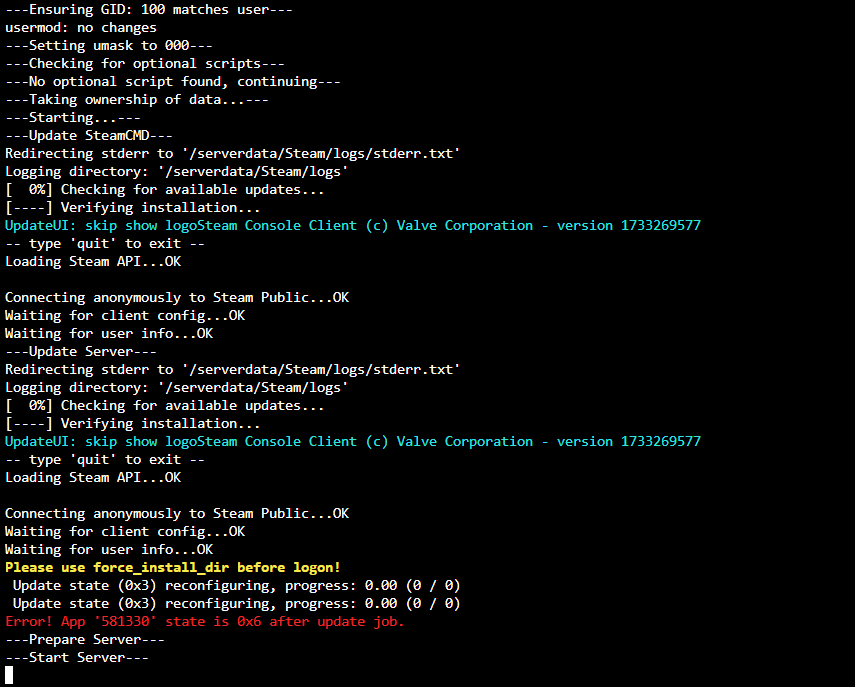

I am also having the issue with "error! app '276060' state is 0x6" after the latest Sven Co Op update. It had been working fine before when I initially set up and tested, but after the game updated recently it's been doing this. I have an XFS filesystem on both my array and my cache, with my install path being /mnt/user/appdata/. I tried reinstalling from the previously installed section under apps, as well as a fresh install of the container, and still have the issue.

I can only recommend this:
I get a few reports about 0x6 errors but it never happened to me so far, I assume there is something wrong with the storage or some kind of weird corner case happened.
To be on the safe sade do a scrub from your BTRFS pool please.
