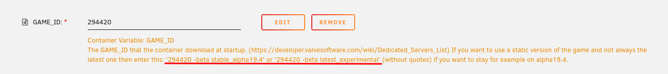

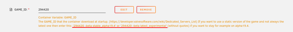

This may have been asked already, but I couldn't find it. With 7 Days to Die 1.0 releasing today, I was wondering how to go about setting up the docker to download the 1.0 version since it will be in the experimental branch.
I think the last example is what you need.
