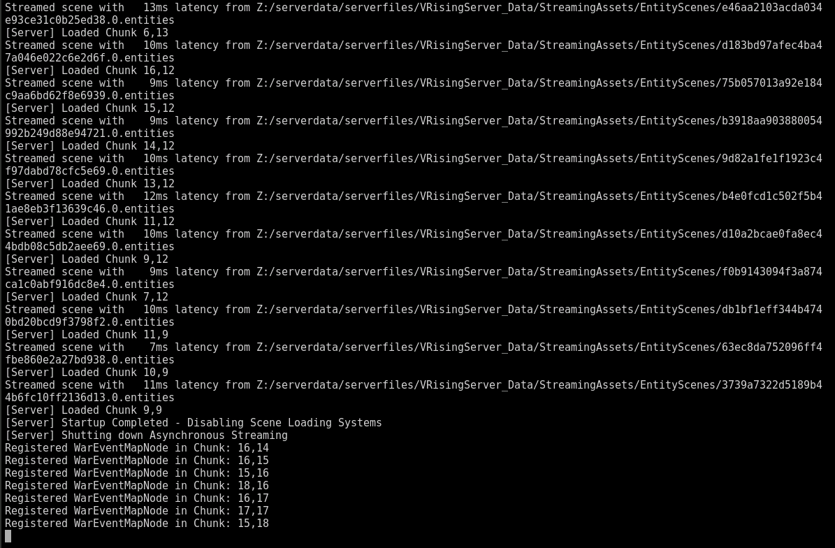

VRisingServer.logThe docker for V Rising crashes every 30-60 seconds and never finishes initializing the world. We had a world where the issue happened, we uninstalled the docker app and reinstalled it, and the issue persists.
Edited by SunlightPlatinum
This error indicates an issue with the save game itself:
PersistenceV2 - Loading save at Z:\serverdata\serverfiles\save-data\Saves\v3\world1\AutoSave_4645.save.gz.
Load SaveData - Failed to load save at path Z:\serverdata\serverfiles\save-data\Saves\v3\world1\AutoSave_4645.save.gz. Exception: System.IO.EndOfStreamException: Unable to read beyond the end of the stream.

It seems that your save game got corrupt somehow.

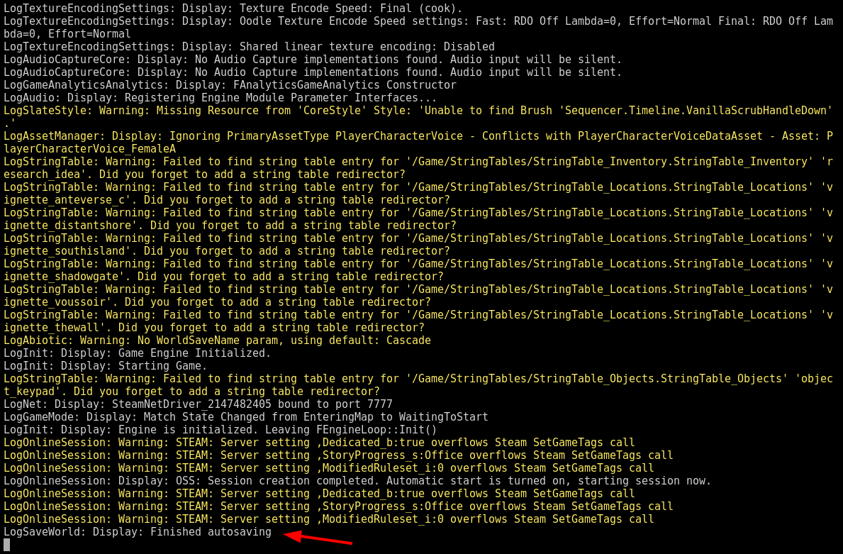

I have now tried a fresh installation on my server and it is working as expected:
2 hours ago, ourty said:
I set the Network type to Host.
May I ask why? This is not necessary at all.
It seems to just cut off in the Logs when it says Start Server and just seems to loop like this forever.
This is a indication that the container is not able to start on your system.
Have you yet tried to completely remove the container, remove the folder for abioticfactor in your appdata directory and install a copy without changing anything in the template?
I can detect the server on my Lan.
Because it's not properly starting.
It doesn't seem to properly forward or use the ports as none of the used ports show up on the Docker Dashboard like the other Containers I have show the ports.
This is only a display thing and pretty normal on most of my containers, if you are setting the container to Host mode then all ports from the container are exposed on the Host IP and because I don't define ports to expose in the Dockerfile nothing shows up <- keep in mind this is only a technical thing and how Docker works but the ports are available.
If you set it back to bridge (which I would strongly recommend) then you will see the port mappings again, why do you even set that to host?
I have now tried the container with the basic settings and everything is working:
Did you change anything else in the Docker template? A screenshot would be helpful.
Thank you, I did not know after deleting the docker the data persisted on the machine. So I have deleted the last autosave and was able to get in to the worl, but I am still worried about some Errors. I am getting a new error.:
Bridge Seemingly didn't work for one of the game servers I was trying to run with I first started using Unraid. Switching it to Host Seemingly fixed it. Truth be told I just got in the habit of using Host because of that. Checking now I can see that Bridge does seem to  work and so I have no issue leaving them on Bridge going forward.
I've deleted both folder and installed a fresh installation of the Docker. I tried it without touching anything is actually seemed to work. I changed the Server name and Password and launched it again, and it works. I can also see the server on the game's Server Browser. I Guess it was just something wrong with the initial setup of the Docker.
Thank you for your help!

1 hour ago, DevTK0 said:
The following settings don't work for vrising
Please describe a bit more in depth what you are trying to do and what you are changing where please.
The actual save data is located in .../vrising/save-data/... and not in .../vrising/VRisingServer_Data/StreamingAssets/...
I can see that the docker container copies over this file into the volume so I'm not sure if this a problem with the container or vrising itself.
The container copies over the Settings from .../vrising/VRisingServer_Data/StreamingAssets/... to .../vrising/save-data/... because the files in .../vrising/VRisingServer_Data/StreamingAssets/... are the ones which ship with the V-Rising dedicated server itself, so to speak, there is nothing I can do about the files in .../vrising/VRisingServer_Data/StreamingAssets/...
Directly changing the values in that file is not a problem but the issue is that the file is reset whenever vrising has an update.
This should not be an issue at all because the actual save path is: .../vrising/save-data/... where all the relevant Settings and save data is stored for your dedicated server.
BTW: Please also make sure that you first stop the container, edit the settings file that you want to edit and after that start the container again <- I would recommend that you do that for every game server since some will discard/revert your changes if you simply restart the container after editing setting files.
