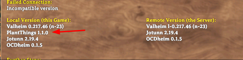

getting a weird issue where a version check is saying the server is a different version from the client.
image.thumb.png.1cbc4d669782a44cb68595476159128a.pngI am running modded, Tried to force update the container but for some reason its carring a 1- in front of it.. not sure that is actually what's breaking it but at this point it seems likely. Anyone got ideas?

I am running modded
I assume we are talking about Valheim? Maybe this is caused because it's a modded server, I really can't help with modded servers because I can only support the basic functionality.
However, have you yet tried to remove this mod from your local computer and see if it works afterwards:

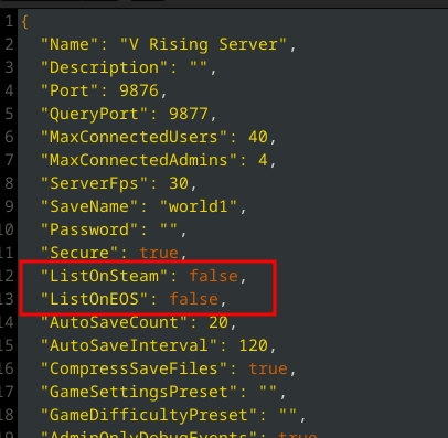

Did both of you restart the container and did the container pull the update? Are you also sure that your client is up to date?
Are both of you are sure that "ListOnSteam" and "ListOnEOS" is set to true in your game config?

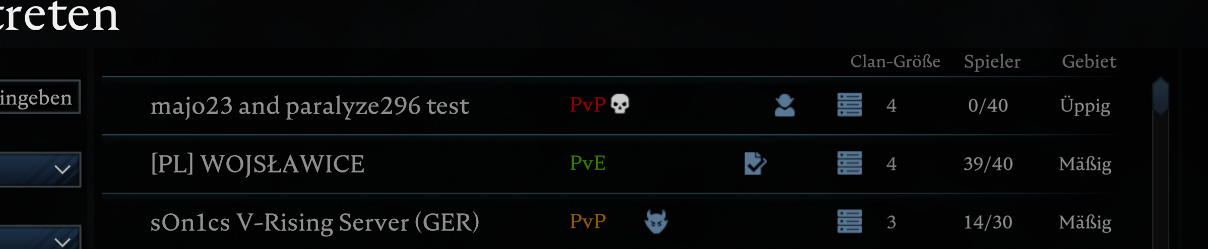

I have created a server which is visible on the list as you can see here (I already stopped it when you read this):
(as you can also see I have a character on the server because I tested if everything is working, so to speak I was able to connect :) )
33 minutes ago, ich777 said:
Everything is working over here and I can connect just fine with a fresh set up container.
Are both of you are sure that ListOnSteam and ListOnEOS is set to true in your game config?

The "ListOn..." settings were not present in the server settings I copied from the server I made on desktop, and I noticed that the desktop files used numbers for most of the settings, rather than true/false or other values.
I think I've managed to get it working by editing the default config, rather than copying the config from the file created on desktop. For some reason there was also an error with the complex password I was using, even though it was identical to what I had yesterday when I checked to ensure it was working. I might try and troubleshoot that further but probably not, to be honest.
It sure is in there after the first start from the container, are you sure you where in the correct directory? It is located at: .../vrising/save-data/Settings/ServerHostSettings.json and by default it is set to false:
