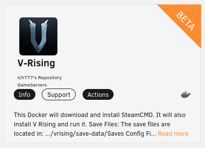

Can this docker container be used for other Steam games like "V Rising" for example ?
Sure, I already have a container for V-Rising (search for "v rising" <- with a space) :

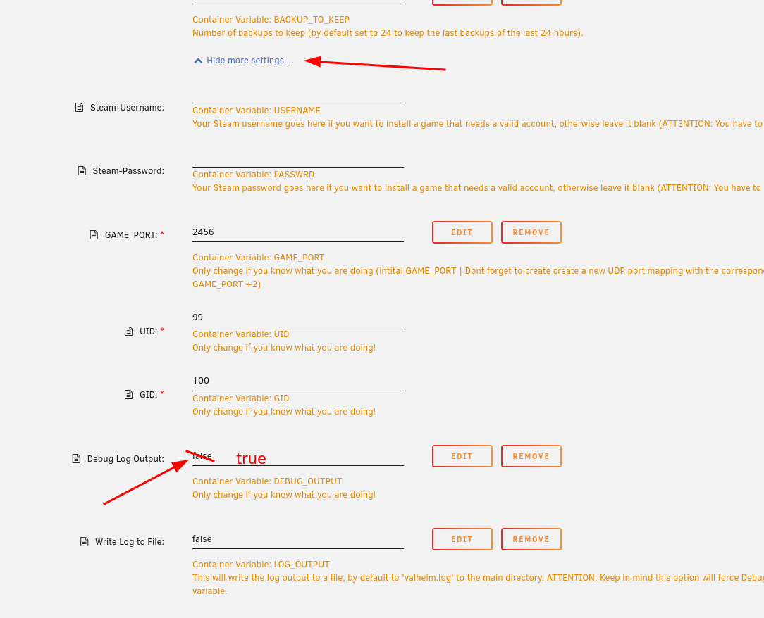

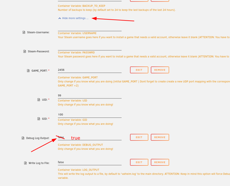

I had another question for you -- when I used to run the Valheim dedicated server on a PC, it used to print a bunch of logs on stdout / cmd prompt where I ran the server. On the Docker logs, the logs are minimal. Is there a way to turn up the verbosity ? Thanks!
1 hour ago, Houmi said:
Thanks
I hope that answers the question, but I see no reason to enable that by default:

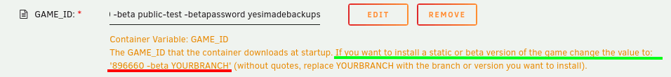

I'm trying to get the Ashlands Public test to work on my Valheim docker.
But I need to pass through '-beta public-test -betapassword yesimadebackups' .
How exactly would I do that with this docker? Thanks
Can't get RCON to connect to my Rust server.
I installed the rust docker and left everything default. Added the game parameters to enable rcon web, set the password, and also put the rcon port there just incase (default is 28017, so I left it at that). I installed Rust Admin, and also the rcon thing from the apps store. They both seem to time out when trying to connect. Docker is set to bridge mode. I tried br0 and gave it a static IP, no change.
I can connect to the server from the game and play, so I know it's online. I searched in this forum for this issue, but not seen anything that matched my issue.
Just do it like the user described it here:
You don‘t need to create the variable as described at the bottom.
Just append:
to the GAME_ID and set VALIDATE to true <- this is needed every time you switch the branch, please disable it after the validation finished.
So to speak that GAME_ID contains this:
896660 -beta public-test -betapassword yesimadebackups
This is also partially mentioned in the description from the variable:
