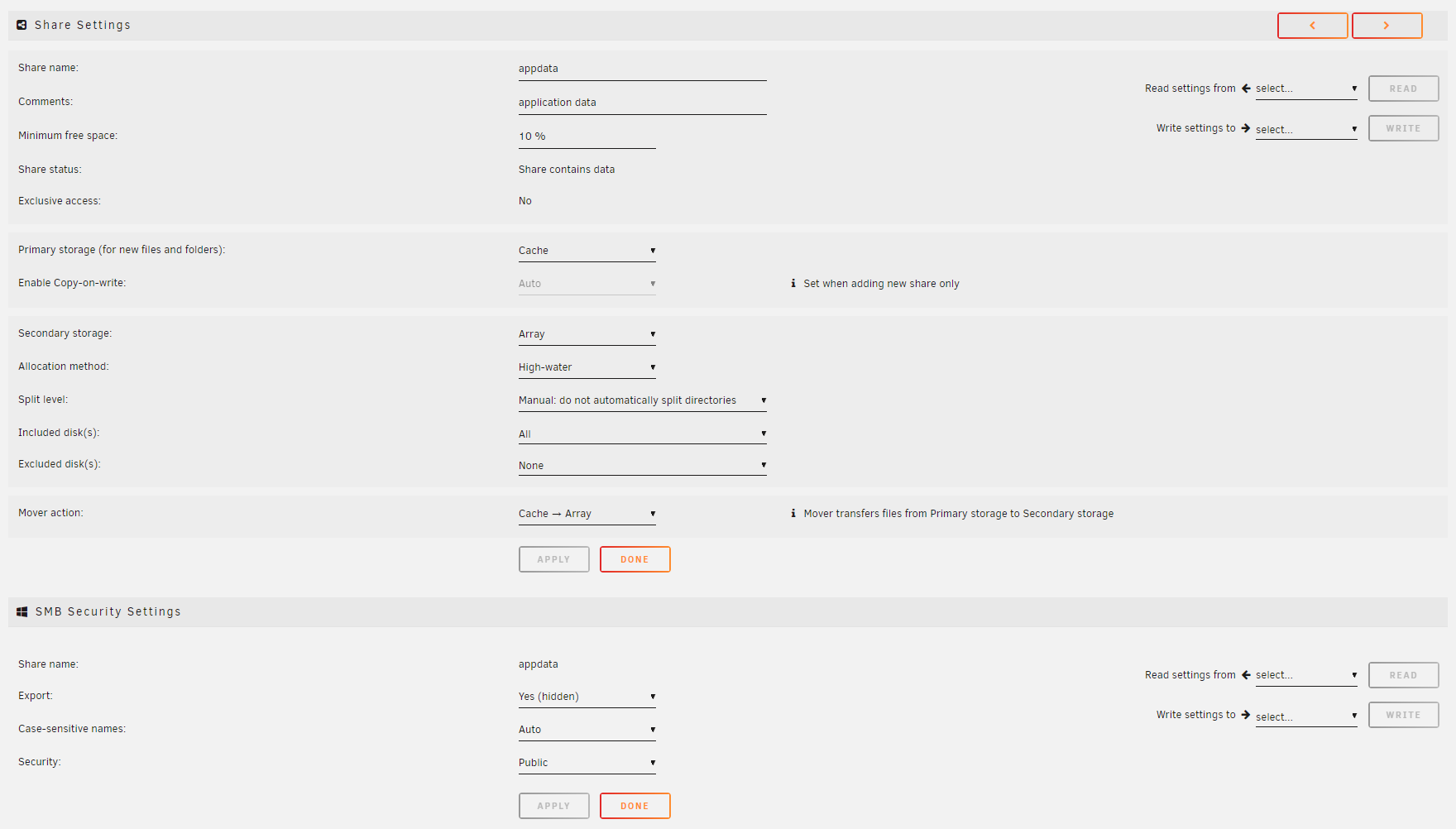

Not sure where you check that, is it here?

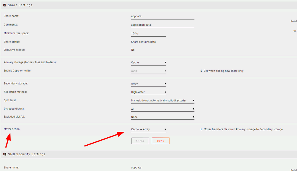

Yes:
As you can see your primary storage is set to Cache and the Secondary to Array and most importantly your Mover action is set to Cache -> Array, this means that the Mover tries to move all files from the Cache to the Array that are not in use and that will cause issues.
I recommend that you leave the appdata always on the Cache since it usually holds all your data for your containers and you want fast and snappy responses.
If you now want to move the data from the Array back to the Cache, you now have to set Mover action to Array -> Cache and invoke the Mover afterwards (I recommend Stopping all containers so that the Mover is actually able to move all the files back to the Cache) and wait for it to finish. After that you can set the Secondary storage to None to ensure that the files will stay on the Cache and the Move is not invoked at all.
Ok, I have made that change, and manually started the mover. I trust I should change my container template to cache on both
items, rather than user?

It is well enough to leave the game files path at /mnt/cache/... since some games have issues with the FUSE file path /mnt/user/...
You can leave the SteamCMD path as is since it will work no matter to what you set it.
Gotcha. games files reset to /mnt/cache, mover running. WIll wait for it to finish and hope for the best! Thank you very much for your time, I greatly do appreciate it.

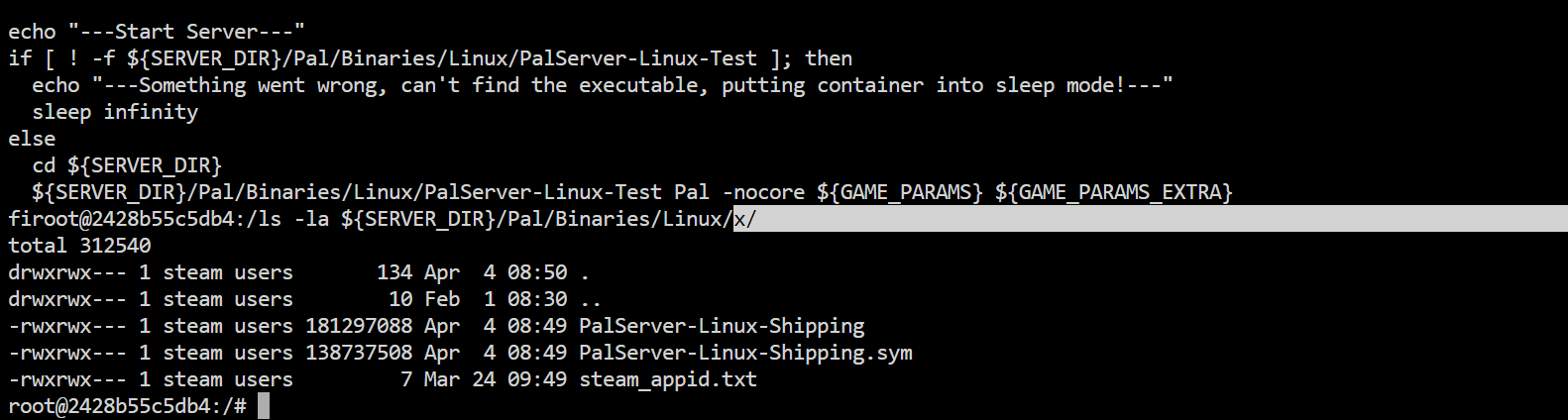

9 hours ago, ich777 said:
Can you please share a screenshot from your Docker template within Unraid?
Do you use /mnt/user/... or /mnt/cache/... in the template for the game files. If you are using /mnt/cache/... just make sure that the share stays on the cache and is not moved to the Array in the Share settings.
Please open a container terminal (while the container is running) and execute:
tail -n 10 /opt/scripts/start-server.sh
ls -la ${SERVER_DIR}/Pal/Binaries/Linux/
and post the output here.
I am getting the error "cant find executable, putting container to sleep" here is my output to the commands above: image.thumb.png.f2c2ab61cbbe1a84f73cef04a79bbeaf.png
Again, please read that post:

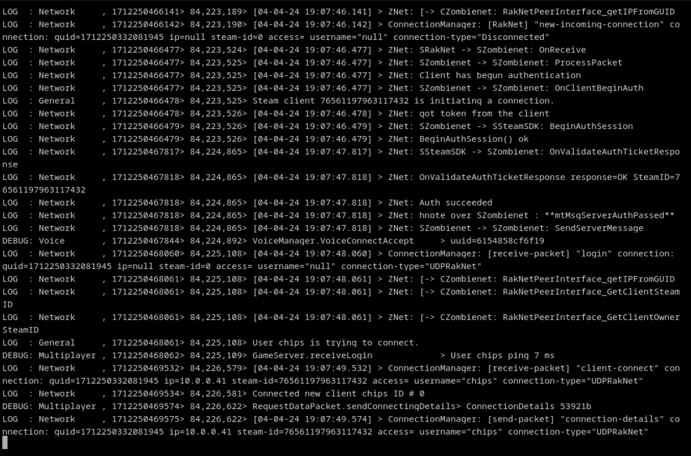

10 hours ago, Waneng said:
Thank you for that, but I am not sure what you are asking.
I can't reproduce this...
With the default configuration it just works, this is my log where you can see that I can connect just fine:
Are you really sure that NAT Reflection is working correctly on your end. As you can clearly see I only tested this with my local IP but I just entered my servers IP in IP as you can see here:
Please also note that I didn't change anything, just deployed the container.

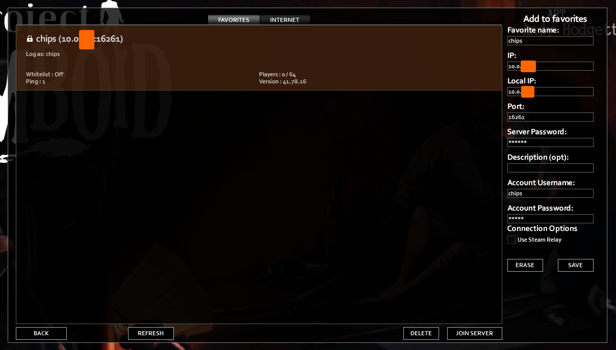

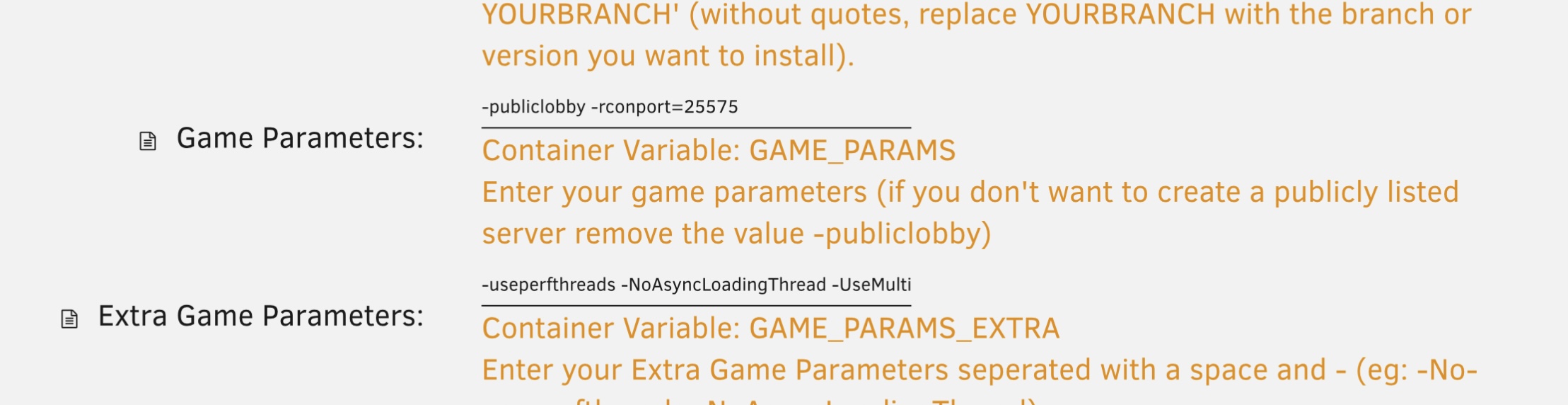

Does anyone have their Palworld server running on Unraid with the ICH777 community app container and have figured out how to make it a community server? I think I just need to add -publiclobby to the startup arguments, but I do not see where I would put that in the container config
Edited by mrcollin101
Do you see it:
OK, my mistake, I used both WAN and LAN IP when I tried connecting with LAN last time, and I did successfully join the server this time.
So, the server is running well, should I try opening some other ports for it to work? Do you have any suggestions? Like IP passthrough? Because it is still not responsive via WAN ip.
Btw I am using a AT&T fiber router, maybe you encounter other people have similar problem with this router.
Can somebody outside your LAN try to connect? If NAT Reflection isn‘t working on your Router then you won‘t be able to join the dedicated server with your public IP from your LAN.
Yes, all the ports which are listed in the Docker template with the corresponding protocol.
Delete the Saved folder in the Pal directory this should fix the issue, unfortunately your savegame is lost after you do that.
After some sleep, I moved the Saved folder to my desktop, and it is still looping like before.
