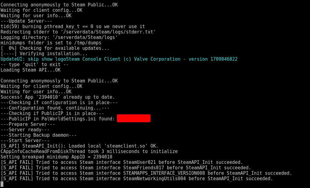

Hello! I've been using your Pal World Docker for a while now, and love it. However, tonight when I restarted it(because of the patch) I got this in the logs:
Connecting anonymously to Steam Public...OK
Waiting for client config...OK
Waiting for user info...OK
Success! App '2394010' already up to date.
---Checking if configuration is in place---
---Configuration found, continuing...---
---Checking if PublicIP is in place---
---Nothing to do, PublicIP: xxx.xxx.xx.xxx still up-to-date!---
---Prepare Server---
---Server ready---
---Starting Backup daemon---
---Start Server---
---Something went wrong, can't find the executable, putting container into sleep mode!---
Any helpt o get back up would be appreciated! I did run a force update on the docker, to see if that was the issue, but no such luck. I have rebooted the Unraid PC as well, no joy. I don't know what directory/filename its looking for for the executable to see if its really missing or the update moved it, etc. Thank you!

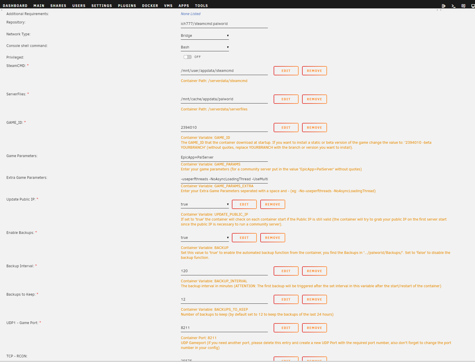

Can you please share a screenshot from your Docker template within Unraid?
Do you use /mnt/user/... or /mnt/cache/... in the template for the game files. If you are using /mnt/cache/... just make sure that the share stays on the cache and is not moved to the Array in the Share settings.

Here is the second, not sure exactly what you mean by Docker template, so here is my guess:

[2024.04.04-07.08.55:894][  0]CrashReportCoreLog: Sending HTTP request: https://o1291919.ingest.sentry.io/api/6513339/unreal/4a1a3921f51f4975b4cf8dd19022cb20/?AppID=CrashReporter&AppVersion=5.1.1-0%2B%2B%2BUE5%2BRelease-5.1&AppEnvironment=Release&UploadType=crashreports&UserID=-00000063%7C%7C
[2024.04.04-07.08.56:108][  0]CrashReportCoreLog: OnProcessRequestComplete(), State=SendingFiles bSucceeded=1
[2024.04.04-07.08.56:108][  0]CrashReportCoreLog: State change from SendingFiles to SendingFiles
[2024.04.04-07.08.56:108][  0]CrashReportCoreLog: All uploads done
[2024.04.04-07.08.56:108][  0]CrashReportCoreLog: State change from SendingFiles to Finished
[2024.04.04-07.08.56:916][  0]CrashReportCoreLog: Final state (Receiver) = Finished
[2024.04.04-07.08.56:916][  0]CrashReportCoreLog: Final state (Receiver) = Unknown UploadState value
[2024.04.04-07.08.56:916][  0]LogCore: Engine exit requested (reason: CrashReportClientApp RequestExit)
[2024.04.04-07.08.56:916][  0]LogExit: Preparing to exit.
[2024.04.04-07.08.56:919][  0]LogExit: Object subsystem successfully closed.
[2024.04.04-07.08.56:919][  0]LogModuleManager: Shutting down and abandoning module HTTP (12)
[2024.04.04-07.08.56:928][  0]LogModuleManager: Shutting down and abandoning module SSL (11)
[2024.04.04-07.08.56:929][  0]LogModuleManager: Shutting down and abandoning module CrashDebugHelper (8)
[2024.04.04-07.08.56:929][  0]LogModuleManager: Shutting down and abandoning module CoreUObject (6)
[2024.04.04-07.08.56:929][  0]LogModuleManager: Shutting down and abandoning module PakFile (4)
[2024.04.04-07.08.56:929][  0]LogModuleManager: Shutting down and abandoning module RSA (3)
[2024.04.04-07.08.56:933][  0]LogExit: Exiting.
Shutdown handler: initalize.
Disabling core dumps.
dlmopen steamservice.so failed: steamservice.so: cannot open shared object file: No such file or directory
[2024.04.04-07.08.53:858][  0]Error: CDO Constructor (PPSkyCreator): Failed to find Texture2D'/Game/PPSkyCreator/Textures/Icons/T_PPSkyCreator_BillboardIcon'
[2024.04.04-07.08.53:858][  0]Error: CDO Constructor (PPSkyCreator): Failed to find Texture2D'/Game/PPSkyCreator/Textures/SkySphere/TC_PPSC_StarMap_4K'
[2024.04.04-07.08.53:858][  0]Error: CDO Constructor (PPSkyCreator): Failed to find Texture2D'/Game/PPSkyCreator/Textures/Occlusion/RT_PPSC_WorldHeightmap'
[2024.04.04-07.08.53:858][  0]Error: CDO Constructor (PPSkyCreator): Failed to find Texture2D'/Game/PPSkyCreator/Textures/WeatherMaterialFX/RT_PPSC_RainRipples_Normal'
[2024.04.04-07.08.53:859][  0]Error: CDO Constructor (PPSkyCreator): Failed to find Texture2D'/Game/PPSkyCreator/Textures/WeatherFX/RT_PPSC_LightningParameters'
Just now, zanth said:
Well, its not working, but its doing something different now. It's now looping starting the server, gives a bunch of yellow text, then starts over.
That's caused because a corrupt save game most likely because it was basically using two different paths and the mover was moving files that should belong on the cache.
Have you yet checked to what your appdata share is set where the files should belong and if they are moved to the Array?
Not sure where you check that, is it here?
Yes:
As you can see your primary storage is set to Cache and the Secondary to Array and most importantly your Mover action is set to Cache -> Array, this means that the Mover tries to move all files from the Cache to the Array that are not in use and that will cause issues.
I recommend that you leave the appdata always on the Cache since it usually holds all your data for your containers and you want fast and snappy responses.
If you now want to move the data from the Array back to the Cache, you now have to set Mover action to Array -> Cache and invoke the Mover afterwards (I recommend Stopping all containers so that the Mover is actually able to move all the files back to the Cache) and wait for it to finish. After that you can set the Secondary storage to None to ensure that the files will stay on the Cache and the Move is not invoked at all.
