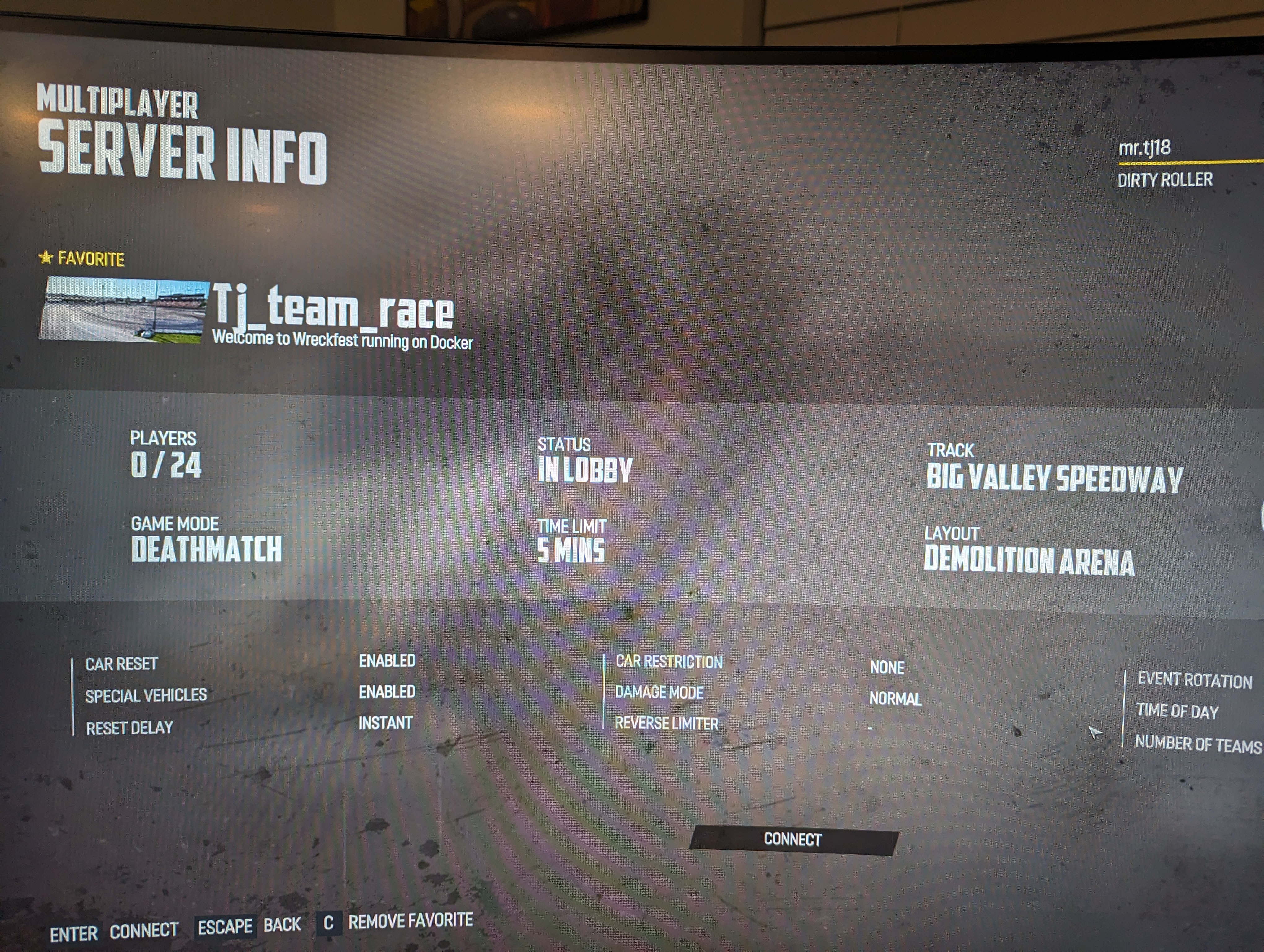

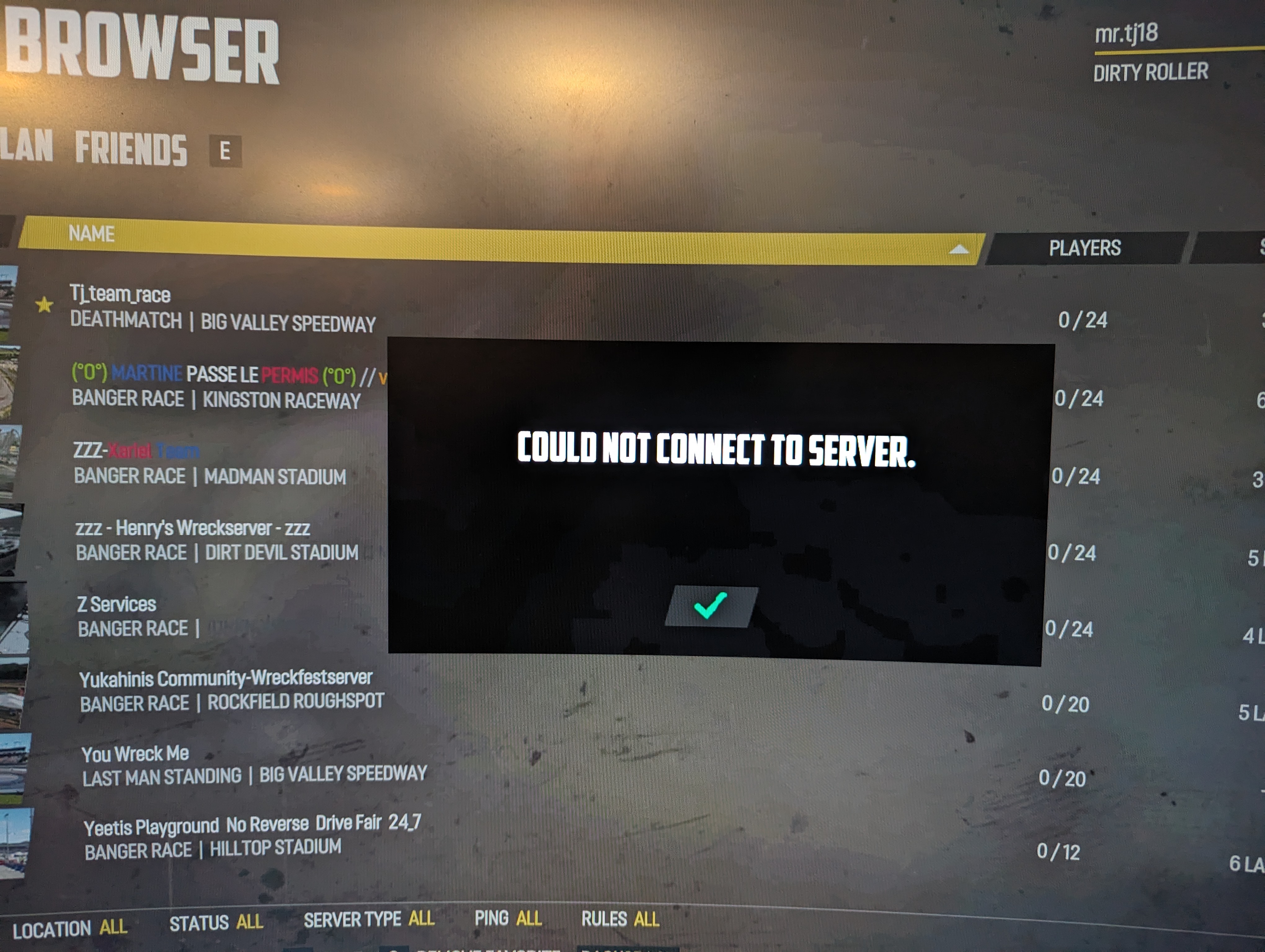

11 hours ago, ich777 said:
Exactly, the container should work fine right OOB, ports 27015, 27016 and 33540 UDP are needed for the game to work properly.
After the first full startup stop the container, then edit the file server_config,cfg and change the name to whatever you like, start the container again and wait about two minutes and refresh the in game server list and see if you can spot your server on the server list.
In general it should work right OOB but since someone put a server out there with the default name and a different password it's a bit confusing... :D
Looks like a no go for me still. Changed my router settings to the correct ports, changed my settings for the server_config.cfg and still can't connect. With or without the password parameters on the server config. Maybe my ISP is blocking the 33540 port.
Is the server still open and available in the server list with the default password?
I'm assuming that you are trying to connect from inside your network correct? If you want me to I can try to connect, maybe it's a Hairpin NAT (NAT reflection) issue.

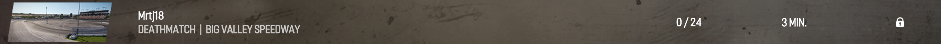

Is the server open and available on the server list? Yes
Does the server use the default password? No I removed the password requirement. It's open to anyone
I am trying to connect from within my own network. I have attempted to connect using my cellphone data so I'm off my local network. But I have had the same issue.
I will try to connect when I got home from work (in about 5 to 6 hours).

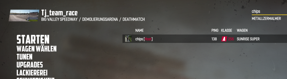

No issue over here:
Are you able to connect through the LAN tab to your server to work around that you can't join.
I think your issue is NAT reflection. If you are on pfSense or OPNsense you have to configure it that it works properly.
4 hours ago, ich777 said:
No issue over here:
I don't have pfsense or anything like that running on my network. Only thing I have running is pihole to block ads. And I have my server i.p. whitelisted with pihole so it does not interrupt unraid services I have running.
The server is only visible on my Internet tab. Nothing appears in my lan section. So the Internet section is the only way I can attempt to connect.

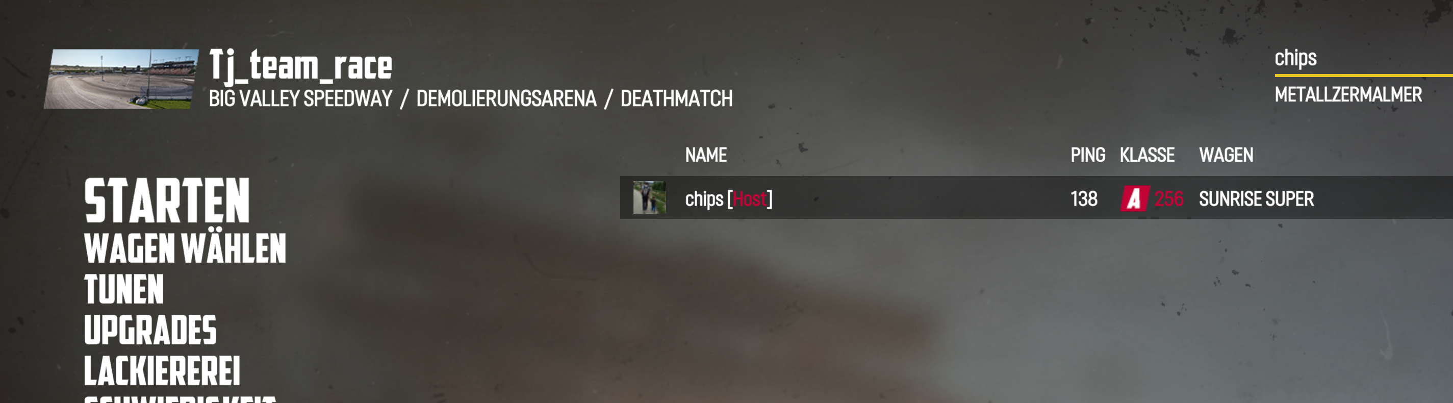

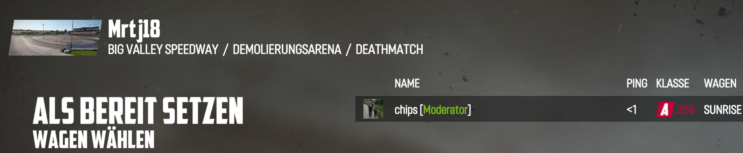

Sorry but then something is most likely wrong on your network, the server should show up in the in game server browser in your LAN if you've left the ports at default.
I can connect fine from over here to your server as shown in the screenshot above...
