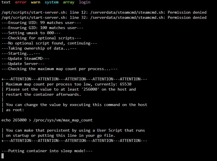

Hello, you say that it is easy to configure a server for any game with your templates but I have not been able to successfully run any of the 4 servers that I have tried, is there a document that explains step by step what each of the docker options is for? ? Now I'm trying the ark-sa server but it doesn't even start because I have to enter a command that I don't even know where to do.
On the other hand, it doesn't let me enter the steam ward code and when I try to enter any command in the console it tells me that I have the file system in read-only.
It also does not say where the scripts are to make the command that must be entered persistent: "echo 265000 > /proc/sys/vm/max_map_count"
In the docker edition I don't know if in "console" I have to put bash or shell...
I'm more lost than an octopus in a garage
thank you
Which ones?
It is easy in general, only a few containers need extra steps like Ark-SE
You can usually run all other container without changing anything in the template itself.
I think the description in most of my containers at the variable should tell what to do.
I don't understand. You don't have to enter Steam Credentials, they are only needed when they are marked with the red asterisk in the template and not hidden away at the "Show more..." section.
Just open up a Unraid terminal and execute this command, then restart the container and it should work (you have to do this after each reboot of the Unraid server).

Thanks for answering, the truth is that I don't know how but I have already managed to get the server to start, but I need the server to start automatically in the event of a power outage or an unraid restart, how do I configure the script so that there are no problems? I don't remember now which servers I tried to start, but I think they were conan exiles, dayz and some others thank you
edited: I think I have already found it, in the settings/user scripts section, add script and save, I have restarted unraid and it seems to start by itself, thanks again

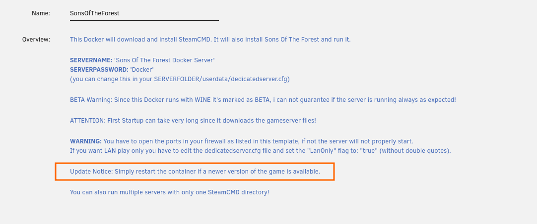

ich777 when You are planing upload update for sons of the forest?
Why should I? Is something not working?
Have you read the description from the container:
My containers are self maintaining and they check for updates on each start. :)
Hello. Yes i know. It seems that auto update not working. I am not seeing it in log during start. Sons of the forest is after huge update. When I am trying to connect after this update to server I am receiwing log like bellow: #DSL Incoming client connection with auth ticket

Ok I know why i had problem with update. Update during restart is not working when I am log in to steam account. Maybe cause this account have not in library sons of the forest game:) Now everything is working.
You don‘t even need to add Steam Credentials to the container template.
PLEASE ONLY ADD STEAM CREDENTIALS IF THE ARE MARKED WITH THE RED ASTERISK IN THE TEMPLATE AND ARE NOT HIDDEN AWAY AT SHOW MORE.
Thank You very much for information:)
