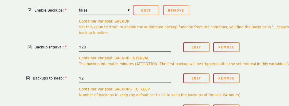

Hello. i have a palworld server using the docker. Is there a way to backup the save data? like all the relevant data for the world, saves and players. What would i do to back up this sort of data? is it as easy as just making a copy of the directory folder? is there a way to automate it? unraid newbie.
Do you have these options in the template:
If not then please read this post:
