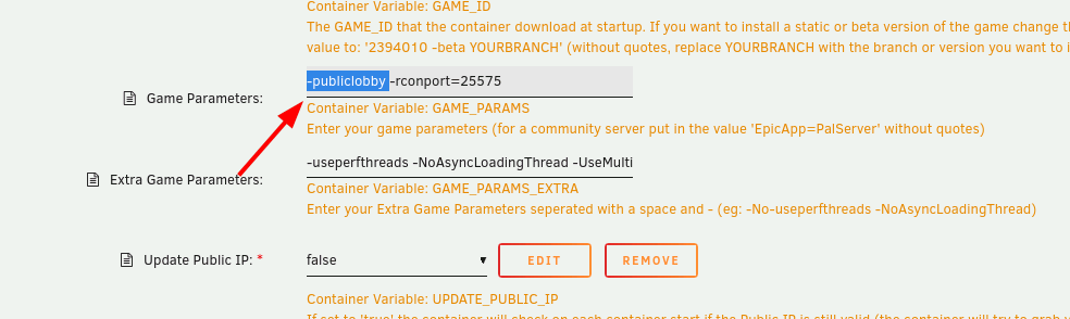

Currently all Servers seem to be fully operational yet I cant find my Server via the server list. There isnt any other port to open besides 8211 for Palworld, right?
Connecting via IP is working fine.
Correct.
Are you sure you've enabled the correct options, please keep in mind that it maybe takes a bit so that your server shows up in the server list since it can take a while.
Please also check if you already have the new parameter in place since the last update changed this here:
1 minute ago, ich777 said:
Correct.
Thank you so much for the fast response! It was the "publiclobby" parameter! Is the "EpicApp=PalServer" still needed?
Nope. This was the method before the last update from Palworld, now it's -publiclobby
