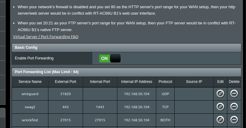

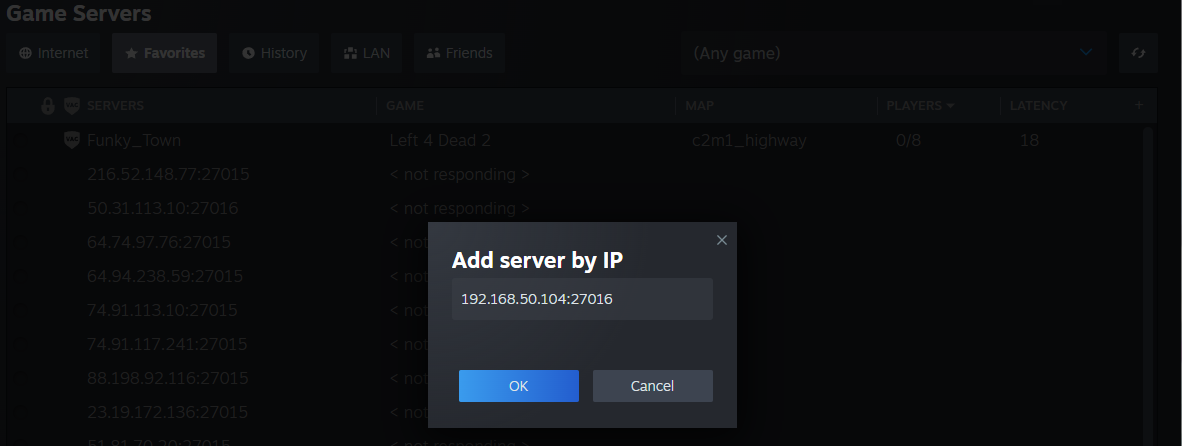

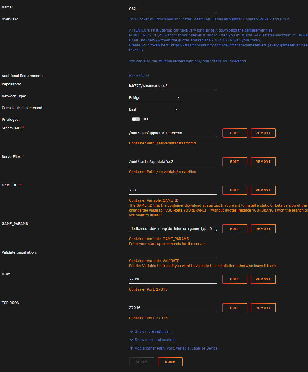

Please see attached for my docker setup template, ingame server brower (when i attempt to connect to the server) and a screenshot of my ports.
Once again i have l4d2 running just fine on the default 27015. But attempting to get cs2 to work on anything other than 27015 does not work. I get an error message saying cannot connect to server
You changed the port in the template but you changed it no where in the server config, so to speak that can't work...
Please append that to the GAME_PARAMS:
-port 27016
Source: https://developer.valvesoftware.com/wiki/Counter-Strike_2/Dedicated_Servers
You always have to tell the dedicated server too on which port it is running because like you've done it now it simply can't work because you've forwarded the port 27016 (from inside the container, where the dedicated server is still running on 27015) so to speak the forwarding in the Docker fails... and yes, I know this is a bit complicated but otherwise it won't work.
Always make sure to first change the ports in the container config, then delete the old ports from the template and then create new ones with the ports that you've set in the config for the dedicated server.
Hope that helps, makes sense and explains it a bit more.

Wow that did the trick never added the port number on the GAME_PARAMS.... Thank you!!

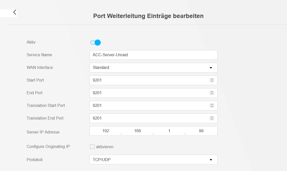

Hi ich777. Do you have any tips for what the easiest way would be to install libicu / icu-libs / libicu-dev for the CS2 image?
I'm trying to get CounterStrikeSharp (https://docs.cssharp.dev/docs/guides/getting-started.html) to work on my server so I can add a plugin to my server. My server crashes on startup with the following message:
Process terminated. Couldn't find a valid ICU package installed on the system. Please install libicu (or icu-libs) using your package manager and try again. Alternatively you can set the configuration flag System.Globalization.Invariant to true if you want to run with no globalization support. Please see https://aka.ms/dotnet-missing-libicu for more information.
So I want to add the package as it says in the troubleshooting info in the CounterStrikeSharp docs, but I don't fully know how I would go about doing it.
The package is now part of the container, please update the container itself and see if it is working.
It's working! Thank you very much.

Sorry, I have one last question, the wreckfest server I have running, everything is default. No Port changes added or mods. But I cannot connect to the server no matter what I try.
Even deleting the game folder, and docker container and starting from scratch. Still won't allow me to enter my server. Am I missing something?
Did you forward the ports in your Firewall?
It needs to be available to the internet, at least from my experience, so that you actually can connect.
yes I even opened the ports on both ends as you can see on the picture attached. I opened 27015,27016, and 33540. Still a no go. I can connect to other people's server on the server list but not my own.
Thanks
The first thing that I noticed is that you forwarded both ports TCP and UDP… Why?
Please only forward only the port with the protocol in the template.
Did you change other things too andything special in the config or in the template?
Please try to start over.
Delete the container, delete the folder for wreckfest in your appdata directory, pull a fresh copy from the CA App and try to connect.
Please not that it can take a few minutes before it appears in the in game server list.
