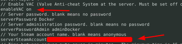

On 3/31/2024 at 6:35 PM, RomanRichter said:
Hello!
I got this strange behavior from The Forest server container:
It never authorizes with serverSteamAccount *MyGeneratedToken* in container template (I think it don't pass it, or don't use it), only if token explicitly set in config.cfg.
Any help, please? At least direction where to dig?
When I set "GAME_PARAMS serverSteamAccount *MyToken*" it start's server anonymously:
GameServer init success. Port: 27015
Set a LogOnAnonymous
Connected to Steam successfully
The Forest Server is not VAC Secure!
Game server SteamID:901***
When I put my token in config.cfg
Set a Logon
Game server SteamID:855***
Edited by RomanRichter

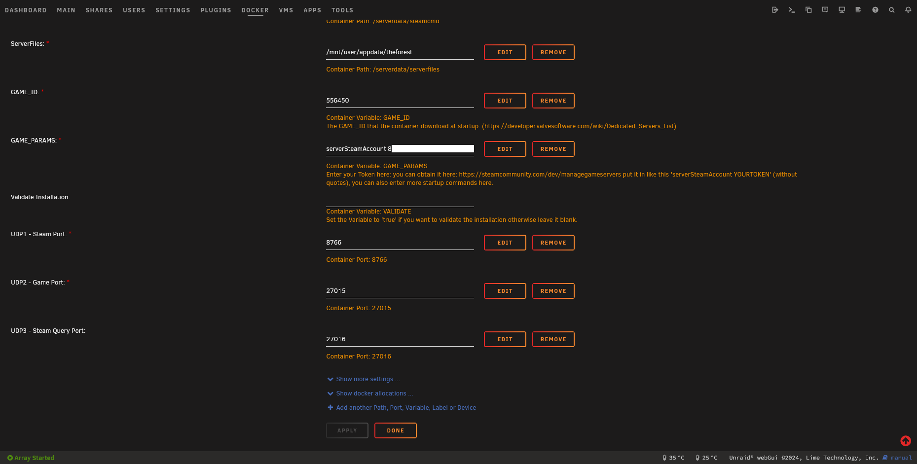

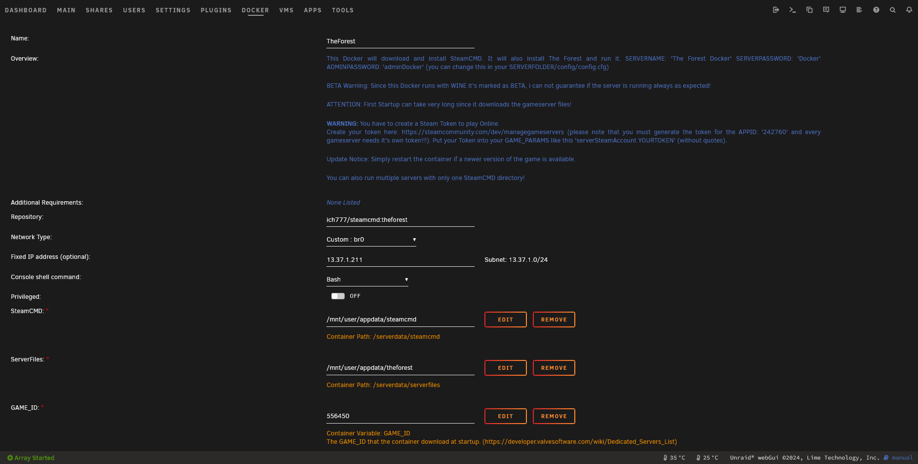

49 minutes ago, RomanRichter said:
Any help, please?
Sorry, I completely overlooked your post.
Can you please post a screenshot from your template (maybe blur the token).
May I ask for what Game ID did you create the token?
No problems :)
242760, also tried 556450 just for testing (also tried change appid in steam_appid.txt).
27 minutes ago, RomanRichter said:
No problems :)
Sorry, I can't help here since the documentation here also says that you can enable VAC with:
enableVAC on
I think you have to set those values now in the config.txt (please be sure to do that also in the config file).
EDIT: I just tried it on a fresh installation and it is working perfectly fine:
Make sure to change these two lines:
The file is located: .../theforest/config/config.txt <- please make sure to stop the container first and then edit the file.
enableVAC on
Oh, so I supposed to manually set token in config.txt?
I done that already (put token in config.txt), and it works without enabling VAC (I don't need VAC, server for me and my friends).
My problem is that server logons only of I put token in config.txt, but doesn't logon if I put token in GAME_PARAMS, I was expecting that it will work otherwise.
Maybe they changed it again, I have already changed the description from the container so that it says to put the server token in the config.txt
If you don't need VAC then don't enable it.
