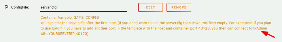

for fivem docker can we add txadmin on it ?
Have you read the description?
Just remove the server.cfg from GAME_CONFIG and create another TCP port with the container and host port set to 40120 and click apply, afterwards you can connect to txAdmin.
