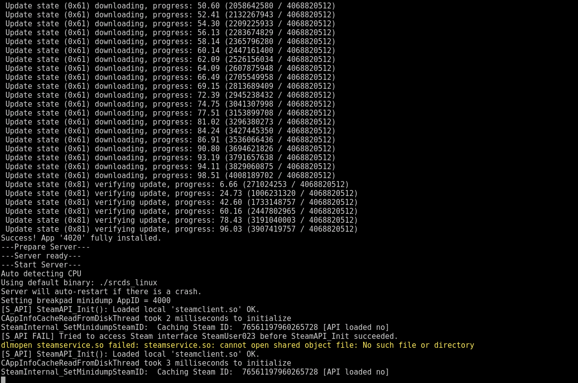

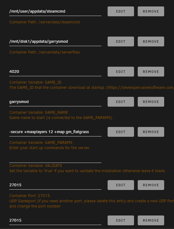

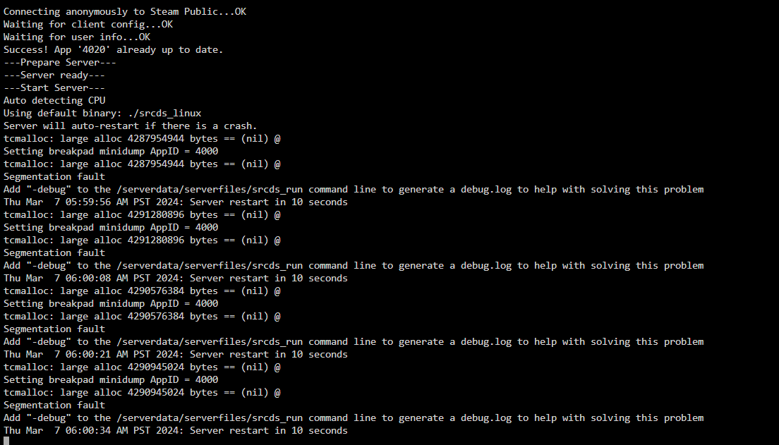

Hello im having trouble hosting a gmod server, everytime i start it gives me this error
"Add "-debug" to the /serverdata/serverfiles/srcds_run command line to generate a debug.log to help with solving this problem
Tue Mar  5 03:27:22 PM PST 2024: Server restart in 10 seconds
tcmalloc: large alloc 4294443008 bytes == (nil) @
Setting breakpad minidump AppID = 4000
Segmentation fault"
Segmentation fault"
And did you add -debug to the run command and generate the debug.log?

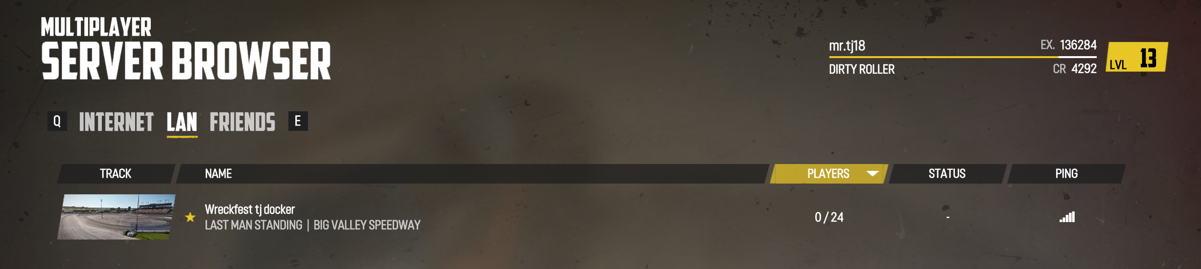

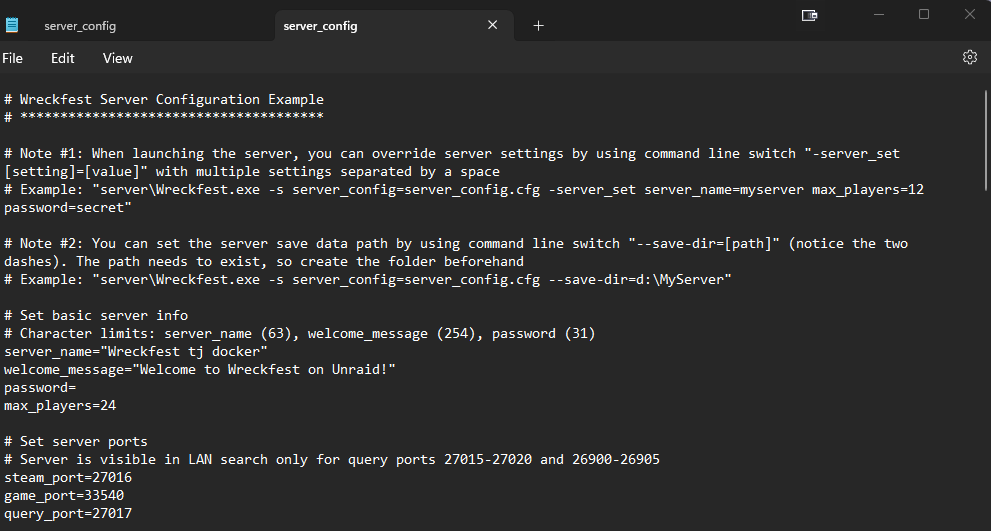

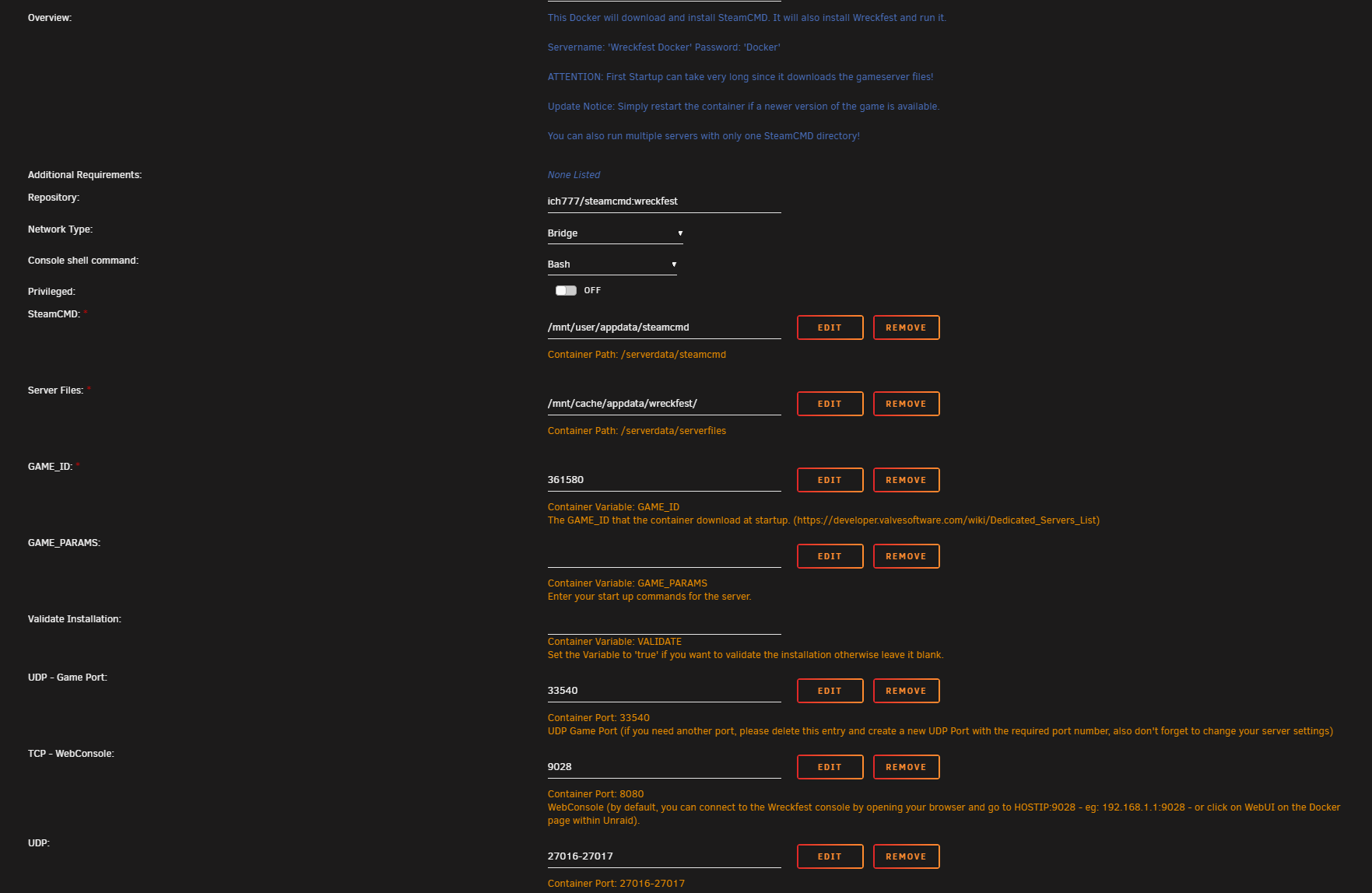

Howdy back again with more questions unforteunatly.
I have a steam server running left4dead2 on the default port mappings. And everything is great, people are able to join and have a good time.
Now I am attempting to set up a Wreckfest server and I had to change the default ports because l4d2 already uses 27015. So i changed the default ports to 27016 and 27017. The wreckfest server is visable Lan side but not on the Internet side. Plus I cant join even on the lan side. Any help would be appreciated.
Thanks!

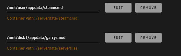

To what are the paths set in your template?
Gmod is one server that needs the real file path to your game files so to speak /mnt/cache/... or /mnt/disk2/... and not the FUSE file path /mnt/cache/...
If you however use /mnt/user/... it will segfault indefinitely.

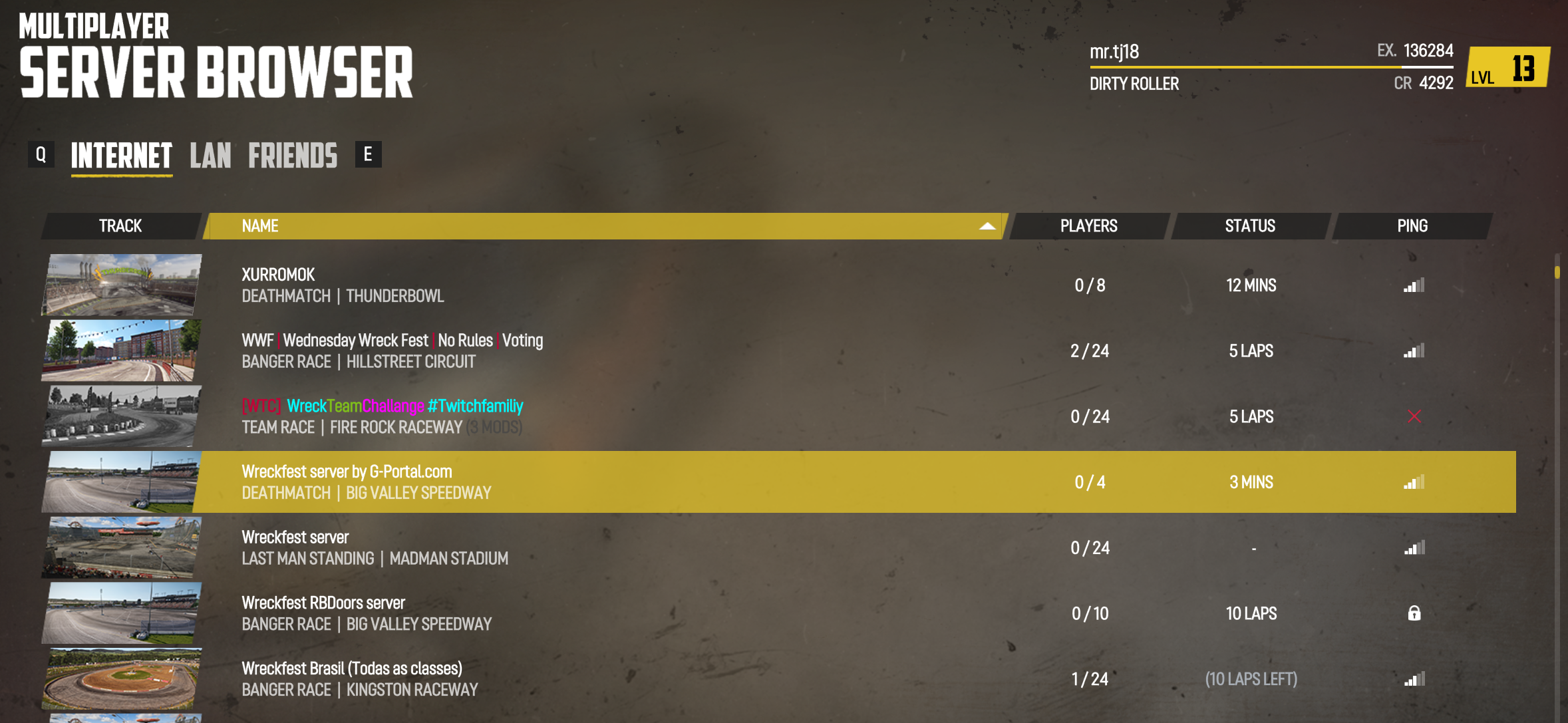

I know that issue but I haven't figured out why this is the case for Wreckfest since it seems that even if you change the ports and forward them correctly in the template that Wreckfest won't accept the change and somehow you won't be able to connect, to circumvent that I change the ports from other game servers to be able to run Wreckfest, I also have to say that they changed quite a lot since I've created the server and it is now maybe possible to change the ports.
IIRC Wreckfest is one game that needs to be reachable from the outside world so that you can join even if you want to join a LAN game (but I'm not 100% sure anymore about that).
If you want to I can try it when I got home from work because I have still installed the dedicated server but only start it if I play with some friends on it.
EDIT: If you want that the game honors the server_config you have to enter that IIRC at GAME_PARAMS:
-s server_config=server_config.cfg
(but I haven't used a server_config.cfg in a long time and don't quiet remember exactly)
Should i change the upper one ?
Edited by Zamki

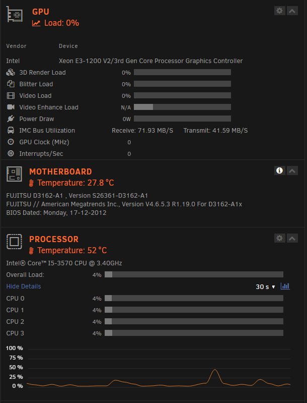

No, the lower one, are you sure that everything is located on disk1?
Have you changed anything else in the container template?
On what hardware do you try to run the container?
8 minutes ago, Zamki said:
That's strange, I try the container tomorrow and report back if it is working as expected on my machine.
I tried the suggestion and i could not get two seperate games that use steam's 27015 port to work. The only time either game would work, is if i left the default ports alone. Or run one game server L4d2 or Wreckfest at a time, not both. If you could manage to get two steam dockers that intaially use 27015 port to work please let me know!
I also tried running a cs2 container and could not get that to work either. Just incase wreckfest was being picky and it was a no go.
Thanks for all your help!
Edited by Mrtj18
Have you tried using 27016 or 27017 and so on for additional servers? you can't have multiple servers using the same query port. Also not you need to delete the entry in the template and re add the port with the new number.
It would be really beneficial to know what you've did and how you've set everything up? Do you have screenshots and snippets from your config?
For example on my server I have a CS:Source server on port 27030 and a CS2 server on port 27029 Wreckfest is running on the default ports 27015 and 27016 (all ports listed are UDP).

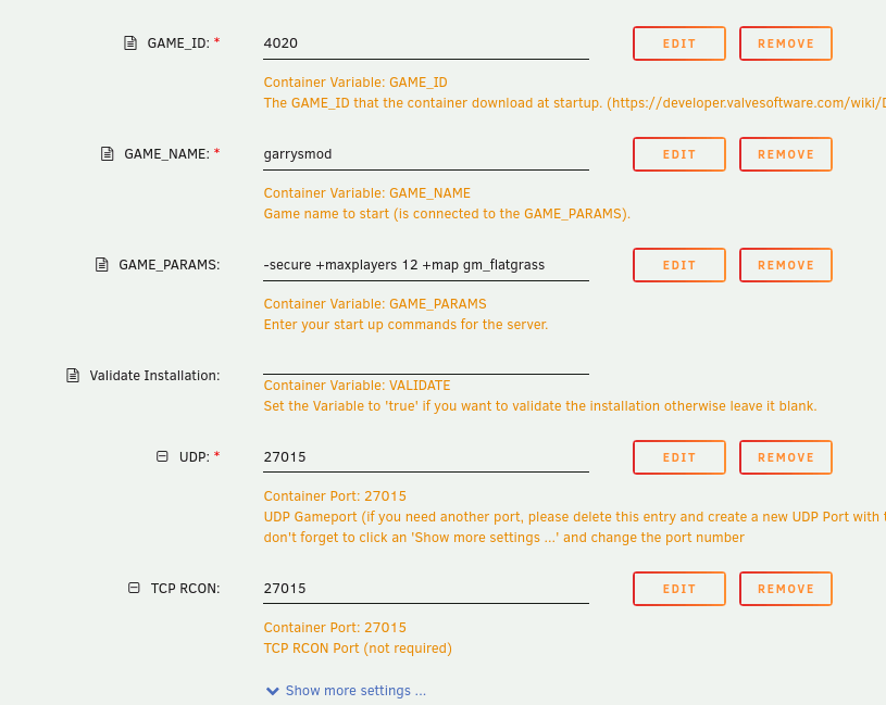

18 hours ago, Zamki said:
No issues over here:
I just saw that you are using a 3rd Gen Intel Core CPU, it could be the case that this CPU is too old to run and missing instructions that the game can run properly but I'm not to sure about that.
Can u send me the Params that u are using to start the Server ?
The thing is that i can run ur Palworld server fine, i had no problems with that.

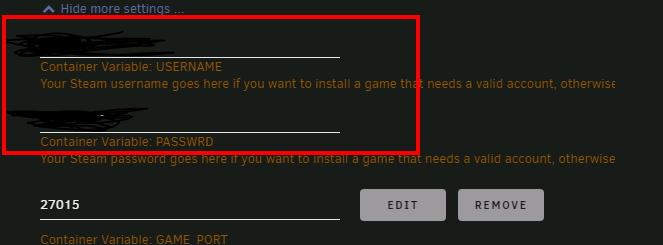

image.png.b8cda297883372fd677a761fcb2844c0.pngimage.png.4089a3311c69e571db196bcd1cd16e88.png

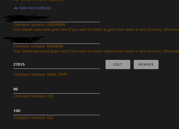

The default ones, I didn't change a single line in the default template.
Please remove your Steam credentials! The Steam credentials are only needed if they are marked as required with the red asterisk and not hidden away under the Show more settings...!
Please don't say that you entered Steam credentials for Palworld... Again, they are only needed if they are marked with the red asterisk and not hidden away.
EDIT:
EDIT:
i Just entered them a few seconds before making the picture
Edited by Zamki
