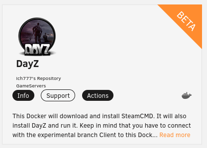

11 minutes ago, Neldonado said:
With DayZ 1.24 officially supporting Linux , will we see official standalone game server support on unraid now?
I don't understand, it's already there:
This is the official server, of course the experimental one with App ID: 1042420, because I don't see the other DayZ server already supporting Linux App ID: 223350
But if you want to you can simply change the App ID in the template, this should do the trick if it is already released.
I won't make a new dedicated server because I simply can't take any game server requests with almost 200 apps on the CA App, but you can let me know if it is working by changing the App ID.

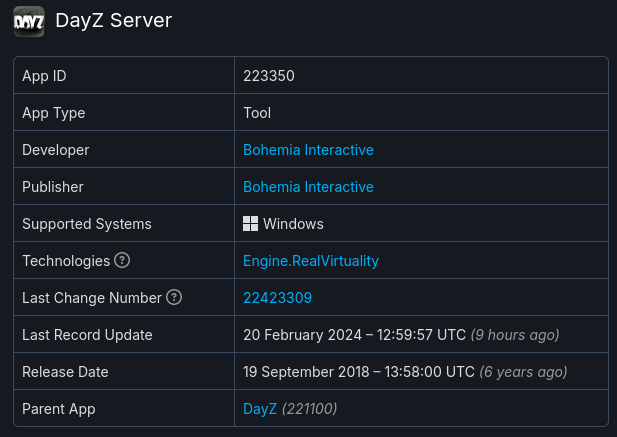

7 hours ago, Neldonado said:
So switching the app ID didn’t do it
I don't understand, did you try this on an already installed container? If yes, that won't work.
but it looks like there’s official progress being made here: https://community.bistudio.com/wiki/DayZ:Hosting_a_Linux_Server

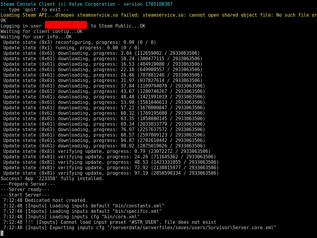

According to that guide it is only a matter of changing the App ID:
Stable branch:
~/servers/steamcmd/steamcmd.sh +force_install_dir ~/servers/dayz-server/ +login your_login +app_update 223350 +quit
Experimental branch:
~/servers/steamcmd/steamcmd.sh +force_install_dir ~/servers/dayz-server/ +login your_login +app_update 1042420 +quit
...and that's exactly what my container does.
EDIT: I just tried it out of curiosity. However it seems now that you have to log in for whatever reason to get the stable branch version which is really a dumb move in my opinion:
However I would recommend that you create a second Steam Account for that purposes (this is also the recommended way from Steam) buy a really cheap game in that account, disable Steam Guard entirely and use a very strong password for that account.
After you did that you can then use that second account for the container.
As you can see above it is running fine. :)
EDIT2: Anyways, I don't know if I'll change the template, maybe I deprecate the container since this is rather complicated with a dedicated account and I would encourage no one to use his primary steam account without steam guard.

I deleted the container, made sure all previous files were deleted and I created a new container with the DayZ server app ID: 223350. Was I correct up to this point? Where would I go to put my login information? I already have a Steam burner account for this specific process.
Edited by Neldonado
Show more... in the template.

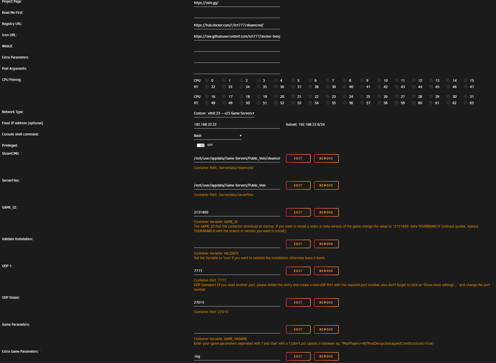

Hey everyone,
I have been using VEIN on and off. but last 6 months i have not used it and now when i do i get errors. I am going to guess it something I am missing but would be nice to confirm if it just me or if others have the problem.
I have deleted the docker and also deleted the downloaded files and configs (I wasn't worried about saves)
I have looked on the VEIN discord to see if anyone else had the issue. (looking seems only 2 other people used unraid but one left and the other has not posted in a while and using search i couldn't see anyone else with the problem)
When starting the docker it downloads everything fine from what i can tell but on game start up or restart i get this error (I do not know how to make the logs go back more) i did remove the restart=unless-stopped to stop the looping and gte the last error.
Spoiler
Fatal error: [File:.\Runtime/CoreUObject/Private/Serialization/AsyncLoading.cpp] [Line: 3477]
Could not find SuperStruct StressCondition to create C_Stress_C
Signal 11 caught.
Malloc Size=262146 LargeMemoryPoolOffset=262162
/opt/scripts/start-server.sh: line 65:    78 Segmentation fault      ${SERVER_DIR}/Vein/Binaries/Linux/VeinServer ${GAME_PARAMS}
