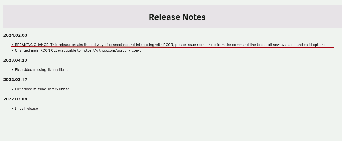

On 2/9/2024 at 11:46 AM, ich777 said:
Please read the Release notes:
It was necessary to change the rcon binary to a different one that actually is up to date and is working.
The new command line usage will show something like:
rcon -a YOURIP:PORT -p PASSWORD command
(Please note that if you command consists of multiple words you have to wrap it in double quotes)
The description from the plugin will update after you restart your Unraid server.

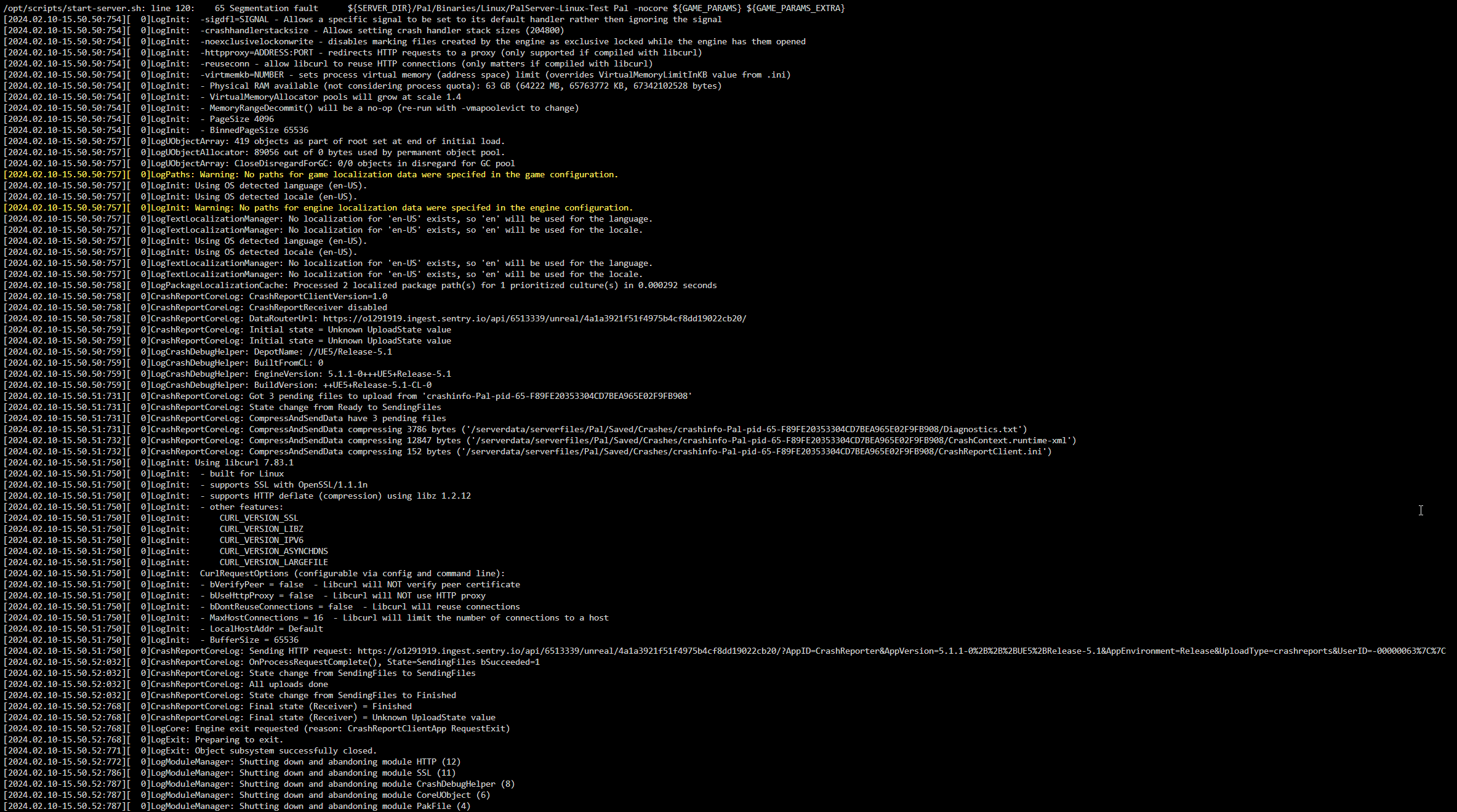

Since updating my palworld container earlier this week the server won't start with my save files. It just crashes and keeps trying to start. I have tried a clean removal of the docker and re-installation and I am able to start a new save file without issue. If i try adding back in my save file I get this and it just repeatedly cycles through this.

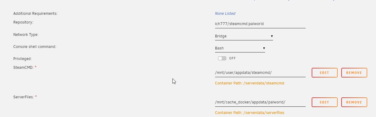

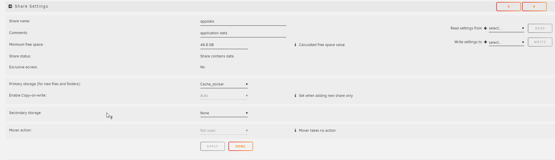

From the post you linked it looked like the concern was the mover had taken files from the cache to the array. I double checked the settings for the cache my dockers run on and the mover isn't setup.
Additionally i checked the docker paths and tried them with user and with the cache name.

Are you sure that the paths are correct for your specific configuration? Does your appdata share stay on the Cache or is it moved to the Array?

Here are my paths, seems default to me:
/serverdata/steamcmd -> /mnt/user/appdata/steamcmd
/serverdata/serverfiles -> /mnt/cache/appdata/palworld
And is this suitable for your setup?
Is the data in the appdata share staying on the Cache or is it moved to the Array (you configure this in your Share settings).
If it is moved to the Array then you have to change the path to /mnt/user/appdata/...
