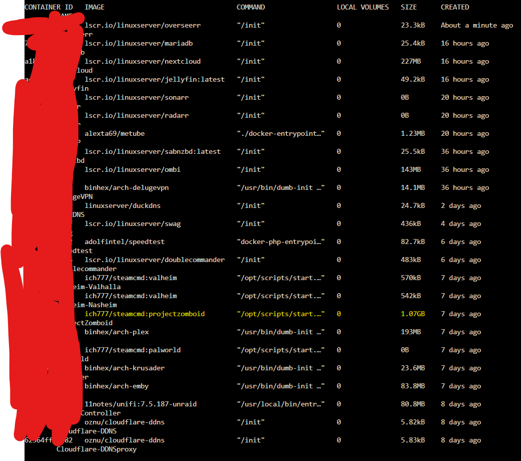

3 minutes ago, suchamoneypit said:
Hey, for some reason Project Zomboid specifically is taking up a significantly larger size of my docker img file than my other services, I don't think this is proper?
Project Zomboid is a pretty small container usually, maybe something is writing in the image itself, please do a force update on the Docker page and see if that makes a difference but before doing that please check if your docker mounts are correct in the template.
thank you, that did take it from 1.07GB to 6.04kB. Will keep and eye on it and see if it climbs in size again.
Maybe it is writing something in the /tmp directory or somewhere else... Really can't tell for sure, you are the first reporting this issue.
