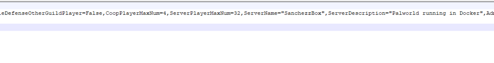

Just now, ich777 said:
How do you know? What other settings did you change?
i changed BaseCampWorkerMaxNum=25 from a standard 15 which was the easiest way for me to tell if it works
  • Replies 12.6k
  • Views 2.4m
And are you sure that this is a valid amount? What about the server name or the password do these settings apply?
the amount is valid. i changed the servers name in the file but it doesnt take effect,

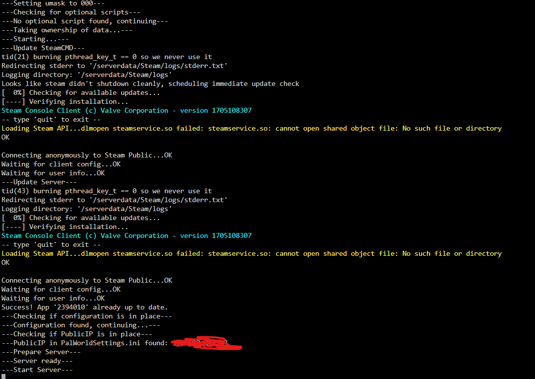

Are you also sure that the config file doesn't exist two times on your Unraid machine one time on the Cache and one time on the Array? <- You have to physically go to the cache path on your server and look if there is also a file that maybe looks different, it would not be the first time that I would see that...
I assume your appdata share is set to use the Cache but primary is the Array correct?
What do the logs say?
2 minutes ago, Psyonicar said:
i do not use a cache,
i took out the savegame files from  my folders and restarted and all things were gone, so i think i am in the right folders
The IP in the file is consistant with the IP iam acutally using so that part is correctimage.thumb.png.8b0066b5c42f233c7495c18c80cc1e09.png
Edited by Psyonicar
Please look on disk1 and disk2 if there are two config files.
I would strongly recommend do only use one disk for that specific share since it makes troubleshooting so hard and it just can be something like that?
Did you maybe change the format from the config ini? I just tried it (again) and changing the Servername/Password/AdminPassword is working just fine, sorry I don't have more time to play and test in game since if these settings stick the others will usually too.

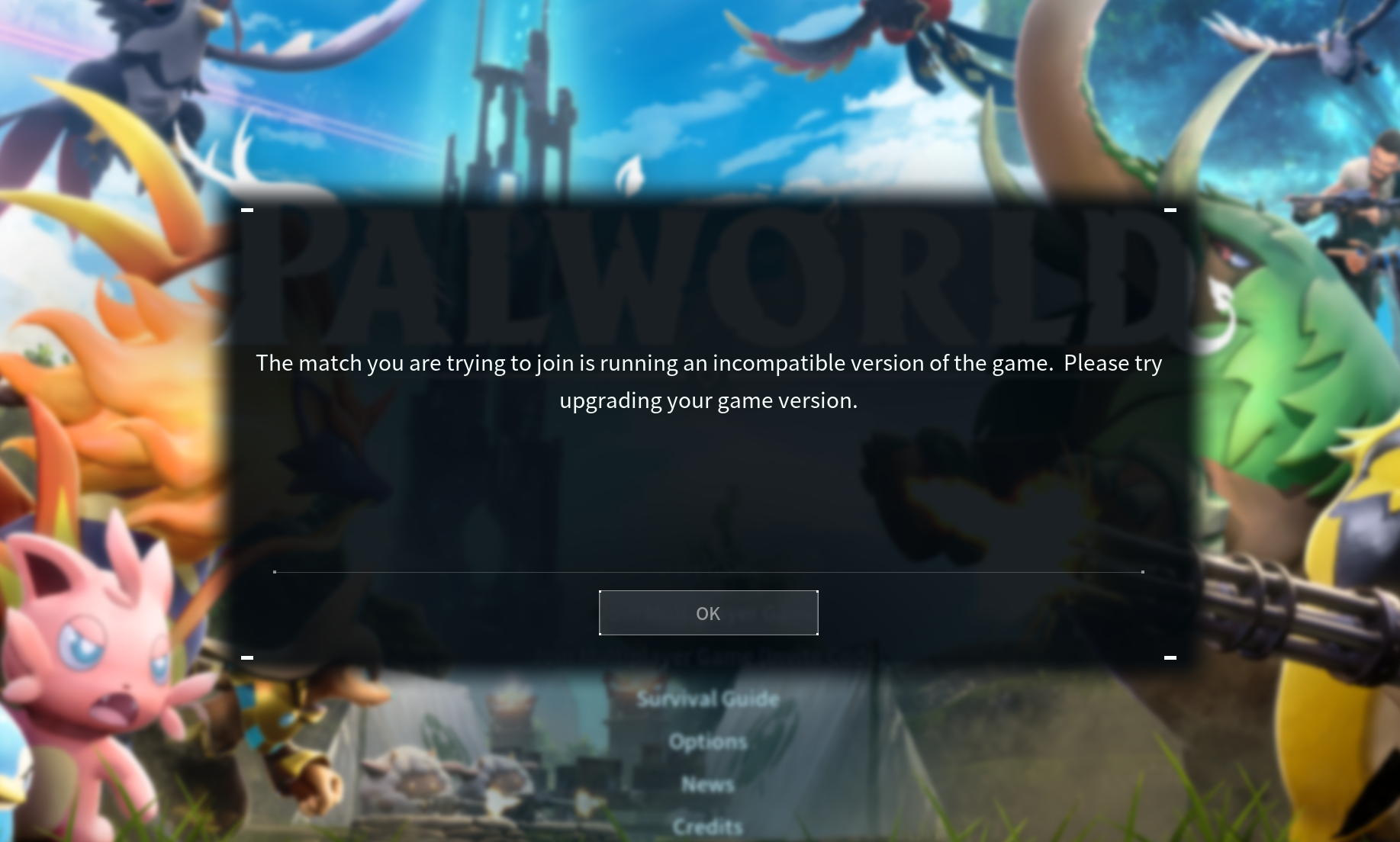

I don't think this has been reported yet but ich777's Palworld container is no longer compatible w/ the current version of Palworld. It looks like Palworld pushed an update 6 days ago to v0.1.4.1 that breaks compatibility w/ older sever versions. I am running stock (unmodded) ich777 Palworld container which seems to have been last updated 18 days ago (Jan 25th).image.thumb.png.d063458f5c375cef39edd014edab62f4.png
Is that the container itself when he added the backup feature?  Bc I updated to 0.1.4.1 and my server is running fine & I have avg of 10 players. One of them will let me know when it needs a restart or update. No issues thus far.
There were some people having an issue updating and a solution was metioned with in the last few pages of this thread.
Something about stopping the container, deleting all folders/files in the appdata/palworld, except the Pal folder and restarting the container to get a fresh download of the server files.
Also if the cobtainer is on the array instead of cache, that will cause issues if it its on multiple disks.
The containers rarely need updating for game servers unless they are edited and re composed.
Edited by Spectral Force
Have you restarted the docker in order to push an update to the server?
I really don‘t understand, my container checks for updates on every start from the dedicated server itself. Most of my containers are self maintaining and need to be updated very rarely itself since they pull imupdates on their own.
If it doesn‘t pull the latest update automatically because of some AdBlocking or other related issue on your system please stop the container, delete everything from the palworld directory except for the „Pal“ directory and start the container afterwards.
This post is almost the same as @Spectral Force‘s post because he is simply correct in everything he says in his post.
Thank you for yours and @Spectral Force's the very quick responses. After restarting the container everything seems to be working. I now also have a better understanding of how the game server containers work. Thank you.

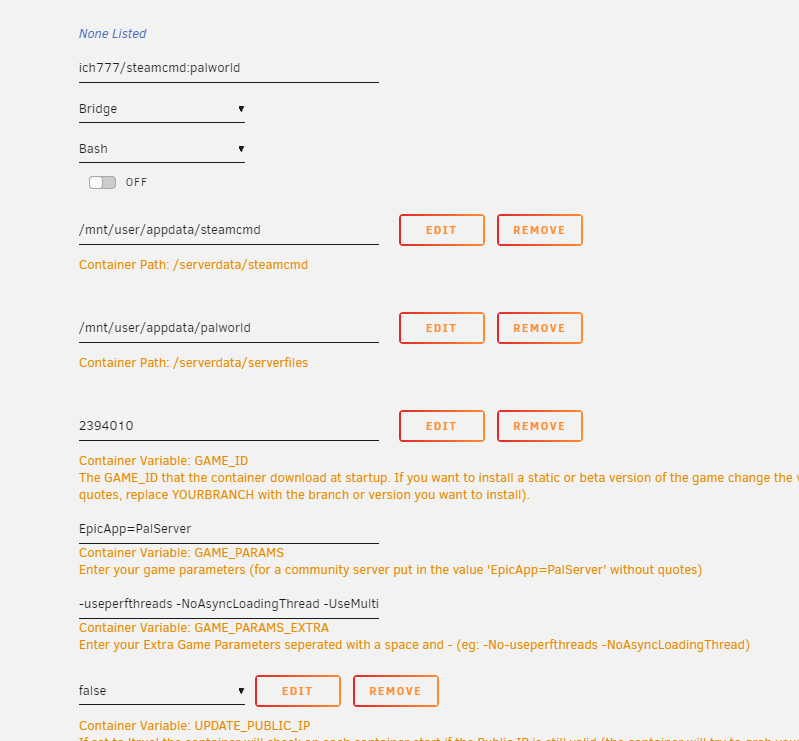

A bit confused setting up the palworld image. I stopped the docker image, set the port to 111 for the udp1 port for the image and in my router's ip forward setting. Made sure the PalWorldSettings.ini in the docker image has the same port and ip as my router rule. Network type is bridged. I can ping the ip address for the server but can't connect. Is there a network setting I'm missing?
Please look at this post:

On 2/12/2024 at 4:58 AM, ich777 said:
This is your issue.
  1. Stop the container
  2. Edit the configuration file
  3. Start the container
If you are editing the file when the container is running and simply restart the container then you changes will be discarded.
Many thanks, the issue has been resolved!
