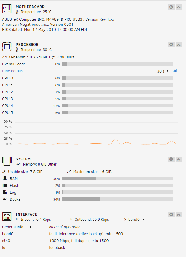

Thank you for the reply, stopping the docker did allow me to get the logs, I changed the public ip to xxx.xxx.xxx.xxx just so its not seen.
as for steam credentials i never filled those fields in, they were left default blank
i also attached an image of the machine this is running on

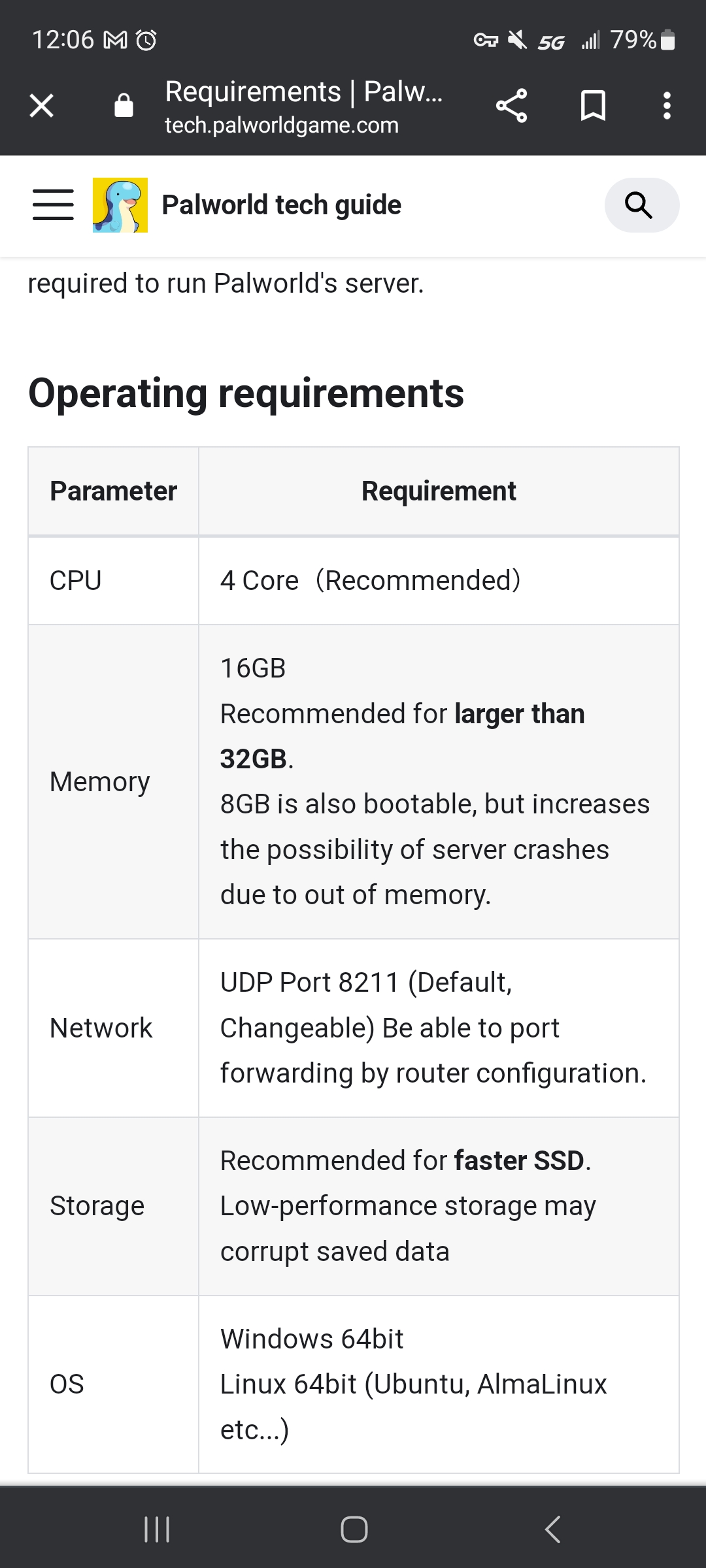

Sorry but you CPU is not supported by the dedicated server because it lacks features which are needed so the dedicated server can be executed/started.
As a side note, this dedicated server is really RAM hungry, you won't be happy with 16GiB, my server with three people on it looks like this:
I have seen RAM usage spiking up to 40GB at times with many people on it.

Your system is in need of an upgrade if you want to start hosting servers for modern games. Your cpu is about to be 10 years old in April.
bummer, was hoping it was something id be able to fix easily, thanks for the help though!
