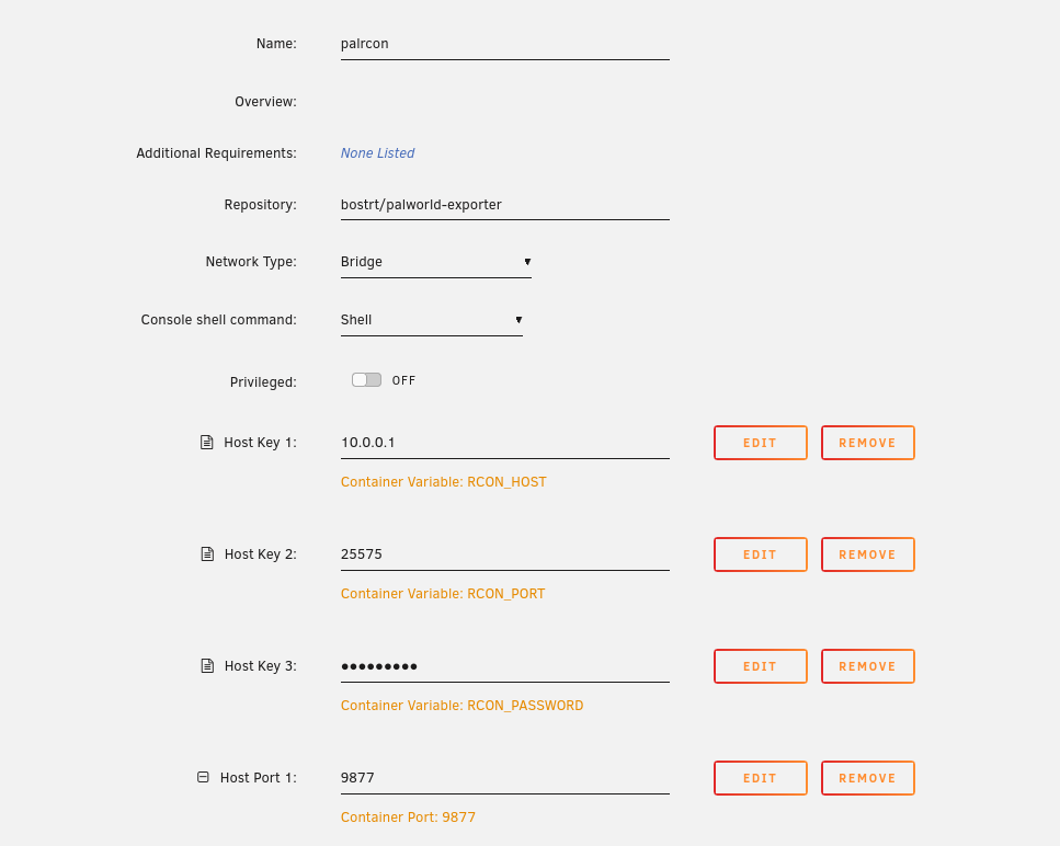

connecting this https://github.com/palworldlol/palworld-exporter to server RCON
7 hours ago, ich777 said:
And are you sure that RCON is working and enabled correctly? Have you yet tried to connect through RCON through my plugin from the command line?
Working absolutely fine

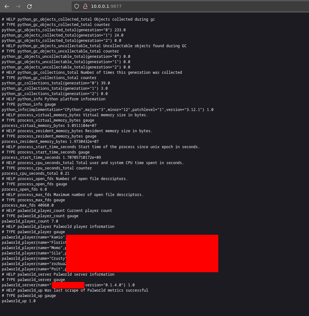

1 minute ago, ich777 said:
I just now tried it and it is working flawlessly over here...
wow really ???
could you please tell me how you managed to install it and run it ??
pls @ich777 i spent 6 hours straight trying my head gonna blow up, you got it up and running in no time
It shows me this but I am sure i installed it wrong way maybe:
20 minutes ago, Kesra said:
wow really ???
Yes, why not...
And here is the exporter data:
4 minutes ago, ich777 said:
Yes, why not...
I really dont understand why its doing this I copied your way exact
I really don't know your setup but I'm pretty sure I don't have a listen port variable in there...
I fixed instead of LISTEN_PORT to Container port, working fine now thanks @ich777
