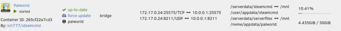

Hi I'm facing an issue by connecting to my Palword server remotely
Connection type : Bridge
8211 UDP open and pointing to the server local ip
27015 TCP/UDP open and pointing to the server's local ip ( Reddit comment suggestion )
I can connect locally with a password
but my friend is getting a "Connection Timed Out" Message when he tries to connect to my public ip.
Modem restarted .. router restarted .. container restarted  .... didn't work !!!
My ISP is fine I can access other dockers via SWAG so this Palworld Server should be less complicated.
Edited by Thamer Alfuraiji

Ok let's agree on these facts :
1- I'm not a beginner with Unraid / Reverse Proxy / Port forwarding / Basics and differences between local and public IPs and domains.
2- yes he is connecting via my public IP and port 8211 the loading screen starts for 10-15sec then we get the message in the attached screenshot
3- yes the port 8211 is open and only UDP .
4- I know about your seggestion of using my domain instead my public ip and that's the plan after I make sure that actually the public ip access is working which for now is not working ..
5- I have attached some screenshots to confirm and to give more details.
6- Yes the Palworld Server is working locally on my other gaming PCs via 192.168.1.181:8211
7- I removed the port forwarding of steam port from my router.
more details for number 2

1 minute ago, Miykael13 said:
Thanks for that tip! Here are the logs
On what hardware do you try to run the server?
AMD Ryzen 5 5600X 6-Core @ 3700 MHz
32 GiB DDR4
Hmmm, have you changed anything in the config? If yes, what did you change? It did run correct?
Can you post screenshots from your Docker template?
Are you sure that your appdata share stays on the cache if you are using /mnt/cache/appdata/...?
