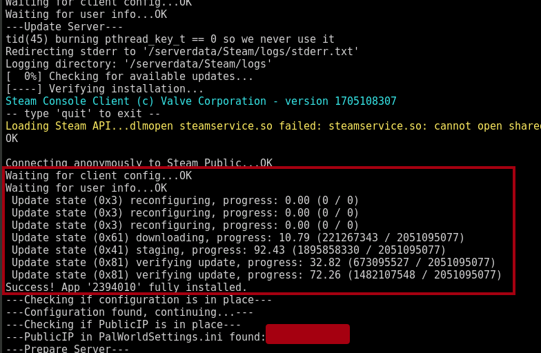

5 hours ago, ich777 said:
I just restarted my container about an hour ago and it was picking up the update just fine (you have to restart the container so that it pulls the update since it checks on every start from the container for new updates through steamcmd) :
Welcome to Pal Server[v0.1.3.0]
It will also tell you that in the log:
