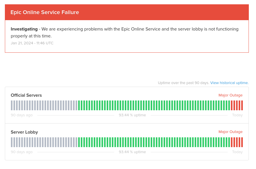

Has anyone managed to get their Palworld server to appear in the community server list? Mine is up, and people can connect and everything, but I'm not sure how to get it to be listed in the game...
You should look into the server status fist, they are experiencing massive problems currently:
