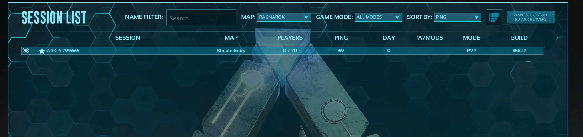

I just installed ark on my unraid server and when I put the ports and server name and map in nothing changes when the server starts up. Please Help
Edited by xxJTownxx33
A bit more information would be nice.
Where did you change the server name and map? In the Docker template or in the config?

Hello, I downloaded the docker installer. I check the logs and it shows the server is running. I cannot connect to it for the life of me. I have tried forwarding the port 8211. That did nothing. I am using unraid 6.12.6. Please help if possible.
