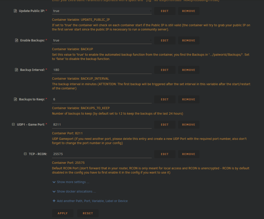

I can't seem to get my Palworld docker to work correctly.
I get it setup where it shows up on the community server list but it does not allow me to connect from the community server list. I can not connect via the public ip:8211 the only connection I get is via local Ip for the container (192.168.1.05:8211).
I have deleted the directories and freshly installed them. I changed the "PalworldSettings" and set "bIsMultiplay=True" and changed the server name and password.
I have changed the Port in my port settings, server settings etc. My port settings set to my local Unraid device's Ip (192.168.1.10) which is running the docker on a container (192.168.1.05:8211).
Attached is my docker settings, my router port fowarding settings, the message I get when i try to join via community servers, and the Server config file.
Any help is greatly appreciated. Thank you :)

this is an issue i had a while back... i changed Privilebed to On and mine worked immediately

I was having the same issues. Previously I had been running my server off of my PC with Steam's "Palworld Dedicated Server" tool. I ended up fixing the issue by going into my router's port forwarding settings for 8211 and changing the device IP from my PC's local IP to my unraid server's local IP. Now I can connect to the palworld docker server with both the public IP & through the community server browser.

This is actually the worst idea, don't add privileged, you basically now allow the container to have access to your whole server and not much isolation going on.
Don't worry I didn't, it also wouldn't fix my problem.
