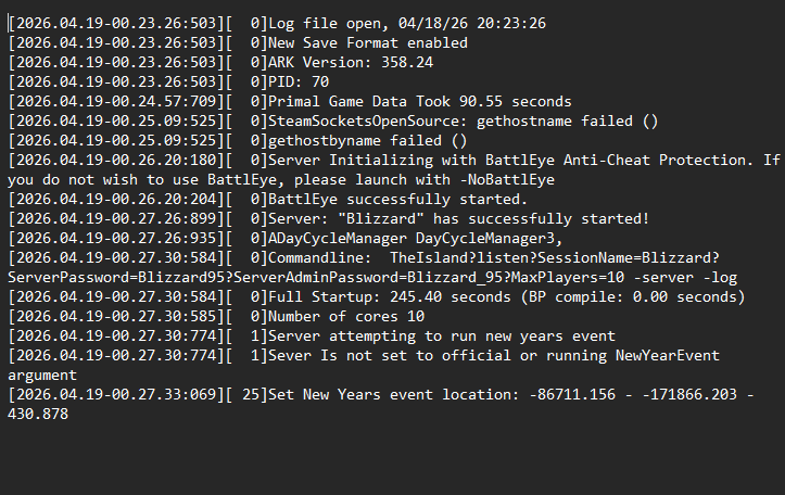

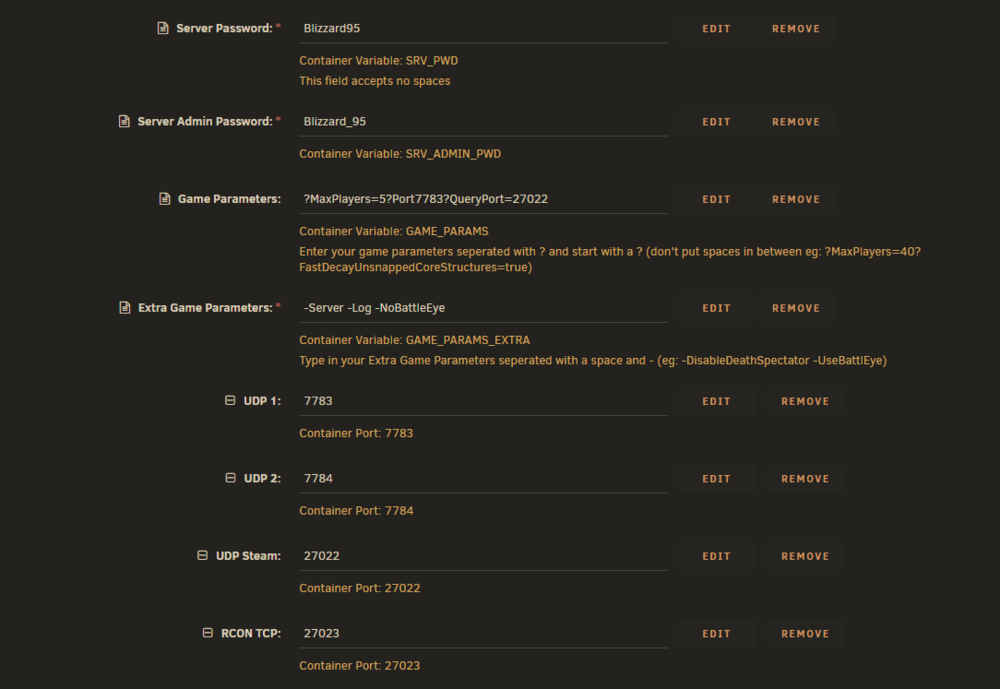

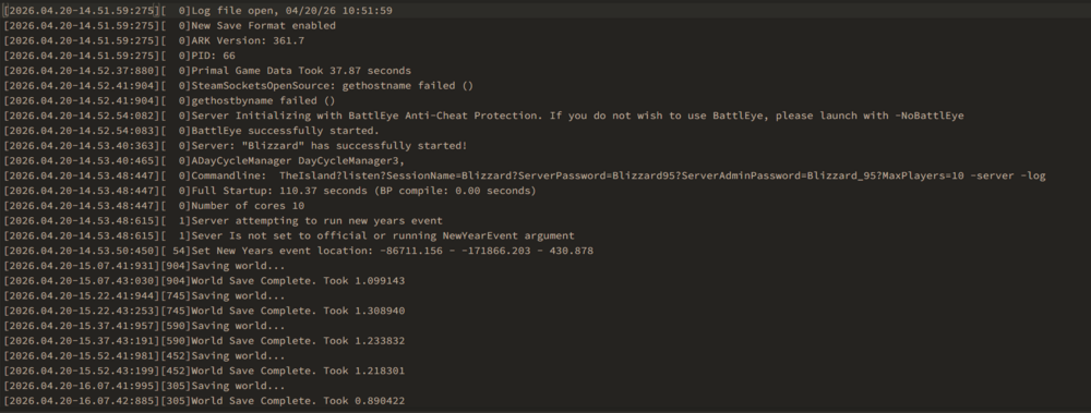

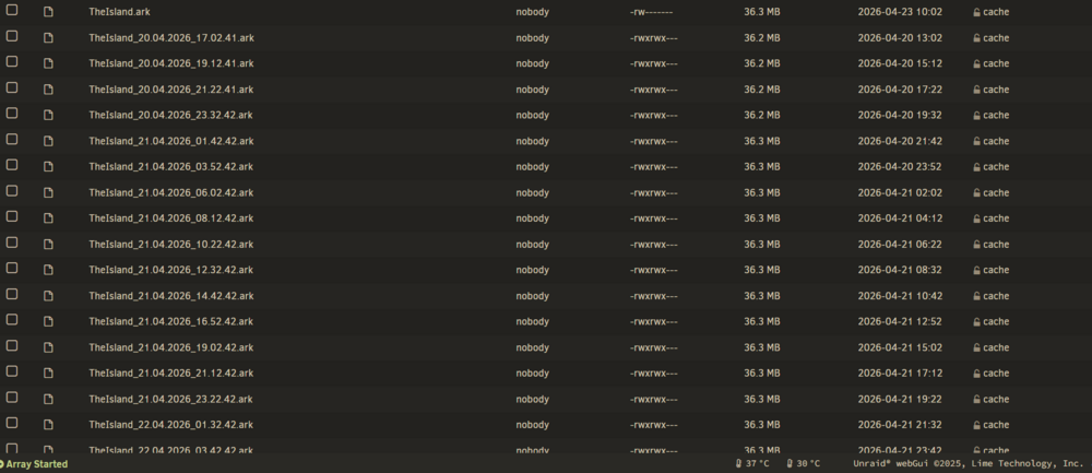

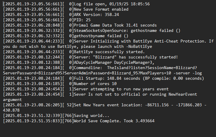

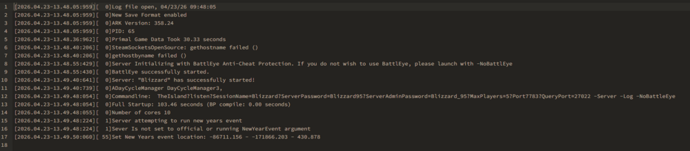

Good Morning yall,
Me and my significant other decided to boot up the unraid server that I had going all 2024 to the end of January 2025. Its been offline since then. I've probably spent about a month getting it back online. Updated all the dockers and the OS. I also run windows 11 on my pc now. Its been a lot of trouble shooting, late nights and early mornings before work. I have two main servers that I was running, Satisfactory and Arkse. Now I know that you cant get ich777 Arkse container anymore. I pretty much rebuilt the container. The originals containers stopped working after I updated them, big mistake. I was able to dig for the source code under master in ich777 github and link that to the repository. I did the necessary tweaking and I got ark to install Yay!!!. I go to add it in steam servers and I can't find it, uh oh. I reboot it a couple of times. Spend the rest of the past Saturday pulling my hair out. Sunday, I attempted to try ark and leave it on for a longer time, to no avail. I attempted Satisfactory, Same issue. I see it boot, and running, I log in to satisfactory, I add it, and I SEE IT! (PROGRESS) AND I JOIN IT, ............Failed to connect, (Attempted to join 5 more times). A little after that I install 7dtd, I didn't do anything to it really, just left everything default. The server starts successfully, sweet. Go to add the server in steam game servers, IT ADDS...I JOIN IT....AND I CONNECT WooHoo (PROGRESS!) I do the same for Icarus, same results, then I do a fresh install of Satisfactory, same results. I do a fresh install of ARKse, still can't find it or join it. I plan on testing Factoria and Rust since I have them installed andI played them for about a month each back in 2024. Now, I noticed one thing in all of this, the install path is /mnt/cache/appdata/(game Server im installing). If I restart unraid, that cache goes poof. I didn't know that, but it didn't bother me, because I set all my servers up back in 2024 to install in a different folder under /mnt/user/GameServers/(game Server im installing), and I only used a VPN to join such games and manage the servers. I still use the VPN (Wire Guard) and still do not have issues. I believe that I need to do a fresh install off Unraid, since its been a hot minute and that if I use my old install path to GameServers, several either do not boot or infinite boot loop (Icarus), but I wanted to know if anyone had the same issue and has a fix for it. I have done new perms and fixed SMB. I had to fix the SMB to check some of the old Ark logs and compare them to new ones, which I will provide. There are two different Ark Server I created, the old save that has the older version that will start, but cant update and the new version that starts and checks if it updates, It will not update the recent update 361.8, regardless I should be able to see them and join them. Oh and one more thing, I have verified that I can join externally (with VPN) and internally in the network. Could be a port that isn't working , but I have swap the ports around a lot, there are a few that are the same, but one server up while the other is down. I double check the ports before I bring up the servers and I can run 3 or more at once and connect to all of them at once with different steam accounts (Family Members). Thank you for reading the past 3 days of hell for trouble shooting, I will try to respond as fast as possible, but I am quite busy during the week. Thank you to all who help me trouble shoot this, my worst fear is that the devs just royal screwed ark.
Thank you
Bliz

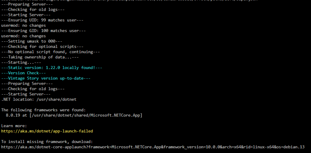

Hello,
The new update of Vintage Story (1.22.0) needs DotNet 10.0, is it possible to update the container ?
Vintage Story
1.22.0 - Fishing, Mechanisms, Metalworking and More!
Dear Extraordinary Survivalists v1.22.0, a stable release, can now be downloaded through the account manager. Well, here we are again. Another update is ready for everyone's enjoyment. We recommend ev
Done, please update the container itself.

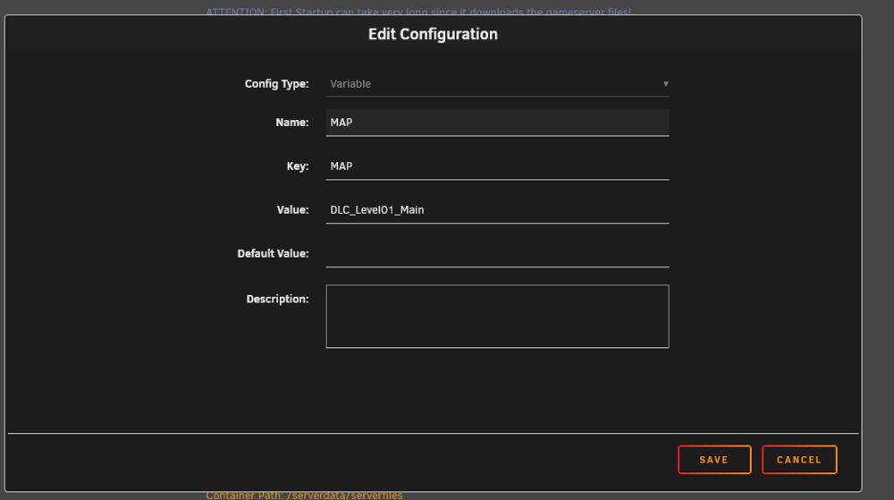

If you create a new variable can configure it for the new map there, it should work. Leave the Start Up Parameters without the map name. Here's a screenshot of what I did.
Now, I still haven't been able to get characters to transfer between my clustered servers. We go to the portal on the island and don't see the other server in the cluster. The log files say they are connected, and I'm using the same ports (and even mapped the ports in the container config for the main server). I'll be interested in your experience once you get this to work.
