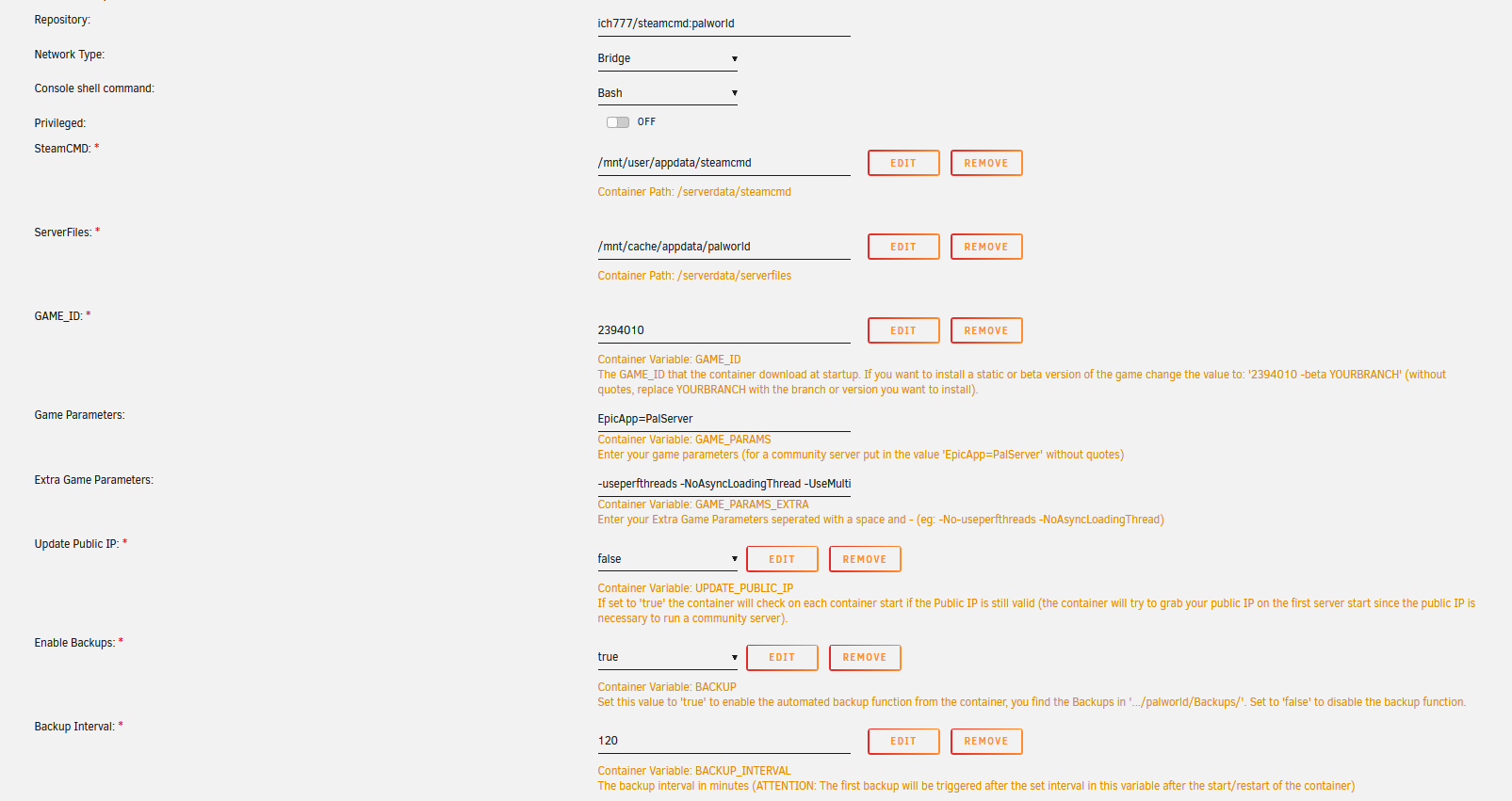

Can you post screenshots from your Docker template?
Are you sure that your appdata share stays on the cache if you are using /mnt/cache/appdata/...?

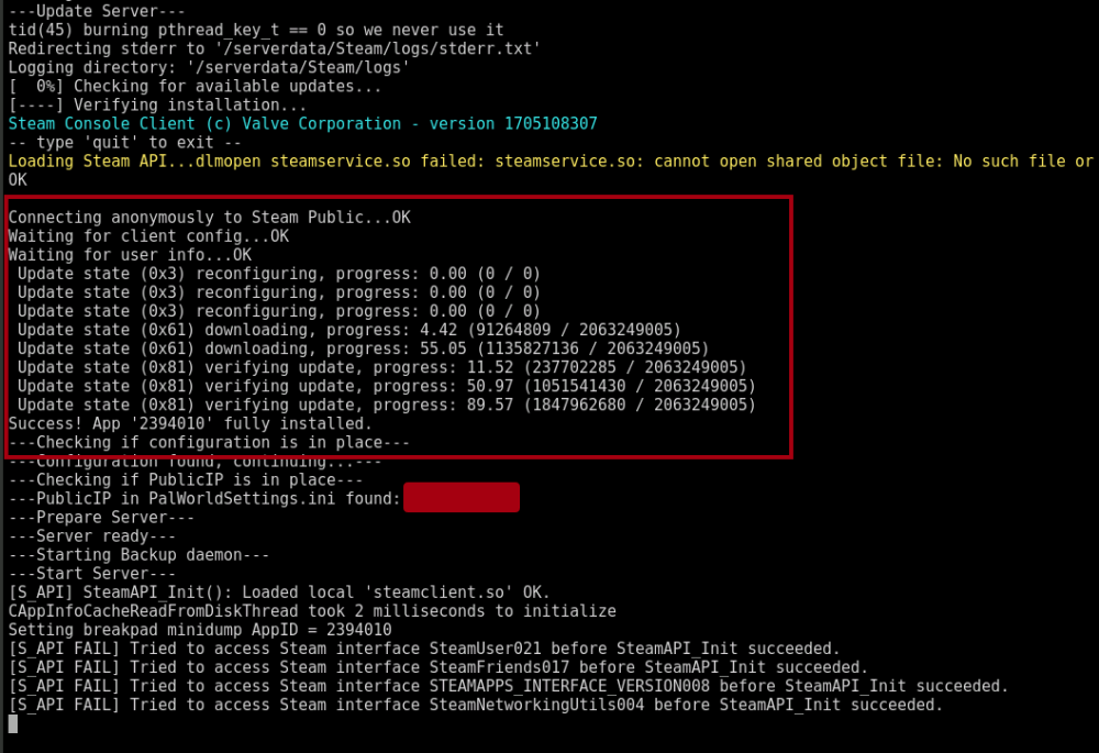

I do have my cache moving to my array. Still new to unraid so im guessing thats poor practice.
Palworld config is entirely default other than I enabled backups. image.thumb.png.46a43da09d928c96c1919a094b8e9393.png

And exactly that is the issue here, you see in the above screenshot that /mnt/cache/appdata/... is specified but you moved that data to the Array, that can't work, please read that post:
Thanks for the help! So, leaving on the cache and not moving to array means that the data for the server is unprotected as far as parity goes, if my understanding is correct?
Edited by Miykael13
Anything on cache is not covered by parity. if you search cimmunity apps for appdata backup you can schedule backs of said directory & save those to the array. This process does shutdoen & restart the containers.
I don't know how you configured your server but I use a BTRFS Cache Pool that consists of two drives so to speak mirrored and that means it is protected.
If you only have one Cache drive then yes, it is unprotected but I would strongly recommend that you put in a second Cache driver so that it's not unprotected and leave the appdata share on the cache, with that you allow that the Array can go to sleep and save some energy.
EDIT: or what @Spectral Force wrote with CA Backup. ;)
