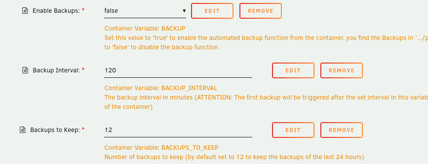

PALWORLD ANNOUNCEMENT
Palworld now supports automatic backups.
If you want to make use of the new feature update the container with the "force update" button on the Docker page (with advanced view enabled) and then create these variables in the template:
  1. Key: BACKUP
    Value: true
    Description: Can be either true or false and will enable or disable the Backup function.
  2. Key: BACKUP_INTERVAL
    Value: 120
    Description: Backup interval in minutes
  3. Key: BACKUPS_TO_KEEP
    Value: 12
    Description: Number of backups to keep
(YOU HAVE TO CREATE ALL THREE VARIABLES OTHERWISE YOU WILL GET ERRORS)
In the template it should look something like that:
Another method would be to delete the existing container (but not the directory for Palworld) and re-pull it from the CA App to get the new Variables, just make sure to write down any custom things you did in the first installed template and transfer that over to the new template.
